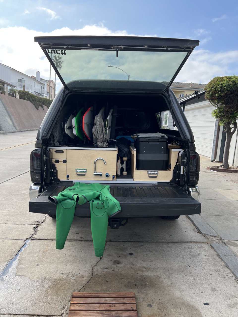

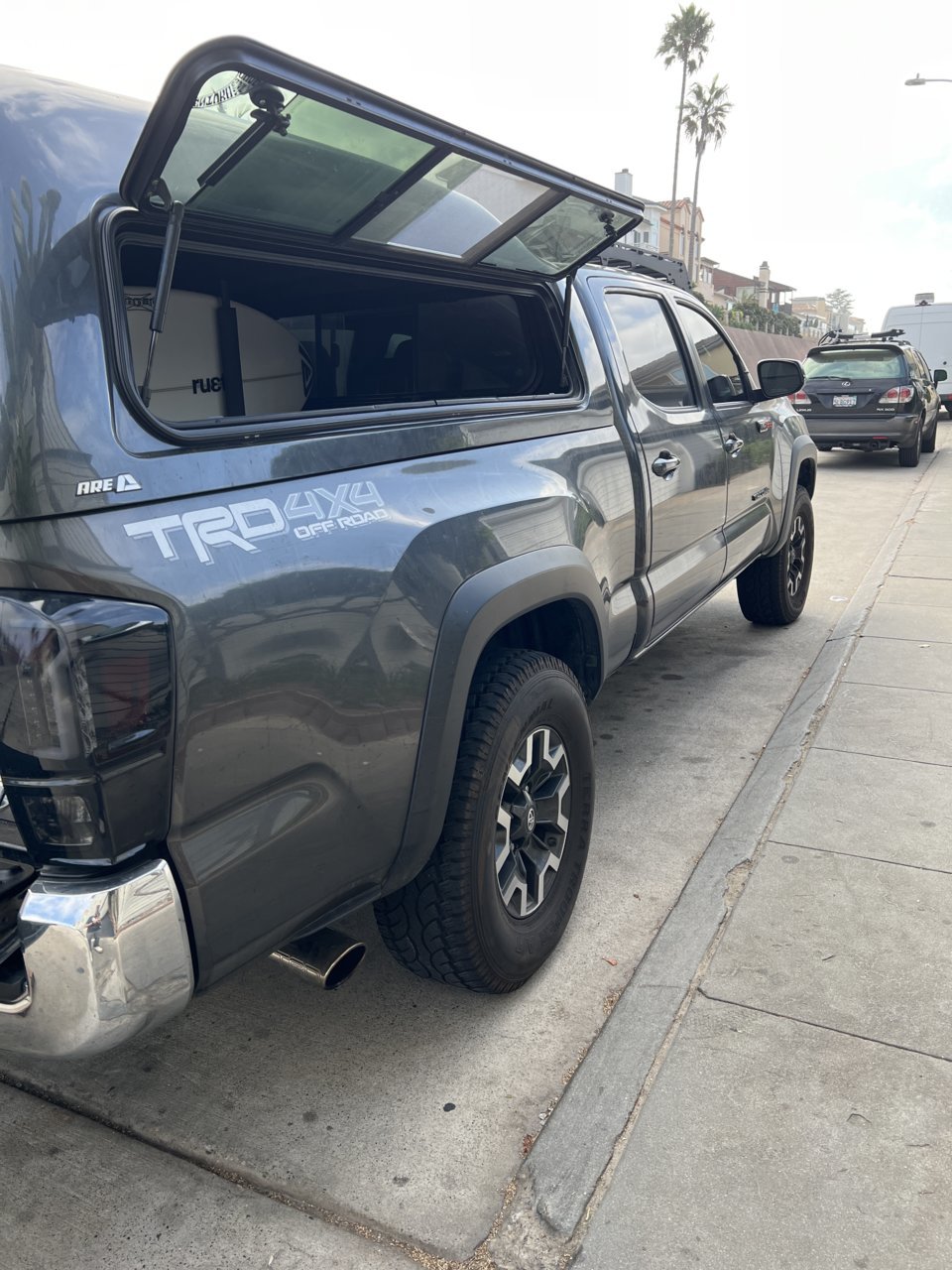

    I’ve got a 2019 OR DCLB I use as a daily driver. I’ve added about 600lbs to the bed with a build out and anticipate another 200 when fully loaded for a trip. It’s down to about 1.5” from bump to frame and I’m looking to get that back to stock height or even a 1.5” overall lift. I’ve been quoted the Icon RXT and the Dakar packs. I’ve got a 1500$ budget to work with. I want to get rid of the trash stock leaf pack. Any input is helpful.
