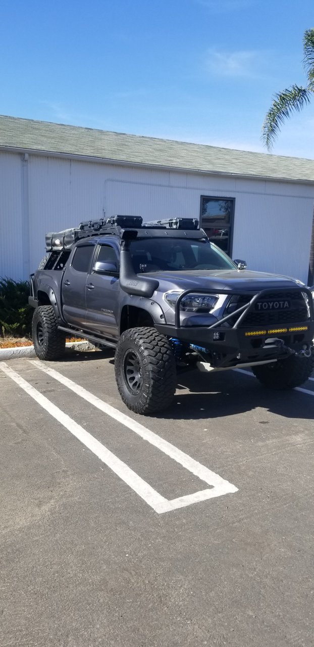

    I'm carrying alot of weight, HC rear with swingout, spare, 2 full jerrys, Bed drawers with a bunch of tools, fridge, bedrack and tent, I bet im close to 1000lbs
