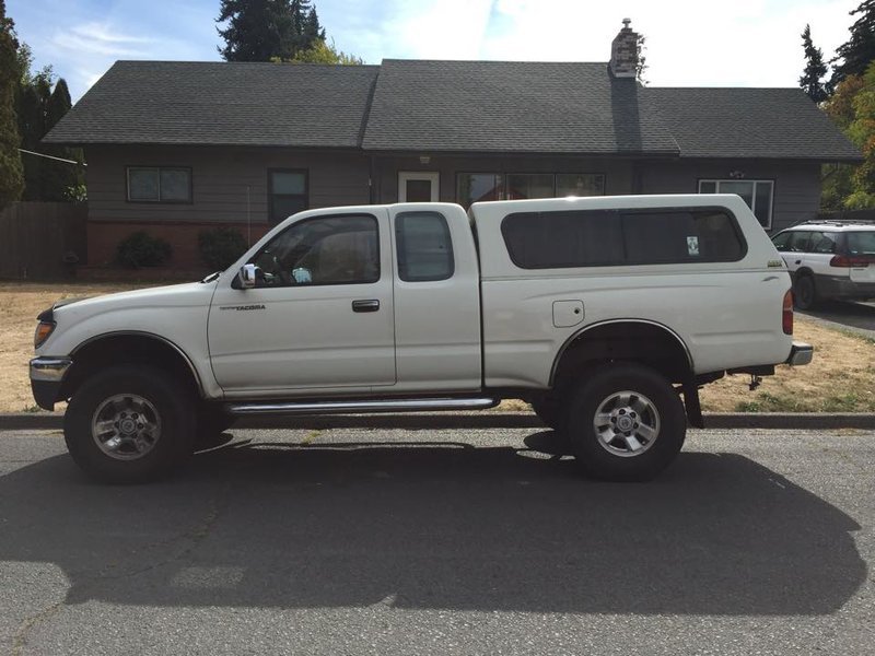

    chrispchicken9
    chrispchicken9 Well-Known Member
    Aug 31, 2018
    #264753
    992
    '04 3.4 tacoma, '16 4.0 4runner
    How much lift are you trying to achieve? dakars will crank your arse up to the sky like this guy, among many other tacoma owners
    Taking lift advice from hardcore overlanders maybe isn't what you should be looking for as a daily driver!
