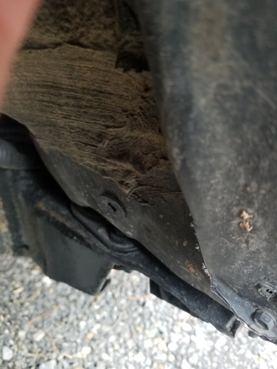

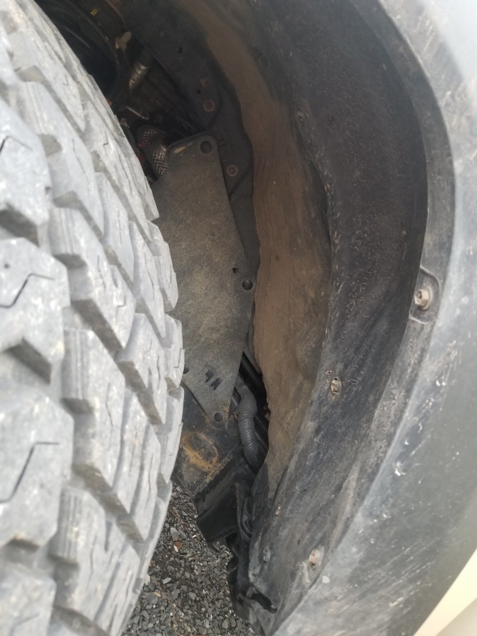

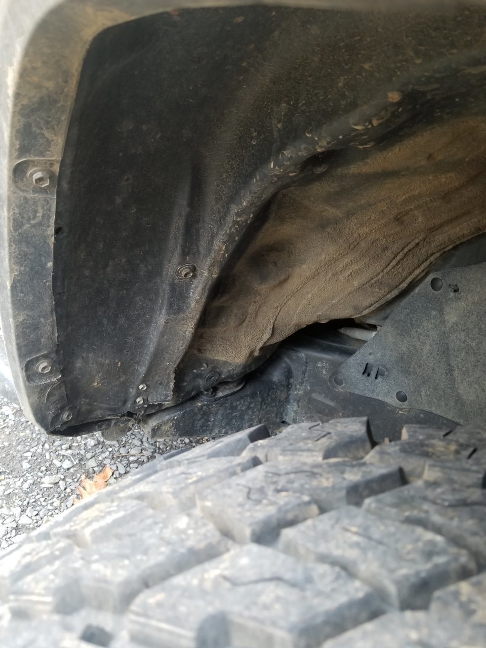

    Do you have any pictures of the CMC/plastic cuts near there? Hoping to mirror your cuts somewhat to keep these dang wheels from rubbing.

    I had to cut more than that man lol.
    I dont even have fender liners anymore.
    3pooches likes this.

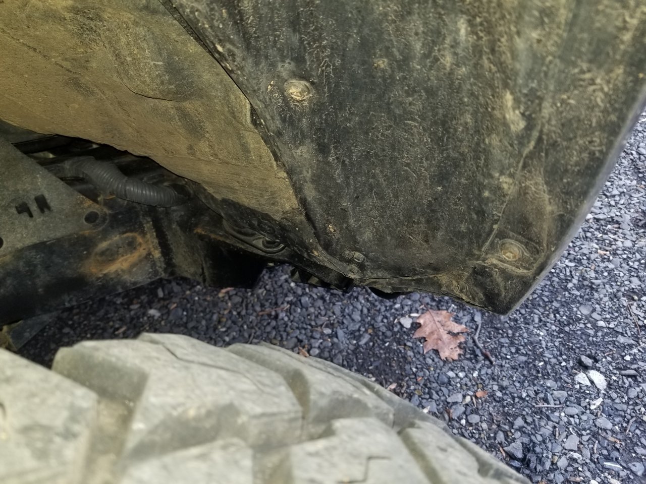

    Yeah it’s not really the fender liner but the sheet metal looking stuff behind it. Do you remember cutting it/have any more recent pics of that area?

    I dont have any pictures on hand, but I'll post some tommorow. I took the liner out, then bent the fold flat, then painted over it.
    Guess where I rub now?
    Front upper fender behind the headlight lol
    03dumdum[QUOTED] likes this.

    Ah that’s a good idea, I was grinding/cutting it but didn’t like leaving a somewhat sharp edge

    You will probably need to flatten the pinch weld, to keep from cutting the tire. It’s ok if you rub the plastic a bit, but if you are making contact with the fender flare you may need to trim the whole fender, which will necessitate you removing the liner.

    Yup, I also recommend if you are going to take out the fender liners, buy some new retaining clips because they will break when you take them out.
    In order to take the liner out, you'll have to take off the flares, then the liners.
