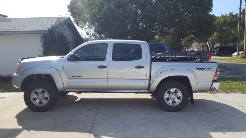

    Installed King RR with compression adjusters, dirt king UCAs and not sure what to do in the rear.
    Looking at Dakars or Icon Progressive AAL, to go with rear King RR. I plan on eventually getting a topper and tow my boat almost daily.
    Will I need the extended kings for Dakars?
    Extended break lines?
    Also if anyone is currently running kings with either dakars or the icon aal, how is the ride? Towing capacity?
    If any knowledgeable TW members could chime in and steer me in the right direction.
    And I have used the search function lol. Just cant find a direct answer to my questions.

    3 leaf AAL won't be enough when you get a shell, particularly when you have a shell and a boat.
    You won't need extended lines for the Dakars, but they're cheap insurance if you offroad.
    Ride with the shell (mine is 220lbs) is excellent, particularly on freeways - smooth as glass. Bumpy roads are.. bumpy, but not jarring.
    Dakars are easily my best and favorite mod.
    I ran the Wheeler's Offroad 3 leaf AAL (same as Icon/ToyTec/etc,.) and it was great without the shell, with the shell I lost most of the lift they provided and they were too soft when I had the shell plus a load in the bed of more than a few hundred pounds. Not even a comparison to a full leaf pack like Dakars!
    If you end up getting the 3 leaf anyway, save the money and get the Wheeler's brand item. They're literally identical, made by the same spring manufacturer to the same specs - only difference is the sticker on them and the price.
    Coolerman likes this.
