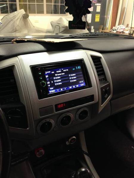

    JVC KW-NSX1 Double Din Head Unit
    PAC SWI-RC Steering Wheel Controls

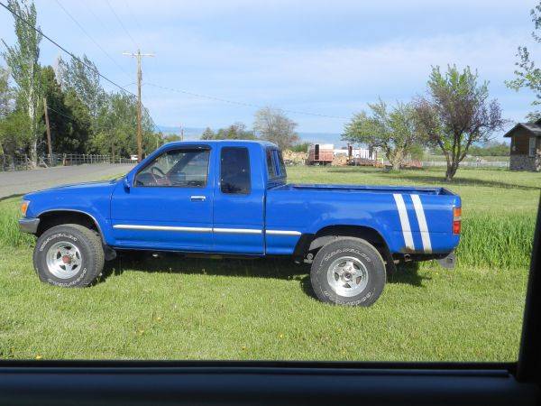

    This isn't my first Toyota truck, my first vehicle was a 1990 Toyota Pickup. Deluxe Package. 4x4. 3.0 aka 3.SLOW V6. 5 speed manual. I bought it like this:
    And turned it into this:
    I learned a lot of things from it. Such as not to never do a dropbracket lift again!! ;)

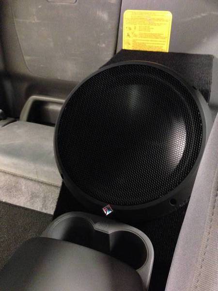

    Then I set to work on the stereo:

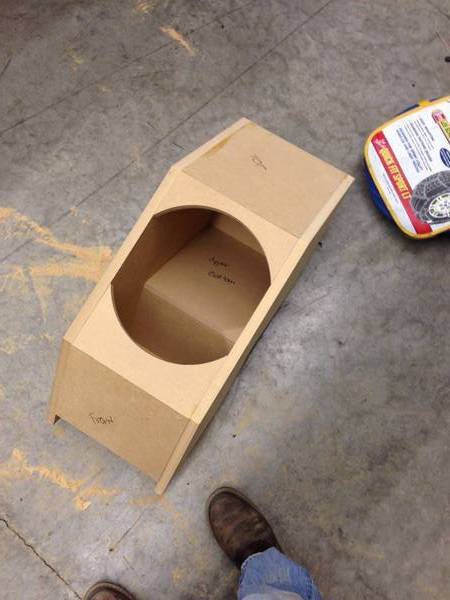

    The sub box took a bit to perfect as I had to have a 12"

    Looks great man! Do you have any specs on the sub box? Also how is the plastidip staying on those wheels?

    Thanks! Yeah I sure do, I'll just have to find them. I actually went off of this thread http://www.tacomaworld.com/forum/audio-video/290766-another-access-cab-sub-box-d.html All I really changed was the ring to fit my sub.

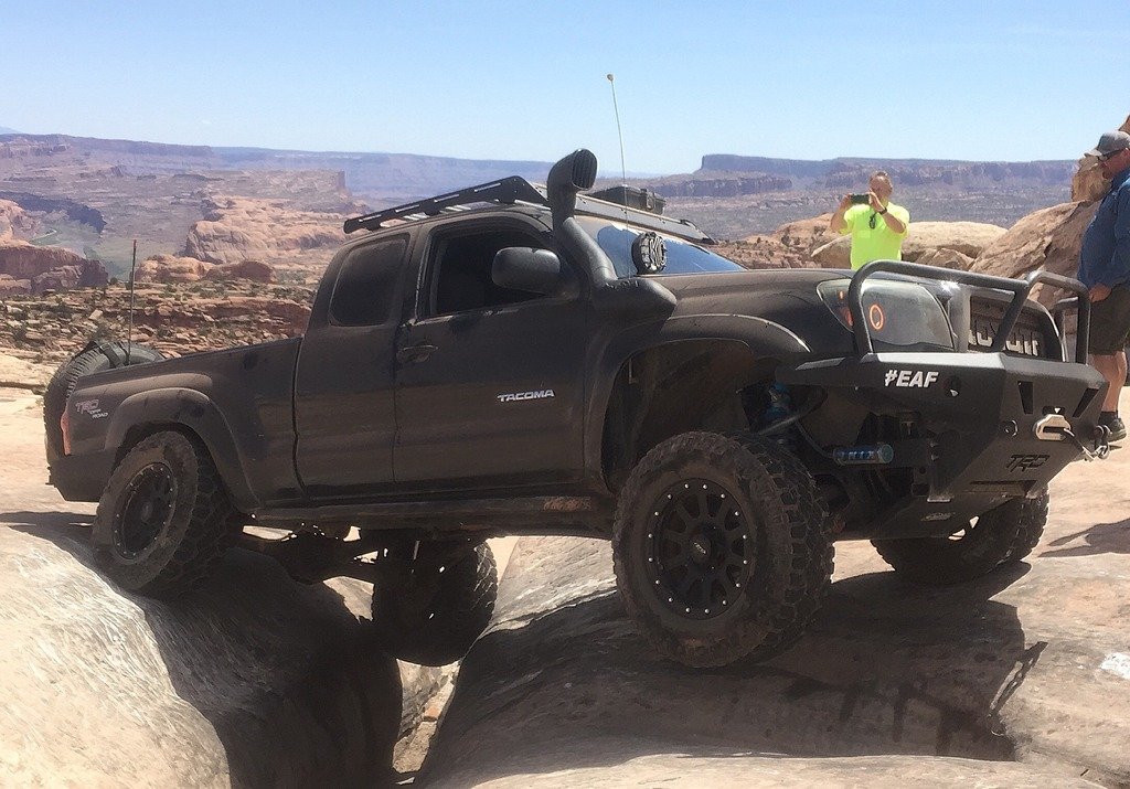

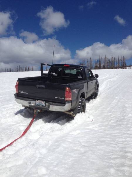

    Went on the first wheelin' trip of the year up to Lion's Rock today and got within 3 miles of it. Too soft of snow in the open meadow area! :mad: Other than that part my new Duratracs and do awesome in the snow! Having the locker anytime mod on the lower trails was a huge asset as well. My buddy got his MTR's that morning and I'm super jealous :rolleyes:
    Sexy and flexy :cool:

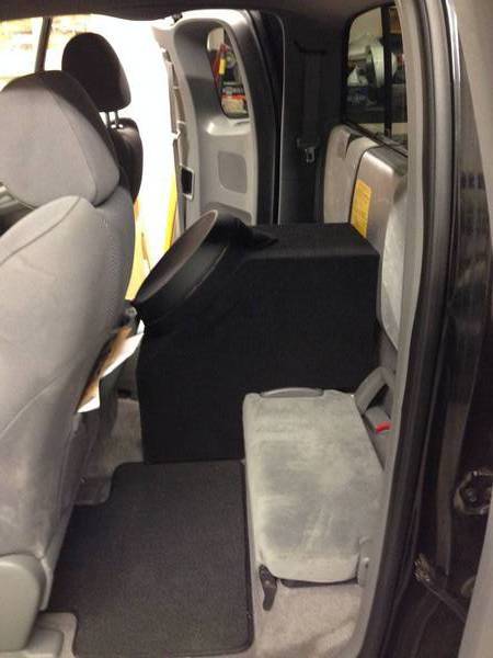

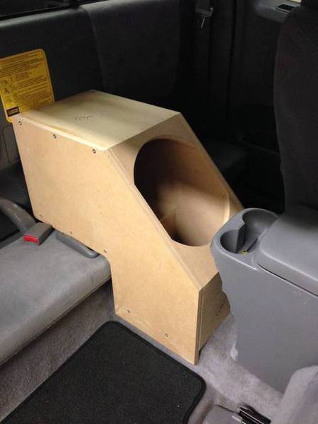

    What do you think of the single 12" sub in there? I have an access cab and am hoping that a single 12 will in that tight space will hit pretty hard.

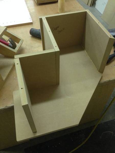

    Well mines a rockford T1 power series so it hits HARD. Like insanely hard. Plus being right behind the console like that you hear/feel it. I can make the whole highschool parking lot hear my bass haha. I think you should be good :thumbsup:

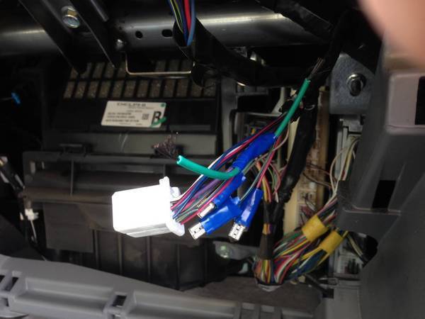

    Got my Homertaco Raptor Grill and wired up the LEDs (look way brighter in real life). Looks so sweet. Turns heads everywhere I go :drool: This is such a quality product and Craig gives superior customer service. I couldn't be happier. You should check his thread out.
