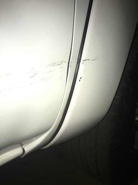

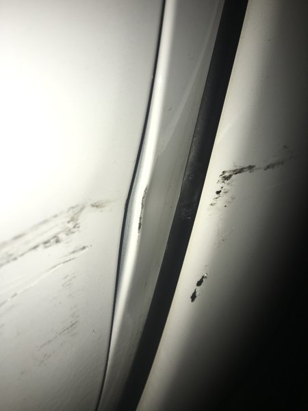

    If you think about what it takes to 100% fix paint damage, I can somewhat believe those numbers.
    You have paint damage on the door, fender, and fender flare. Fixing paint damage either requires replacing the panel and painting it, or sanding the panel and repainting it. You can't "touch up" paint. If a panel needs painting everything around it has to be sanded, painted, and feathered. It is highly time consuming (labor costs a lot).
    Doesn't seem that crazy to me.

    I honestly don't even know what to tell you about the fender. There is a small dent in the area between the door line and the black rubber, but I really don't see it as that much to fix (or even worry about in general). I guess he is just charging me out the ass to fix it and make it look brand new because he can't cover up scratches on the plastic.

    I think the most cost effective way is to find a wrecked Tacoma with a good passenger door and have a PDR guy take a look at that fender as the damage is slight.

    Keep in mind you asked the body shop to quote the cost to repair, which to them is to restore to original condition. If they cut corners and didn't tell you, you'd be incensed and take them to court. They're not trying to overcharge you.
    Tell them you're paying out of pocket and negotiate on a 'good enough' repair - leave the fender alone, don't replace the flare, don't blend the rear door, etc. Give them a chance to align their estimate with your checkbook expectations and see if that will satisfy you.
