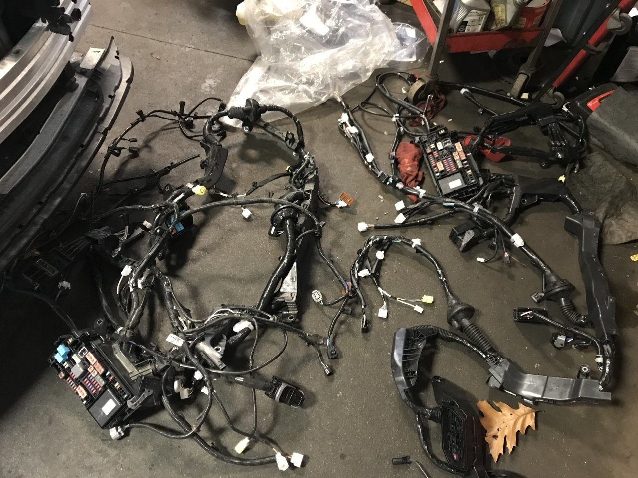

    Liability is the number one reason for harness replacements.
    How would you feel if you did a repair on this system and years down the road and
    Got into an accident and this repair failed.
    Doesn’t matter if planes use splice connectors or your grandfather used duct tape
    And bailing wire.
    It is what it is.
    40 years ago a two wire repair more than likely would have been done with no
    Second thought.
    You can thank this sue society for all this.
    I do this all the time.
    there is no second guessing.
    We will NOT REPAIR AN AIRBAG WIRE.

    all depends on vehicle, which section , how it’s routed, etc.
    It’s a tremendous amount of work.
    So I can’t really say yea or no.
