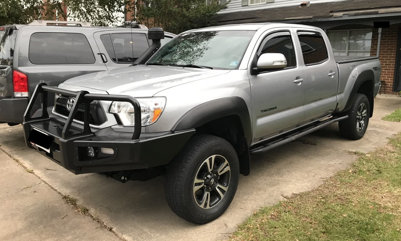

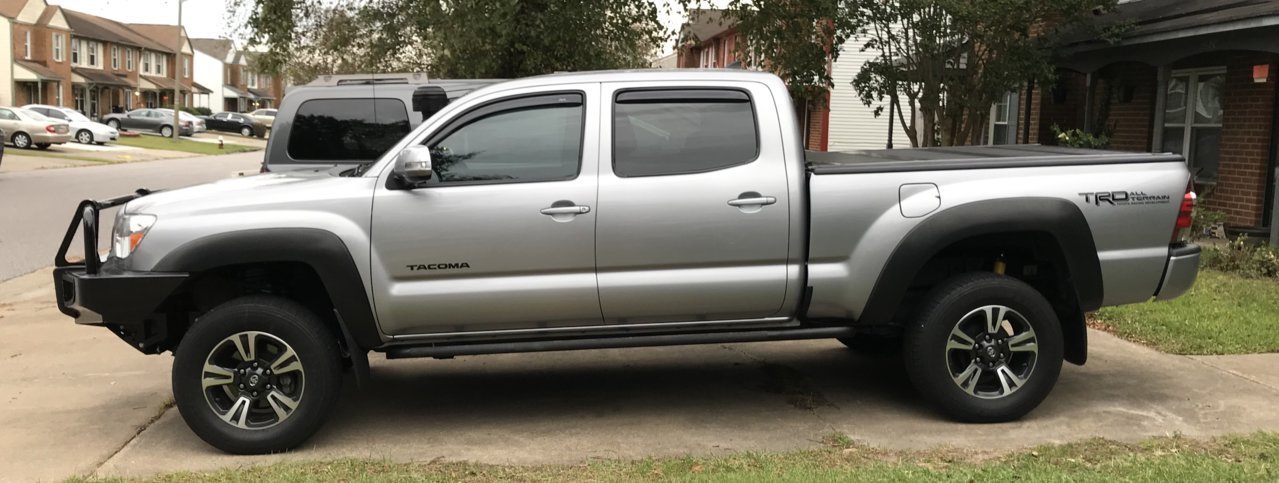

    It isn't the most impressive build on here, but I like it quite a bit. Wheels and tires due to be upgraded in the next couple weeks.
    I should clarify this point:
    My truck started life as a Sport. I swapped the hood and color-matched fender flares, then de-badged and replaced with vinyl decals from @CBoy808. The only features left that identify it as a Sport are the indicator-equipped sideview mirrors and the AC outlet in the bed.
