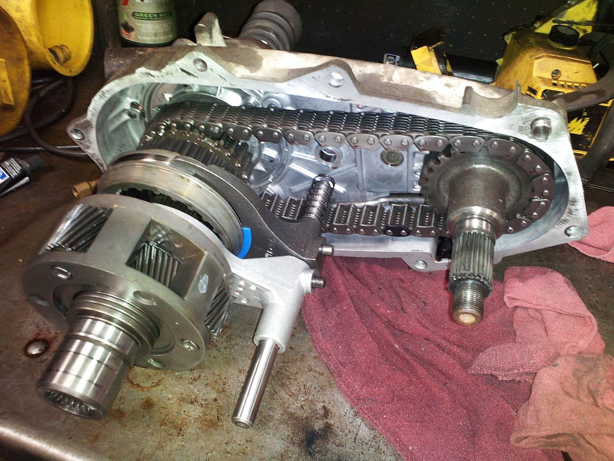

    I have been into thousands of modern transfer cases . Its what I do for a living . I am not basing my opinion on a hand full of trucks .
    I am not smarter than the engineers who designed them . They function very well . I only suggested that I personally slow down to make the shift into 4hi . The chain as well as the synchronizer take a beating at those speeds .

    The inside of the transfer case uses a drive chain similar to a large bicycle chain to transfer power to the front driveshaft. If driven in 4X4 on surfaces with good traction it puts a lot of stress on the chain. Over time the chain stretches and will get loose enough to slip on the gears. This creates a loud popping sound and the truck will hesitate as the chain slips on the gears. Only happens when accelerating from a stop. Once underway it drives normally. But the only fix is an expensive transfer case rebuild.
