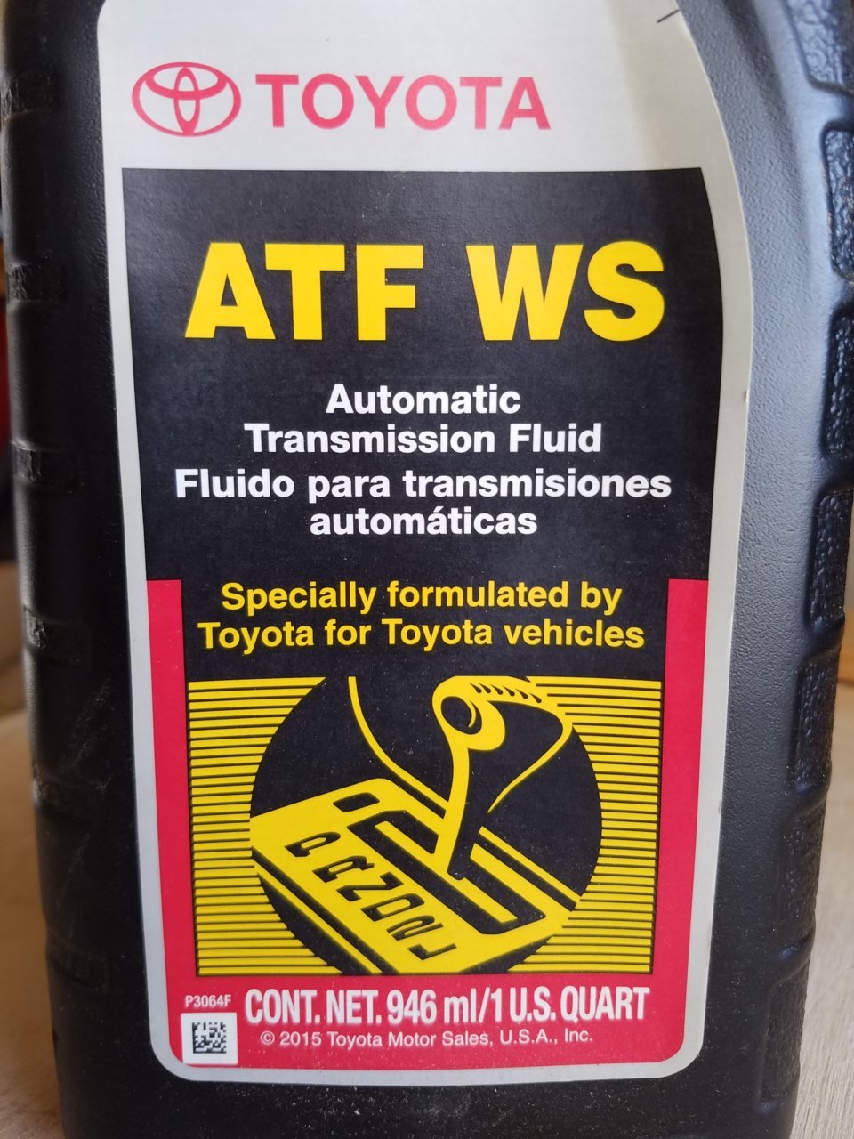

    can i use a transmission fluid equivalent or toyota only to refill?

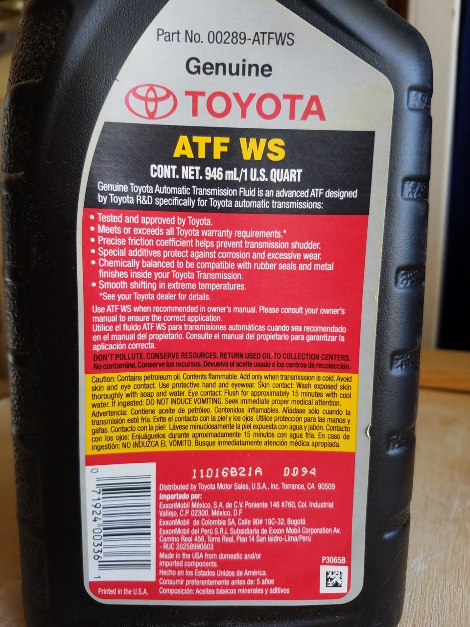

    Be darn sure you have a suitable "equivalent". This is the fluid Toyota calls out for usage in the AC60F for my 2016 Taco:
    fiftyxp[QUOTED][OP] and SilverII like this.
