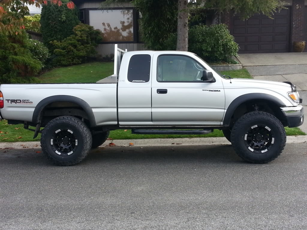

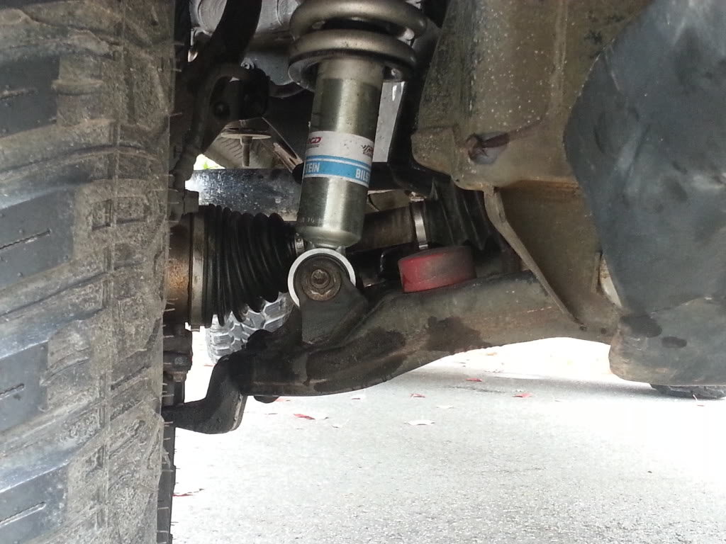

    Here os the picture. Thos os after the diff drop much better no binding at full droop. And the cv stays put. Tested it out flexing on some stuff and seems that there is only about 1/4 inch play in ot now. Before it was about 1.5 inches of play.

    Keep in mind my tires are turned

    How she sits
    Thanks to everyone who gave me input.

    holey cv angle batman!!!!
    is that at full droop or full lock or something?
    see how the fins are touching on your CV axles, no bueno.

    Plan is to do the boot slip mod this weekend

    And yes its at full lock
