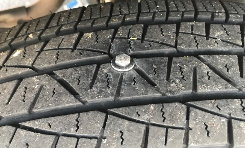

    So I went out shooting this morning ( photo-shooting ) and heard a click click click
    pulled over found this jewel in my back tire. Well there goes the owl-hunt made my
    way over to Big-O-Tires they took it down pulled it out and went to patch it.
    Dude comes in and says you had this tire patched before, about 1 inch away from this one.
    Sure as hell about 300 miles into this new truck ( 2021 at the time ) I hit a similar bolt
    and had it fixed.... and now.... after 2 tire rotations lucky me picks up another not only
    in the same tire but right smack next to the last place.
    They wouldn't touch it - said it was too close to the previous fix, put my spare on for me
    and sent me on my way.
    The spare is a different tire, no TPMS, hub-cap wasn't replaced.
    They said take it down to ( name withheld ) and they'll do it.
    Question 1 - is it really that dangerous to patch close to a previous patch.
    Question 2 - with only 13,000 miles should I just buy 1 new tire of same OEM.
    Question 3 - anybody got one they wanna get rid of LOL ... ( Phoenix area ).

    Not sure about patches, but you can get a good plug kit for cheap. Looks like an ideal candidate for a plug.

    Had something similar happen to me. 2nd puncture, rather large cut. Had it patched from the inside, then swapped the spare onto the rim, put the patched tire on the spare's rim. It'll hold air okay and be useful as a spare.

    Just tighten the bolt. You probably could get by with a truck (big truck) patch.

    Chances are (and I'm not a tire tech so I'm purely speculating here), the fact the tire was already repaired it may be too close and you can't have a patch overlap another patch. That tire does look like it's got a decent amount of tread so if you can find a used tire that might be your best bet.

    For a straight up puncture like you're showing, a plug would work fine. I've run plugs for miles and miles....still am on a couple of tires. Sidewall damage and cuts are a different story. Keep a quality plug kit handy and you're good to go. If you've never used one, there are videos that make it easy.

    Oh it definitely will have to be done from the inside.

    Oh of course. I'm only pointing out that compared to a plug, the patch is like, 2" round on the inside so I could see it being a problem if there's not enough of the actual tire to adhere to, you know?

    Plug and patch, have balance checked.

    I used to work in a tire store, and the shop you took it to told you the correct thing based on the tire MFG and safety recommendations. A tire cannot be repaired and maintain its original structural integrity if it is repaired within one inch of the sidewall, within one inch of a previous repair, or more than three repairs in the same tire. There is a maximum size to, but I forget the exact number. I THINK it might be 1/4 inch.
    Basically, if you get it repaired, the tire has a higher chance of a catastrophic failure (blowout), and most tire shops won't take that risk.

    A proper repair is a mushroom shaped plug patch. The patch portion seals the tire, and the plug portion ensures that the steel reinforcement inside the tire does not rust and compromise the tires structural integrity.

    Been there. Easy fix with a plug. Be thankful its not the sidewall.

    2 holes within an inch of each other? - I'm kinda wary of it - thought I'd check here and online other sources it's a bit dicey.

    Bring it to a good tire shop, they will make the right call, patched not plugged.

    ^ This, same thing I was told back when I was wrenching.
