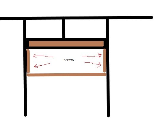

    I'd run a laminated headers like this:
    And screw, not nail the trimmers to the studs.

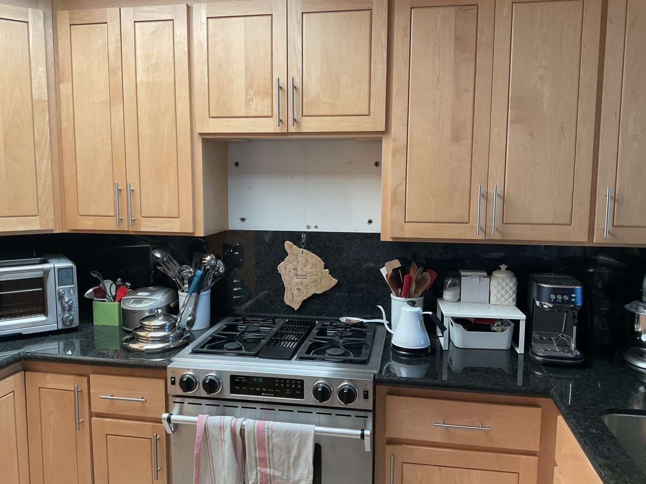

    Going through the upper cabinet might be easier.

    That's what I did at my previous house. 4" duct straight to the attic vent. Easier than going through the wall.
    Edit: also keeps the garage from smelling like bacon. Current house vents only halfway into the attic space, which promptly migrates to the garage access. Truck sometimes smells like last night's meatloaf.

    Photo from the garage side would help. @gtrotter07 is correct that doing the work for the header and trimmers from the garage side is the best way.
    Going into the attic via the upper is also super easy but you loose cabinet space from the vent. If they aren't full height cabinets it will also look like shit no matter how well you box it out.

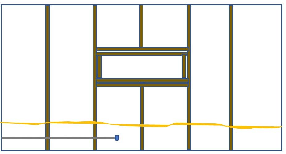

    I'd rather not go through the cabinet above because it's an 8" duct (fans will move a lot of air), plus the space above is kinda weird. Near a big skylight, another roofline comes in near there, etc. The plan is to go out the back, 90 elbow straight up, through the attic floor, through the roof then vent. I'll insulate the duct and box it in with drywall. I don't have a pic but will add one later.
    The duct coming out the vent hood is rectangular, something like 4x10, which I have a transition to the 8" round, rigid metal duct. All rigid, no flex. The drawing I made is not to scale. My original plan was to pull the drywall off from floor to ceiling in the garage, cut the wire and install junction boxes so I could re-route it around, and put in a header with the jack studs. Just hoped there might be another way.
    Appreciate all the advice and feedback!

    2008 DCSB TRD Sport SR5
    I removed drywall today and marked where the rectangular vent will come through the wall. I'm sure there are worse spots, but not by much. I forgot we closed off a door from the kitchen to the garage 20+ years ago. The 3 studs and header are one side of where that door was. The rectangular MDF board is where the vent will come through. I think adding a stud to the sides of where the vent is and cutting off those 3 studs will be the best option. What say you?
