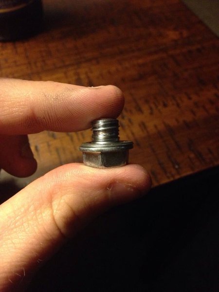

    today while doing my transmission pan drain and refill my drain bolt decided to strip on me. there for now I have to take my pan and get it tapped and re threaded tomorrow morning. ( iv done his 5 times before and this is the first time its messed the threads up!)
    well the good news is after I got the pan off,the magnets and fluid looked in superior shape. I noted while taking the pan off the 20 bolts were very loose. like maybe 5 ft/lbs torque. iv never touched them cause the last thing I wanted was a leak.
    so im wanting to know while iv got the pan down and getting it re tapped should I change the filter even though the fluid appears great? iv just rolled over 105,000 miles. also what brand would you suggest and what's the torque on the 20 bolts??

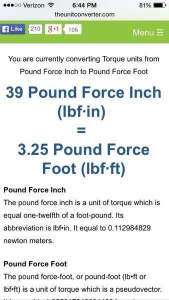

    so after several hours of reading and research iv found that the filter is pretty much reusable just clean it out with brake cleaner, and the torque for the 20 pan bolts is 39 lbs. can anybody verify this for me?

    gearcruncher
    gearcruncher Well-Known Member
    Nov 1, 2012
    #90305
    7,176
    Canadain bumper technician
    Great white North 51.0333° N, 93.8333° W
    2010.TRD.SportDCLB4x4Limited leather package
    TRD Sport Rally -5 speed automatic Limited ,Factory heated leather seats ,chrome package,Super white with front windows tinted to 35 % Dick Cepek DC-2 wheels Summer tires - Good year silent armor P265/65R17 Winter tires - Good year P265/65R17 Ultra Ice studded Illuminated 4x4 switch TRD 3rd brake light cover ($20) TRD seat belt shoulder protectors (5). ($50) TRD ...B pillar emblems ($20) TRD rear slider sticker with devil horns ( $6) TRD summer floor matts ($60) TRD steering wheel emblem ($20) TRD floor pedals .($95) TRD shorty antenna ($14) TRD front Windshield emblems ($17) TRD head pillows .($60) TRD head rest protectors TRD door scuff protection $20 TRD floor matt emblems ($40) TRD tow plug emblem . ($40) TRD cigarette lighter with LED.($35) TRD tissue dispenser ($12) TRD front bezel emblems ($9) TRD door emblems ($6) TRD lanyards($9) TRD lisence plates with TRD bolts($50) TRD fender emblems TRD center caps Part Number:PT904-35070-CC ($80) TRD cd

    Thanks gearcruncher! Also can the oem filter be reused? Or would you suggest a new one?

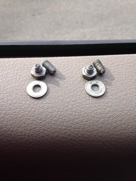

    Just incase anybody was wandering.

    Yeah there's pretty easy to break. I ended up having to take the pan back off x2 to drill and retract the broken bolts
