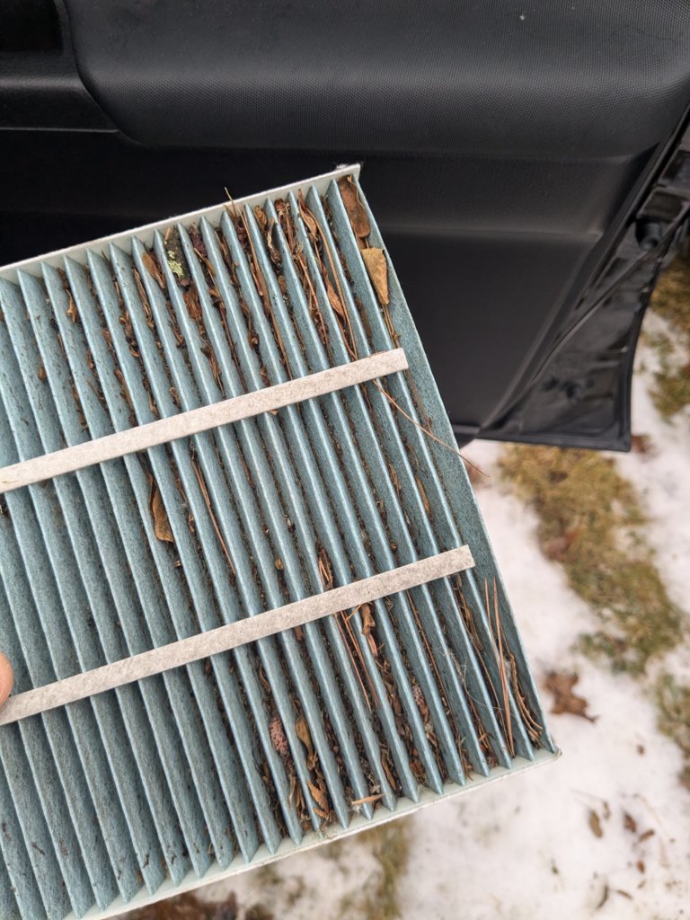

    First check the cabin air filter behind the glove box.

    Replaced at last oil change. I'll do it, couldn't hurt. I'd be surprised to find clues there...
    EDIT: Well, color me embarrassed. That is dirtier than expected, although not enough to impede airflow. The squirrel cage visible underneath moves freely under finger input.

    Nothing IN the fan, just the cabin filter in front of it.
    Apologies for doubting @RustyGreen, I started the truck and, absent that cabin filter, it seems to blow fine throughout the range.:notsure:
    It is 40° f here today so now I'm wondering what the hell that noise was? It's just some leaves and needles in the filter, hard to believe that ICE would have made its way to moving parts. The sound was like interference of stationary vs moving parts. I don't know whether to be relieved or anxious...

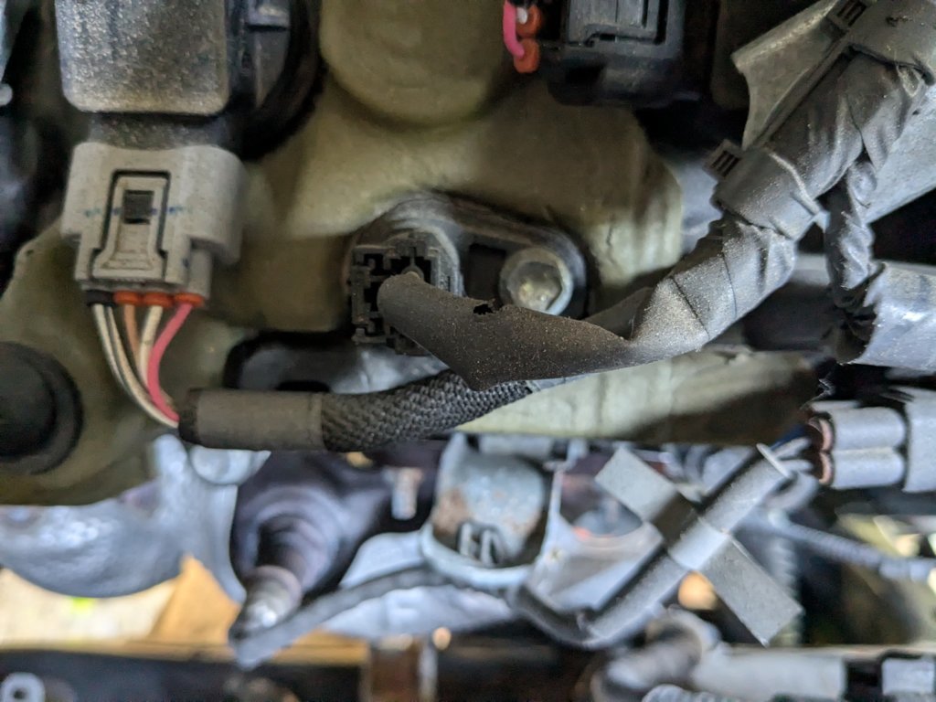

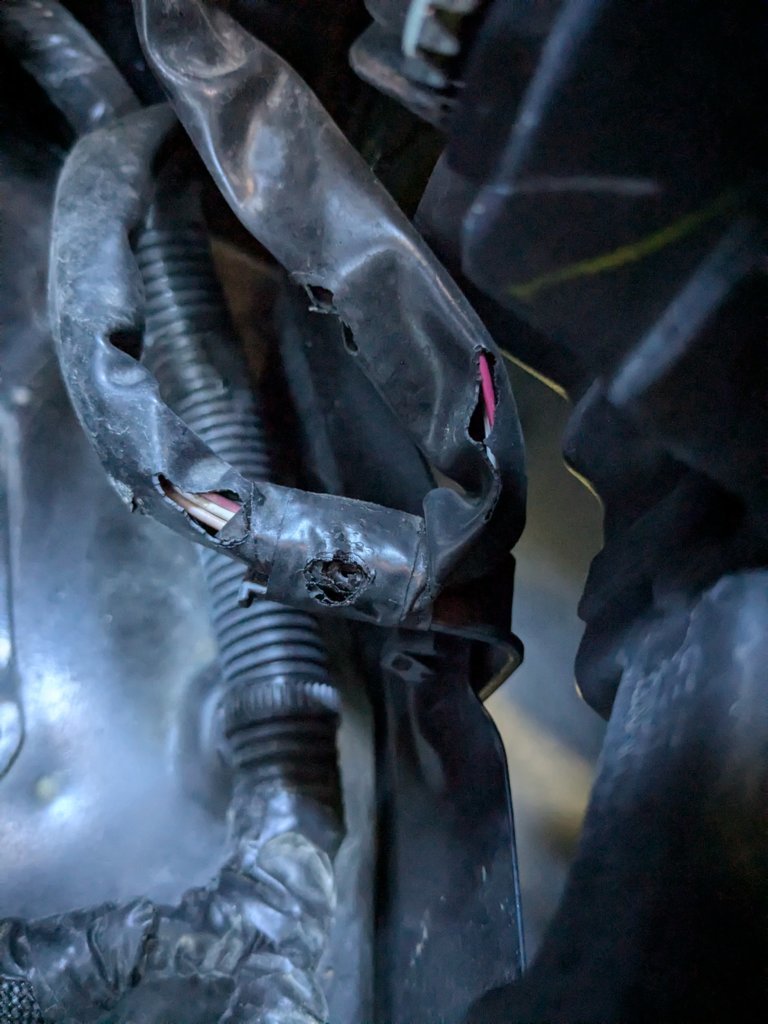

    No but the closer I look, the more I think mice might be setting up shop...PXL_20240628_211724346.MP[1].jpg PXL_20240628_211639865.MP[1].jpg

    Makes sense; the cab's gotta breathe. I'd checked those vents at the back of the cab before in my quest to isolate road noise. They are pretty...not airtight.
    I'll definitely put hands on the cowl today, if that much stuff is getting to the cabin air filter then maybe I have an issue up there.

    Ugh! There has to be something that is available to spray on wires that would make then unpalatable to rodents. Seems a lot of fellows have this happening to them.
    Pscdouglas[OP] likes this.

    Yeah, there are more than a few threads here about home remedies and suggestions about adopting predators to fix this. Seems like a design problem though, not much you can do against mother nature. WHY do they taste SO GOOD!:facepalm:
