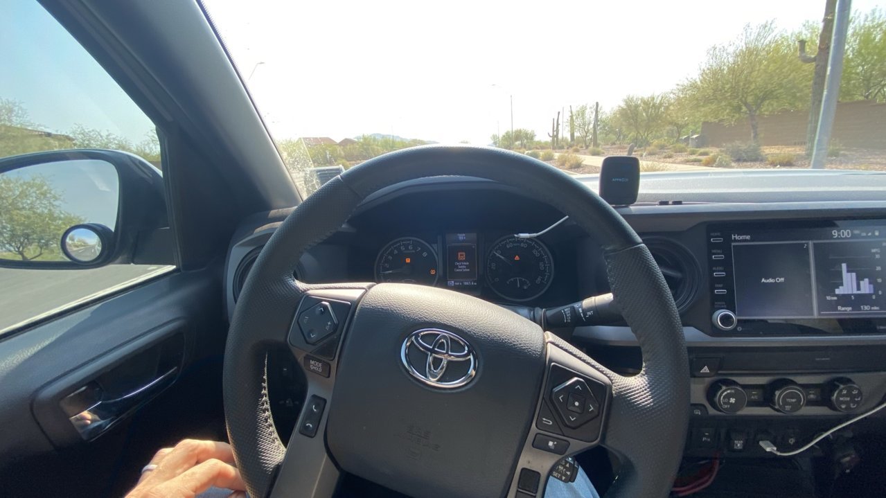

    I recently took my truck on a washboard road which caused my steering wheel to be off centered by about 20 degrees, i also started getting a CEL and a VSC error message.
    I had the dealer do an alignment about 5k miles ago and every time i went over bumps i would get a clicking noise in the front end which i attributed to under-torqued cam bolts.
    Brought it back to the dealer and they charged $120 for the alignment plus another $150 as they had to recalibrate all my sensors. No more clicking noise in the front end anymore though. The one thing i miss about driving a solid front axle vehicle is you never needed an alignment other than adjusting your toe-in unless you damaged a component
    The trucks driving perfectly straight in the photo

    That is exactly what mine looks like! I knew that was Phoenix right away, we're from there originally and shopping for homes there now as I type this! All this discussion about weak front ends is making me nervous. Is it a lack of proper torque or, just a weak design?
