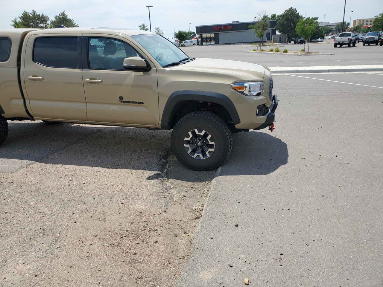

    Pic of the evil Dr. Pothole below, notice the "blunt" exit angle!

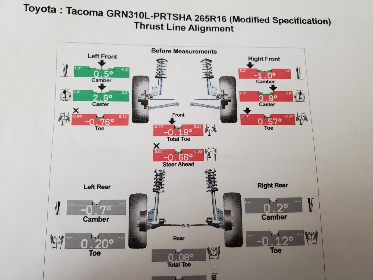

    Here are the before specs, as it was delivered today:
    SR-71A likes this.

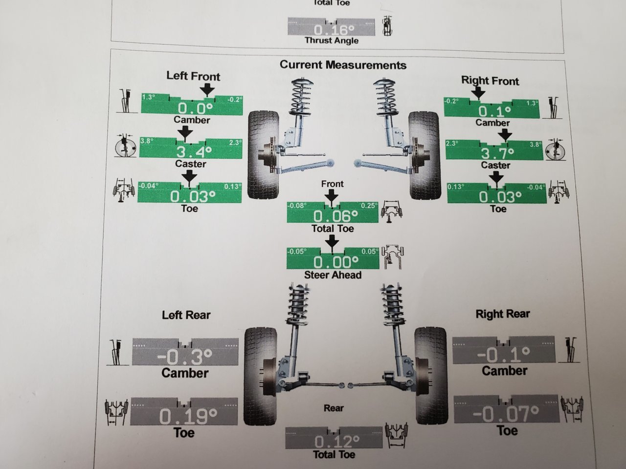

    Here are the new specs as it was delivered after re-alignment:
    71tattooguy and The hammer like this.

    Looks good as it gets. Something jacked up the steering to affect toe on the left wheel, but they got it fixed. So like you said, it’s fixed.

    Nasty hole, unlike the trail, hard surface holes have no give, sorry op, however, the good news is:
