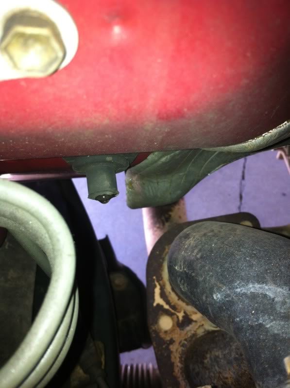

    The evap box drain is located on the passenger-side firewall about halfway down.
    In this pic it's the black rubber nipple thing (supposedly there's a 90* aluminum tubing that goes in there, but mine's missing). Just get a coat hanger or something and poke it in there... should unclog and drain your evap box.

    ^^^not this location
    ^^^this location. look down from the engine bay not through the wheel well

    Mine was easier ot reach through the wheel well.. same location :confused:
