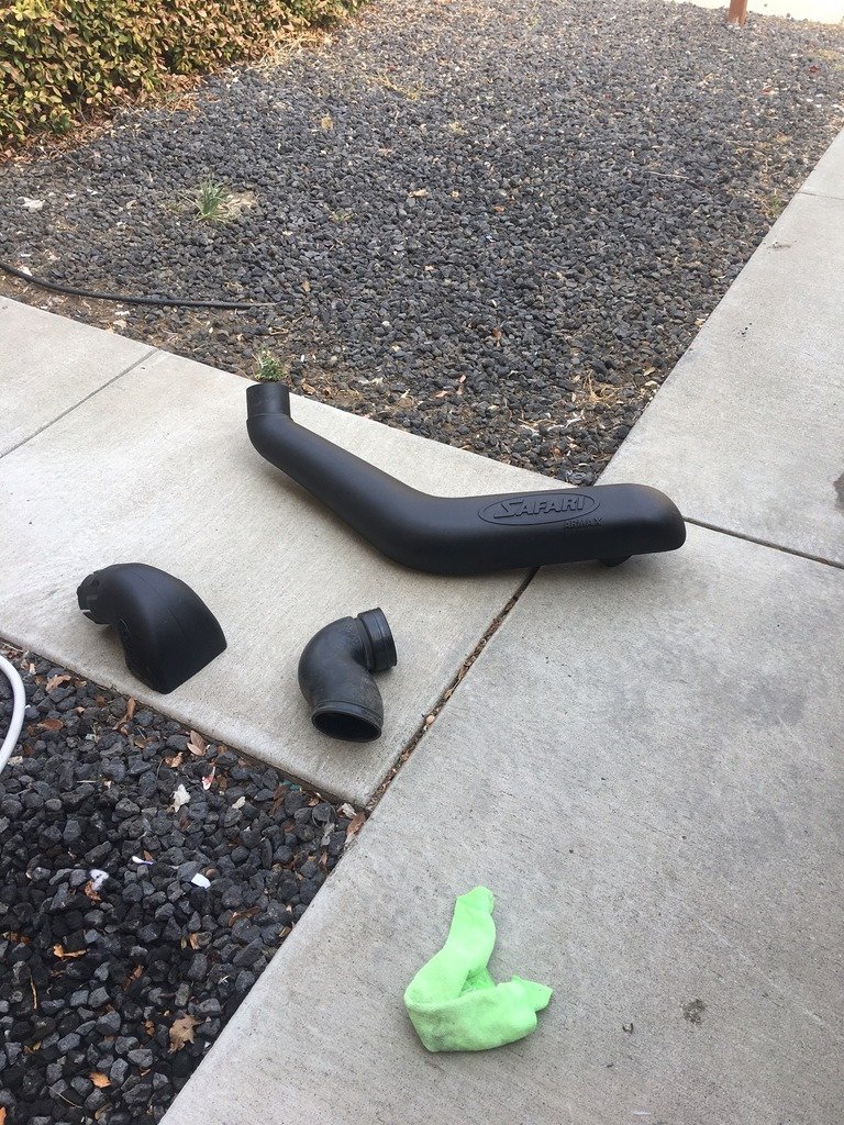

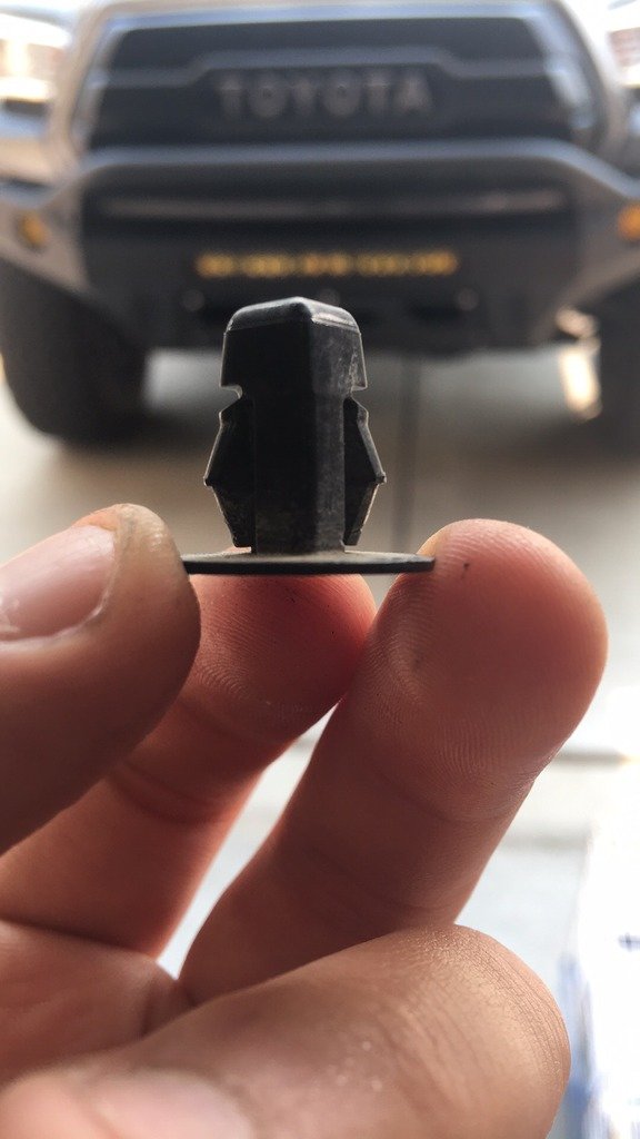

    These little bastards are one of the worst designs i have ever seen in my life... Some of them came out fairly easy while others i left in due to fear of breaking the tabs... they have two small indents/tabs that need to be pushed in on two sides while the other two are smooth... take your time and use a small flat head and work them out...
    https://imgur.com/LROISSR
    The goods in all its glory!
    https://imgur.com/2dTCBk4

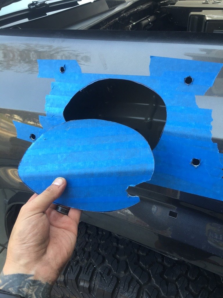

    Stock airbox removed and a much needed dusting off lol
    https://imgur.com/depLNPZ
    Used the ARB template and marked the holes on painters tape to help prevent chipping paint and deburring process
    https://imgur.com/TXvrqRM
    the feeling of cutting a big hole in a brand new truck lol
    https://imgur.com/KVi57SE
    painted all of the holes after deburring and ensuring the test fit was to my liking
    https://imgur.com/yQUBhOM
    highly recommended like stated above of using some type of rubber edge trim to protect the snorkel inlet from rubbing a hole or damaging the inlet which is made of plastic... not necessary since ARB doesnt state it to be a requirement but a nice little touch i thought and wanted to share for future installers.
    https://imgur.com/PkX2kLP
    silicone around each hole to help prevent water from leaking in... again not necessary but i thought since im here might as well do it right lol
    https://imgur.com/CZ06ZKQ
    now the good stuff, finally installed! took about 2 hours taking my time and making sure everything was good to go along with 3-4 test fitments since i didnt want to go through the process of removing the splash guard again.. never again i hope lol
    https://imgur.com/H81r8fC

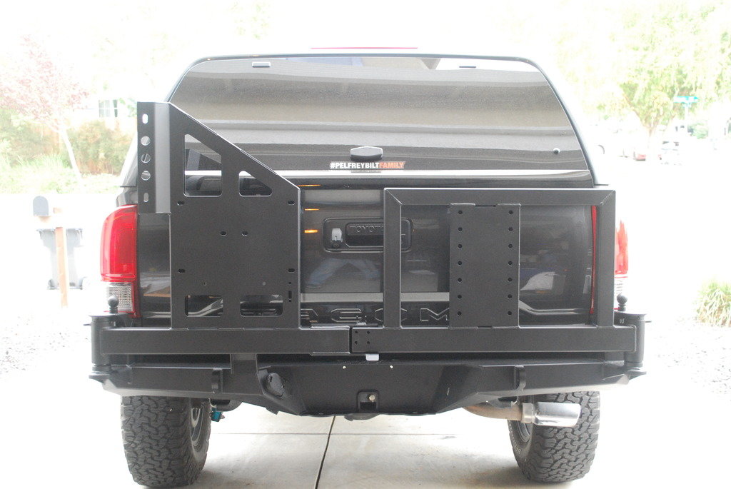

    Installed my Bay Area Metal Fabrication High Clearance Rear Bumper
    Additional Info:
    OEM Bumper heights were 19.5" to hitch/lowest point, 25" outter portion and 23" to bottom of rear fender flare.
    BAMF Bumper heights were 25" to hitch/lowest point, 27" outter portion and 26.5" to bottom of where rear fender flare used to be
    Basically 5" gained from hitch area and 2-3" gained everywhere else on the bumper.

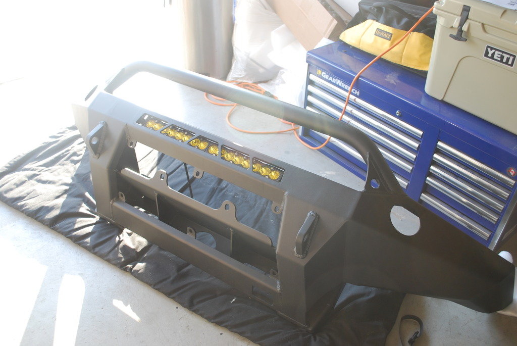

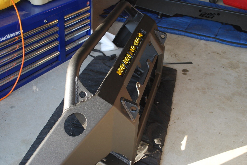

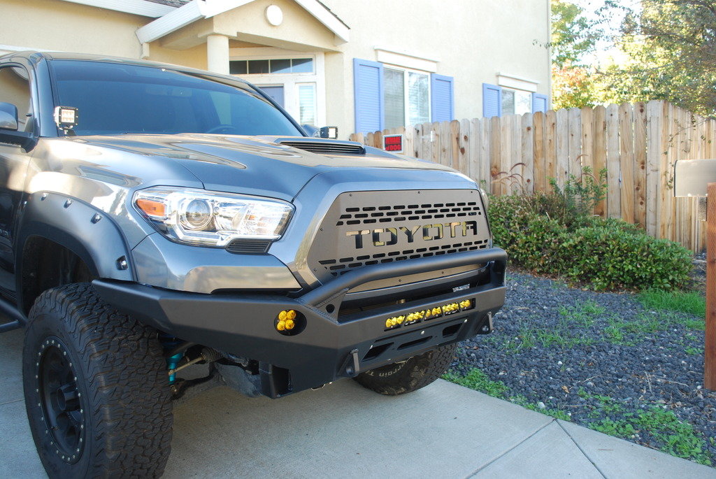

    Update 11/29/16: Happy Holidays everyone! finally finished up the @CBI Offroad Fab T3 front and rear bumpers, all i can say is wow! the craftsmanship, welds and design far surpassed my expectations. They were worth the wait and then some, so if any of you are on the fence about CBI and their bumpers just let the pictures do the talking. awaiting a photoshoot but with an upcoming deployment it may be delayed 6-7 months lol

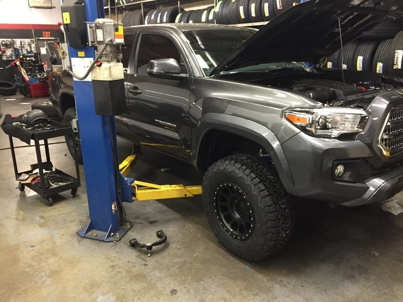

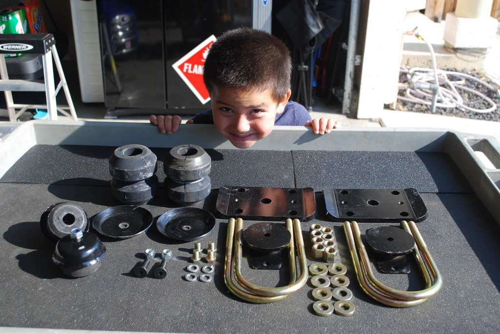

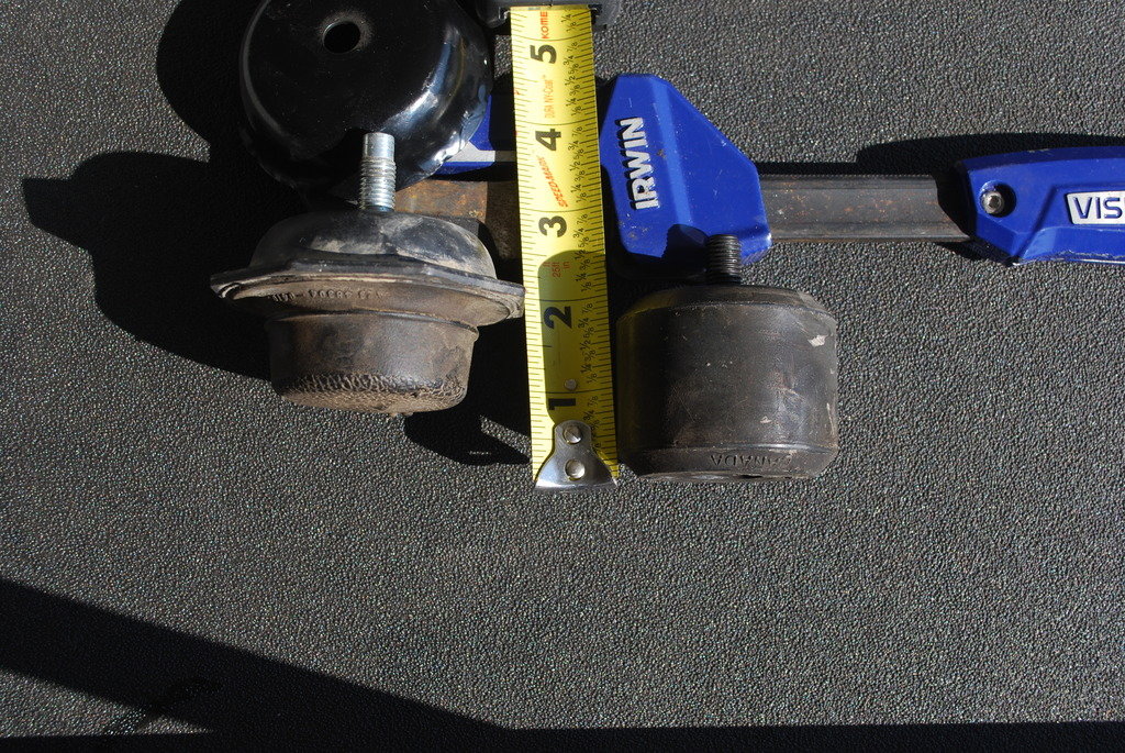

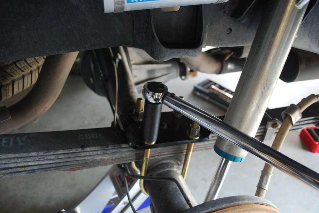

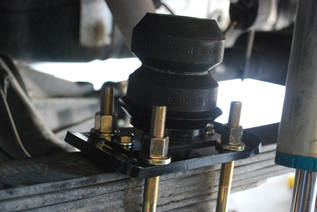

    Update 9/10/16: Teamed up with Timbren Industries and installed/write up for their full front and rear bump stop U bolt flip kit. I am very happy with this set up as i felt hydraulic bump stops were overkill for my application.
    My little helper for the day...
    big size difference compared to the oem front bump stops
    U bolt flip kit complete, just need to install the bumpstop to finish up!
    finished product! came out great and love the extra clearance from the U bolt flip. For a fraction of the cost you can't go wrong with this set up! they had amazing customer service and even better quality products. Sponsor or not i would have ended up going this route regardless. Thank you again Timbren Industries!

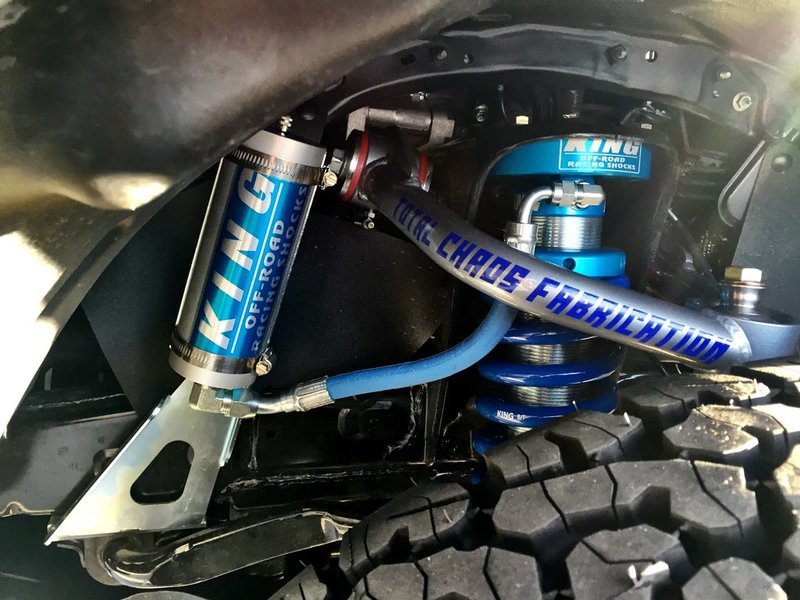

    King 25001-119E Extended Travel, Remote Reservoir Coilovers
    King 700 lb springs
    Total Chaos Uniball UCAs
    Timbren Industries Front Bump Stop Kit

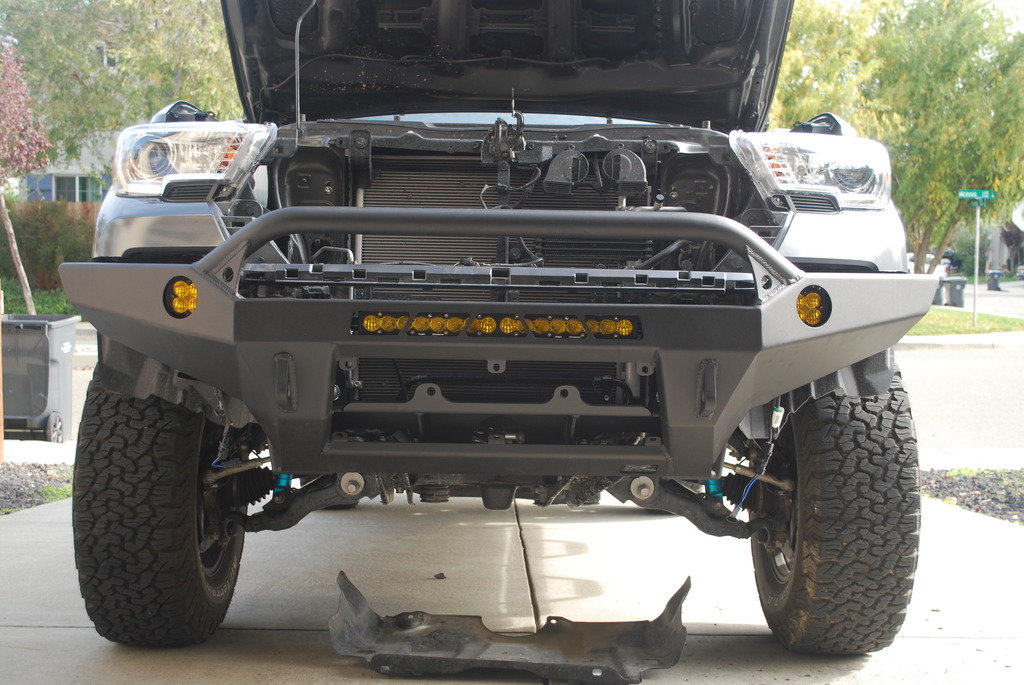

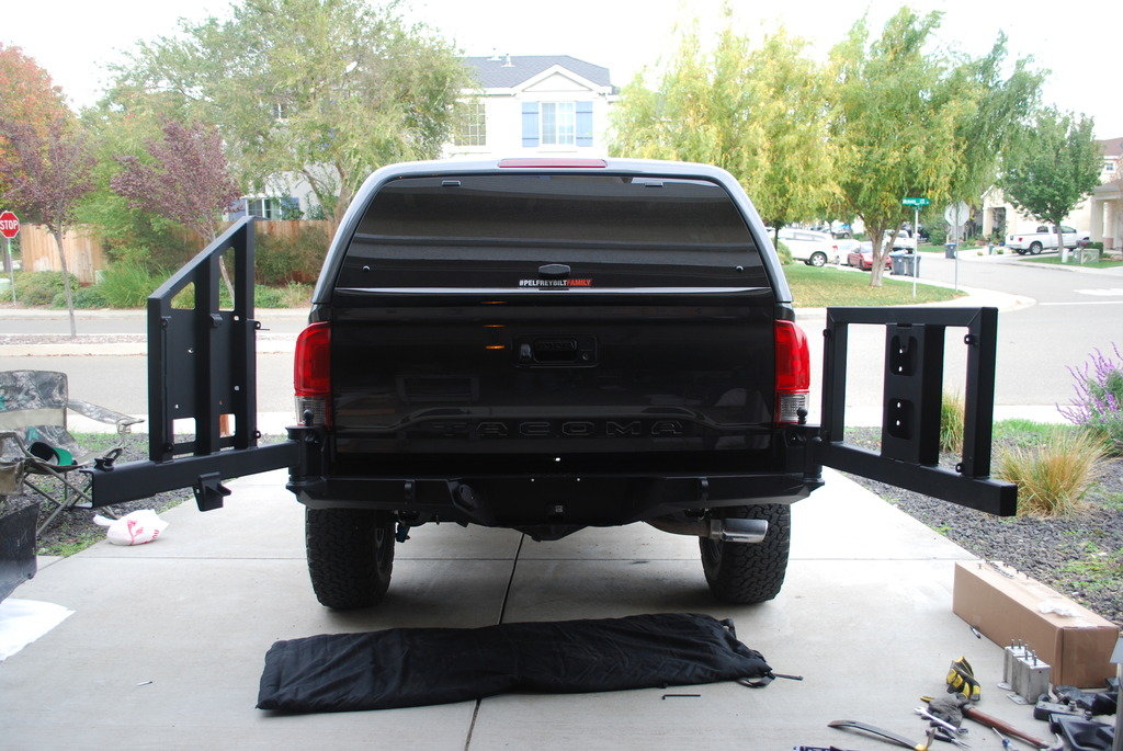

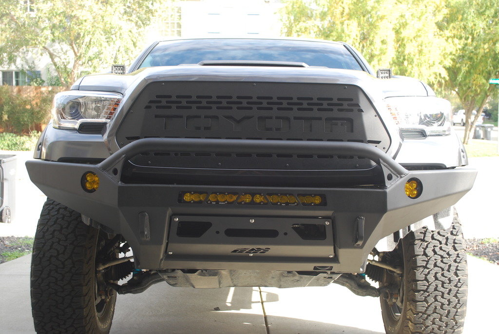

    CBI Offroad T3 Front Bumper with mid hoop

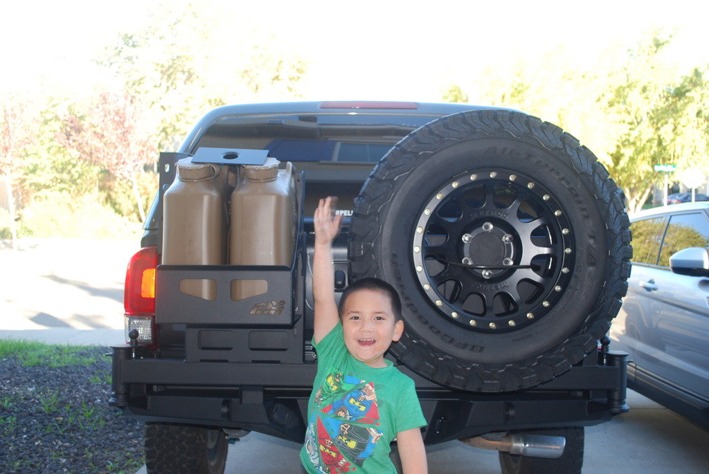

    CBI Offroad T3 Rear Bumper with dual swing arm, jerry can/highlift mount and spare tire carrier

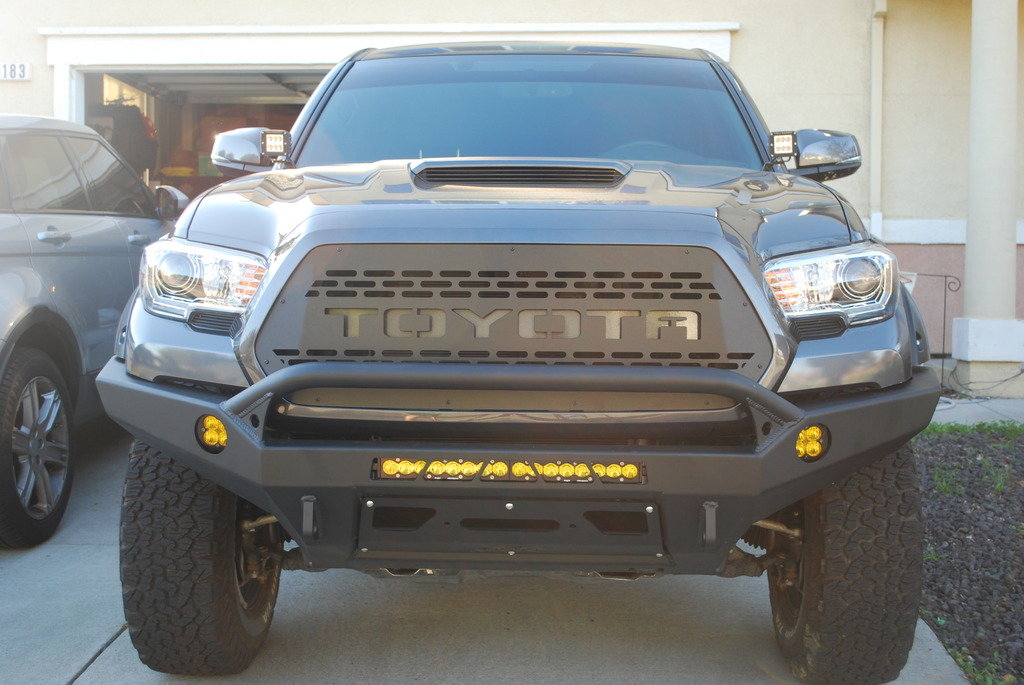

    @Cali_Raised_LED/@Rago_Fabrication Photo/Video shoot for their website/youtube channel... great products and even better customer service. i Couldn't have asked for a better first day with the new truck!

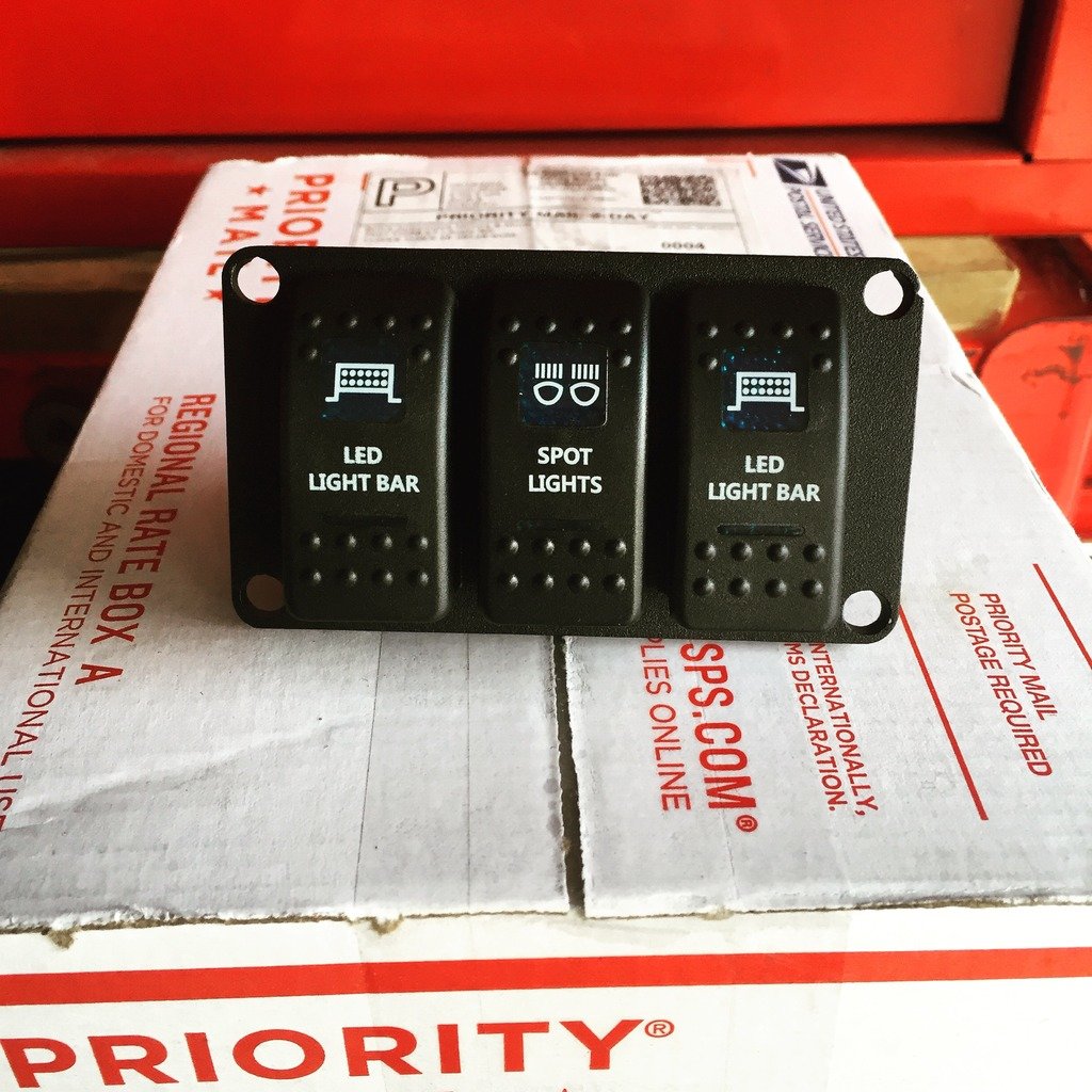

    Rago Fabrication rocker switch panel pre mounted/wired (great product!)
    All wired/mounted up, functions and looks great!

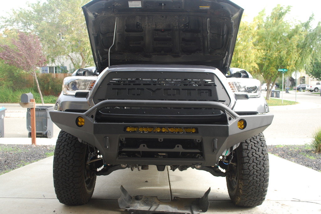

    NFAB 3" Side Steps (love the looks and functionality... typically not a fan of side steps but these look great!)
    All of my lights on... my daughter said it looked like a Light Bright lol

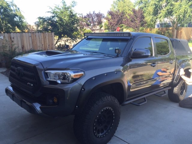

    I have a question about your steps tubes. Are they protective (of the rocker panels) like sliders found elsewhere? I've been heading down the slider route but wife wants more of a step for the kids. I like the look of yours (similar but way better looking than thenPredator step tubes from Toyota) but was wondering if they would help with rocks, stumps, trees underneath.
    Dude, your truck is the sickest mod I've seen here. It's like someone said, "What is everything I can do to a Taco?" And then they did it. Love the lights,mother she'll, all the work.
