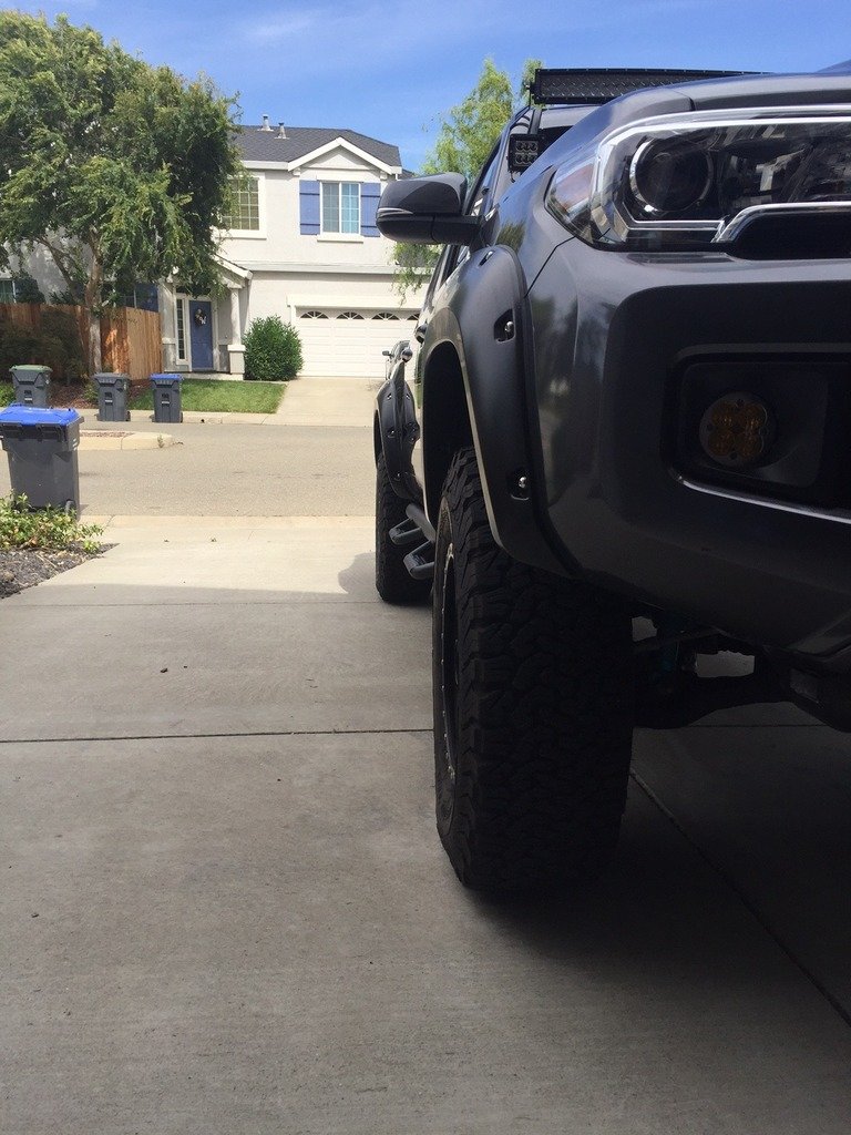

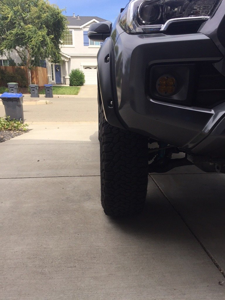

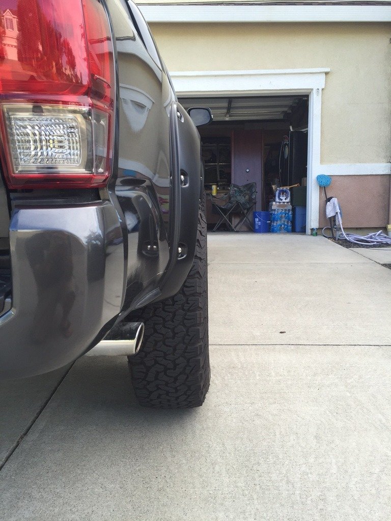

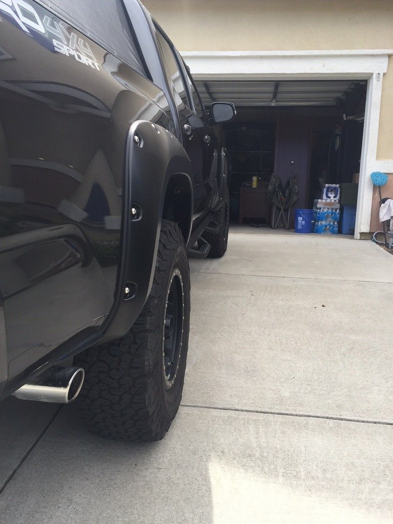

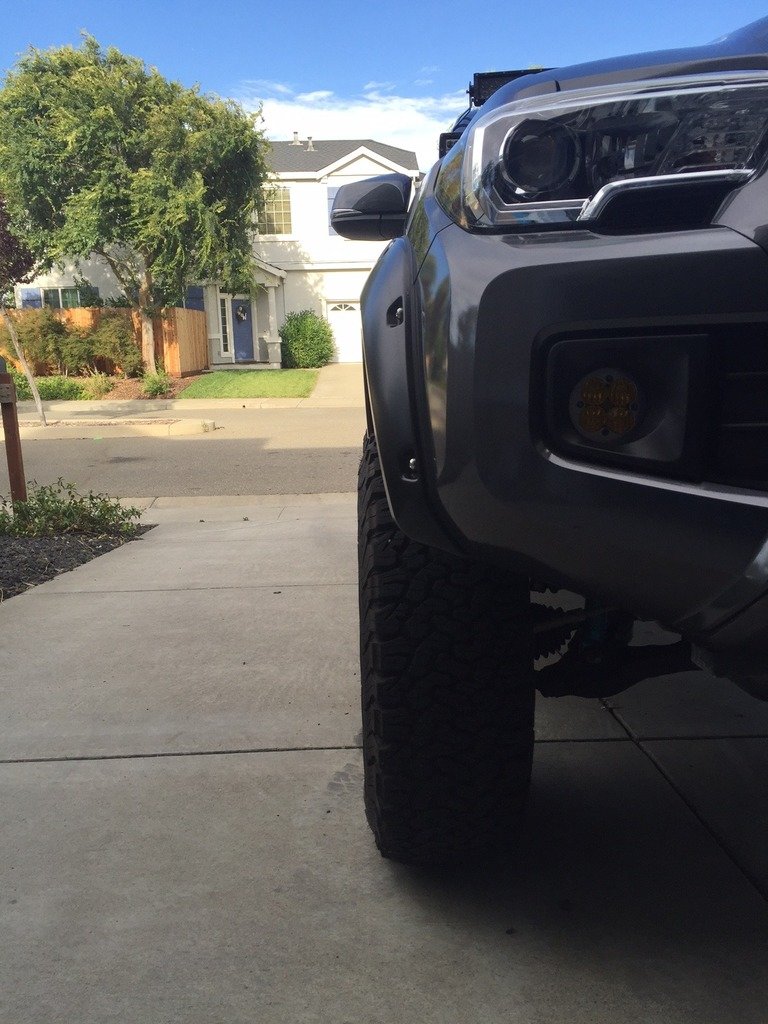

    Spidertrax spacers arrived today and of course i couldn't wait to get them installed to finish the look with the new bushwackers :)
    Before:
    After:

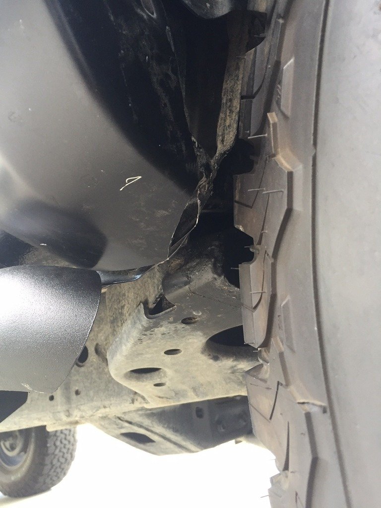

    Had to do some minor trimming to the bottom portion of the front bushwackers... the CMC has already been done but i seem to still hit at full lock forward and in reverse. I'm on kings 2.5's and have the front middle fender to ground at 39" I'm afraid to raise up the front anymore since i already have 11 threads exposed... if anyone has some ideas on what i can do to get rid of the full lock rub please let me know! trying to prevent having to re-do the CMC...

    @TacoMEDIC thanks I ended up doing 0 Toe 1 Camber and 3 Caster... still gets some rubbing at full lock but I have yet to determine where at... not too concerned at the moment but i'll look into it more when I have some free time. @cabo wabo thanks for the thumbs up! just got the black widow venom 250 installed the other day and it sounds pretty good... not a V8 sound which would have been nice but I have to be realistic and understand that this is still a V6
