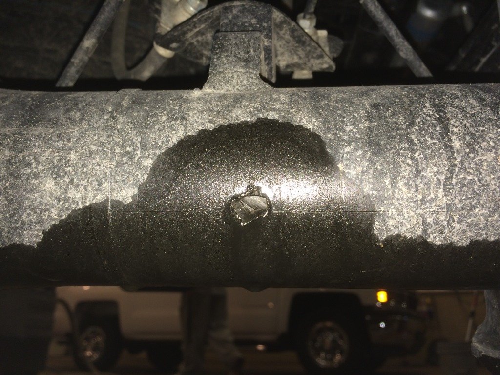

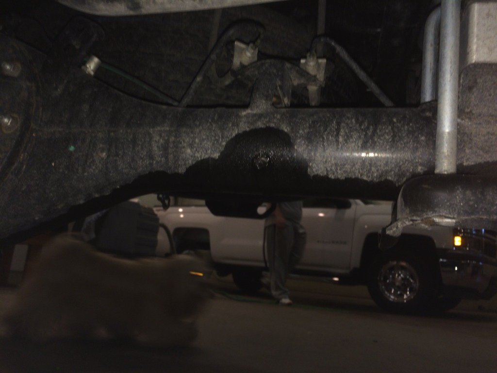

    Had my truck parked inside my shop from Friday evening to Saturday evening. Noticed a puddle under the truck Saturday afternoon. Blew it off at first that it was water from where I washed it Friday before parking it to the side. I knew in the back of my mind water would had been dry by then, so I got under and looked. Rear Axle is leaking diff fluid...

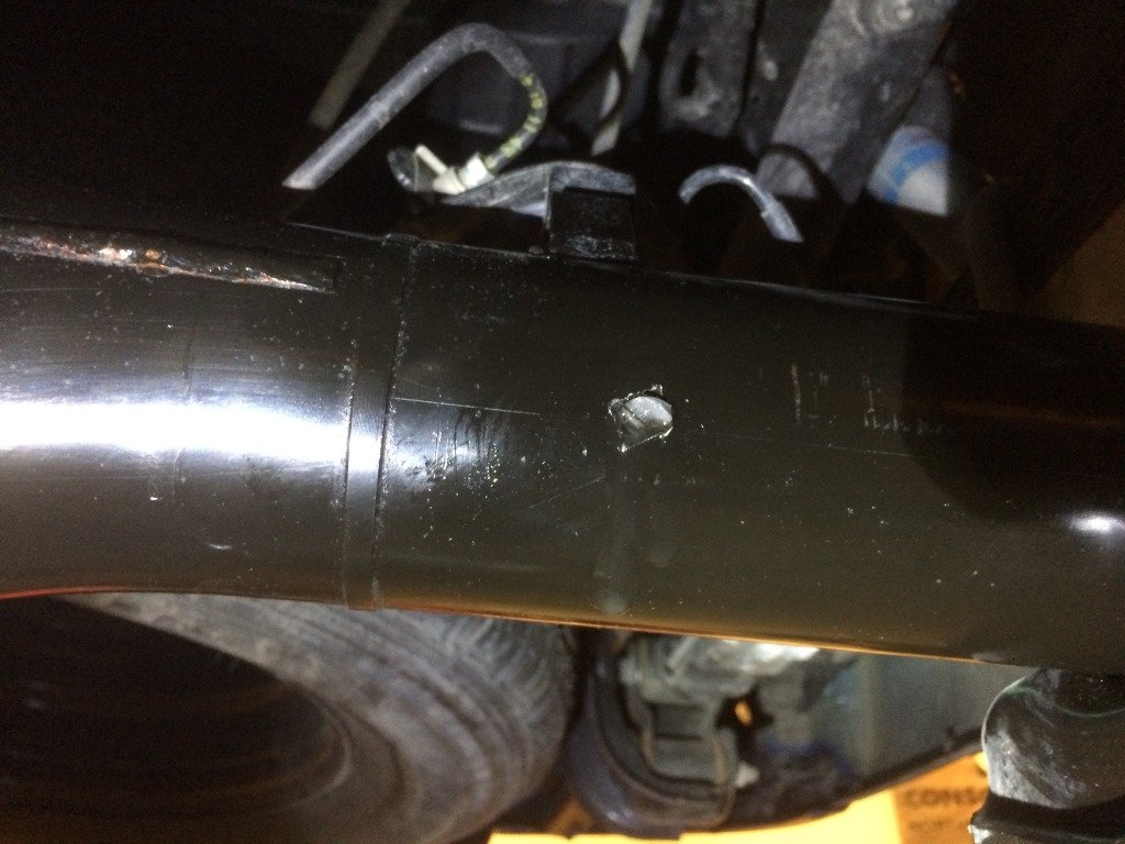

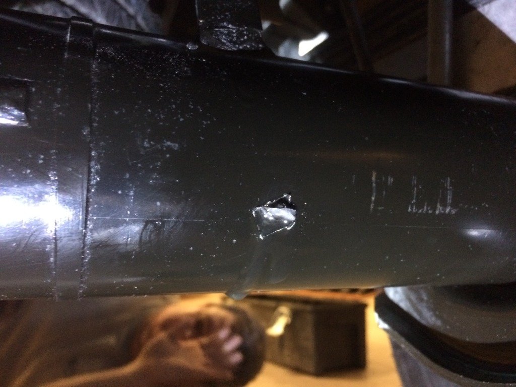

    Yeah... this is my luck... Big chunk os stuff came off a big rig Thursday evening on the interstate. I was able to dodge the bigger pieces but heard one still hit under the truck. Once I got off the exit I looked under truck, didn't see any fluids draining and tires were not loosing air... Thought I was good, turns out I wasn't... Thats a chunk of the metal that came flying at me thats Punctured into my Axle tube. Its still in there. Waiting to see what my insurance is going to cover.

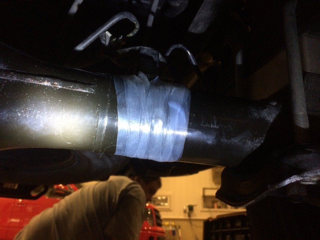

    My Temporary fix. :)

    It's a very small pinhole perforation, welding it would be very simple. Prep for welding would be straightforward. Drain differential, lightly grind area to smooth jagged metal, solvent clean to remove oil/grease contaminates. A couple of quick pulls on a MIG gun trigger and it would be welded, grind repair weld smooth, paint. OR... clean it up with solvent and patch with Devcon® Plastic Steel® two part metallic epoxy compound (no welding)
