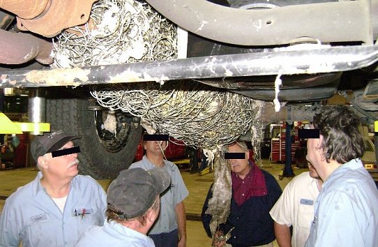

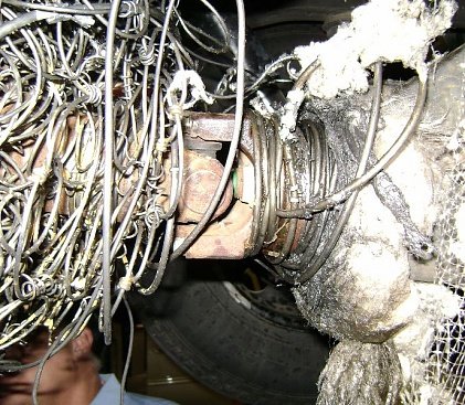

    Could be worse....you could run over a mattress with your jeep....then complain to your dealer about a shimmy!
