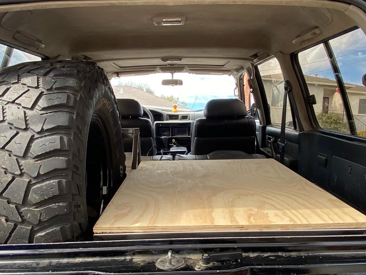

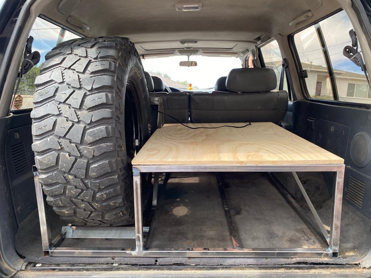

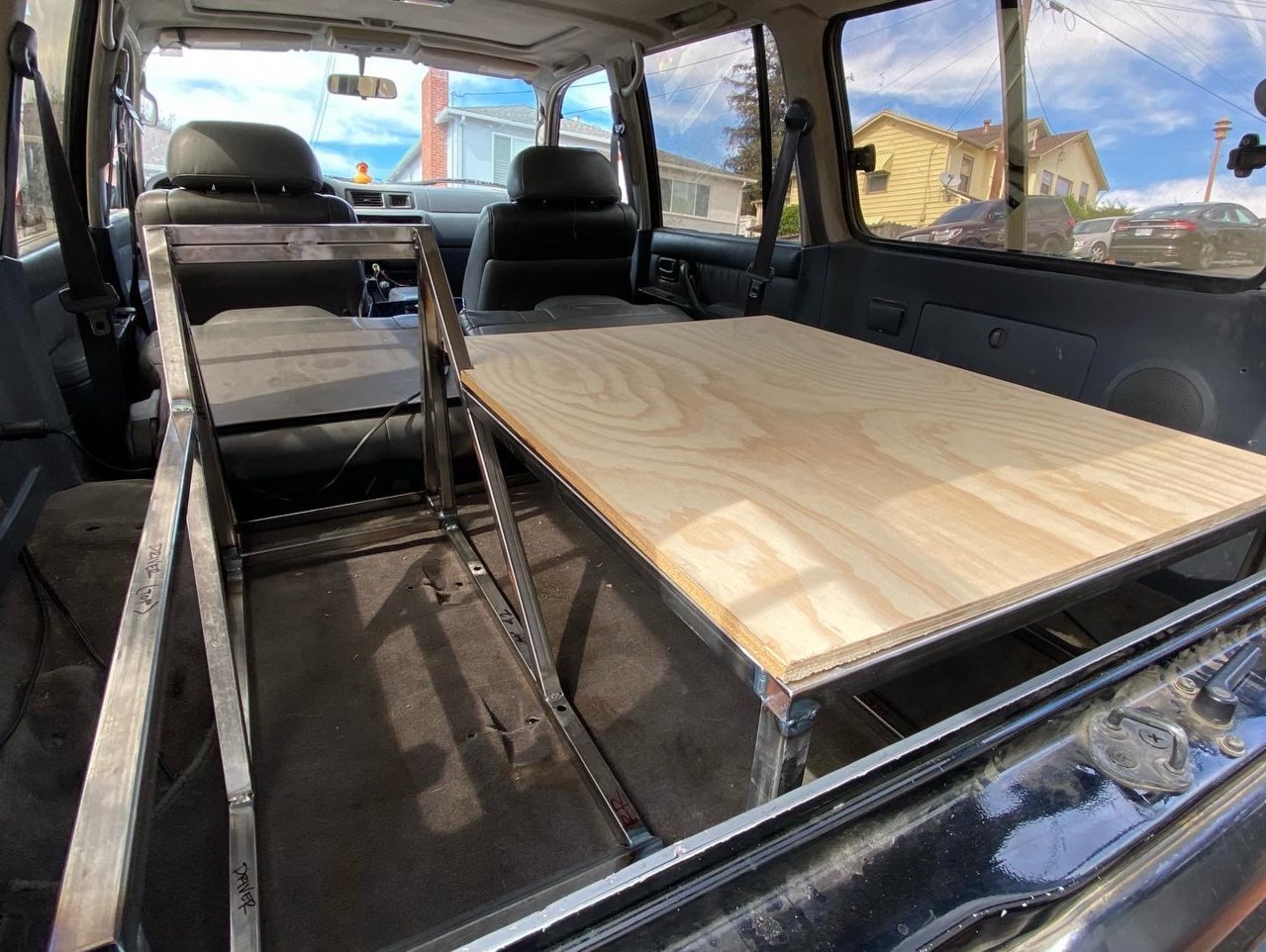

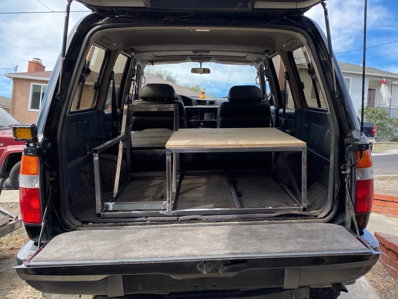

    A couple pics of this weekend's progress. We added a 5/8" thick sheet of plywood to the rack. With the middle crossbar, it is plenty sturdy. I won't post the pic of this, but I can confirm it held my buddy's full weight lol. I think all that is left is to add the two loops for the tire strap, button up a few welds, bolt the plywood shelf in, paint and install.

  4. Oct 13, 2020 at 11:33 AM
    #24
    Kwikvette
    Feb 27, 2019
    #284735
    80,719
    Fresno County
    4 run, 2 don't
    Oh damn, I dig it!

    Thanks! I'm pretty stoked at how well it turned out from its beerful inception hahaha. I have a tilting fridge slide to go on top of it too that pops right over the tailgate (also one of my favorite features of the 80 - having a hatch and tailgate)

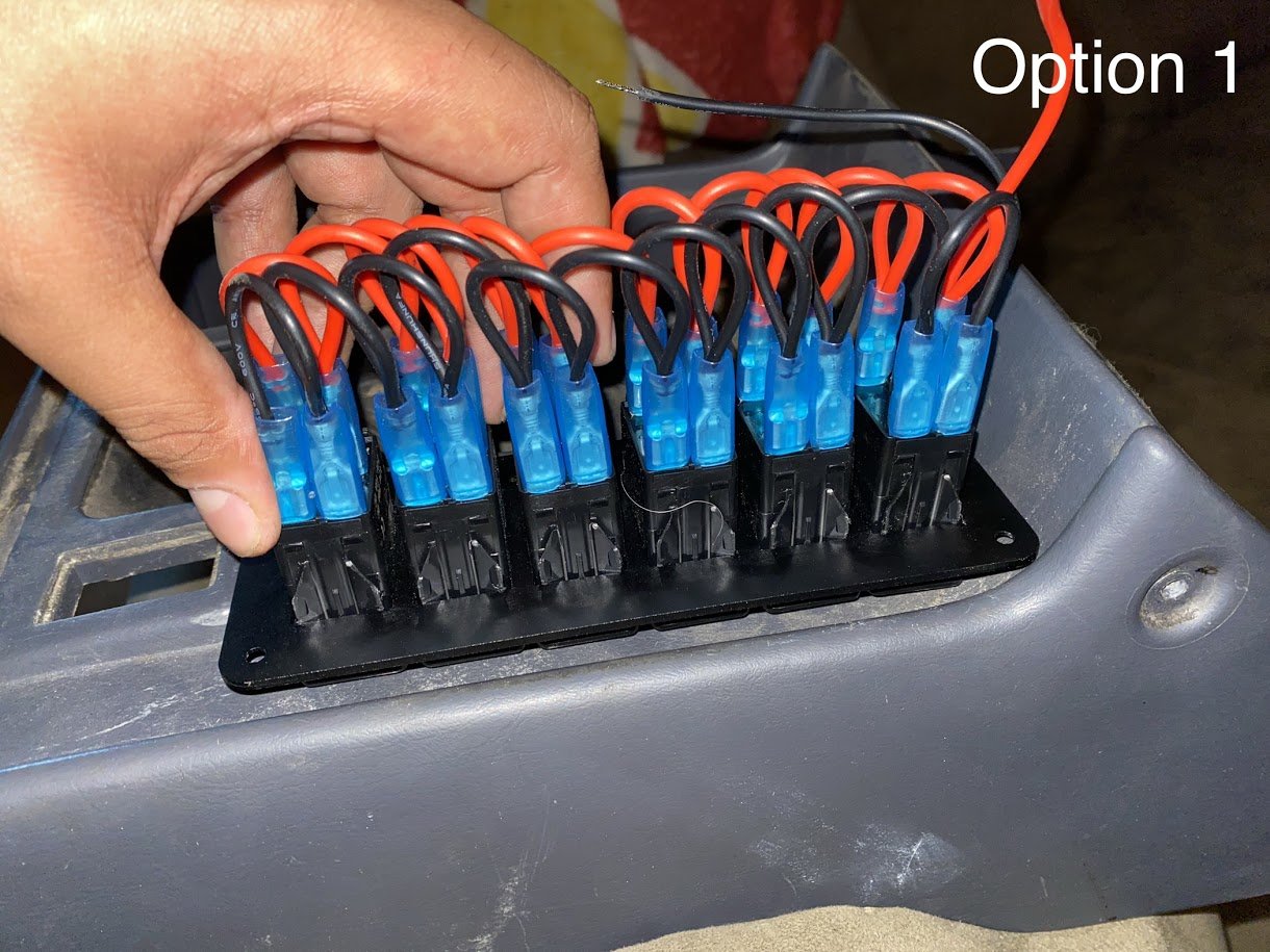

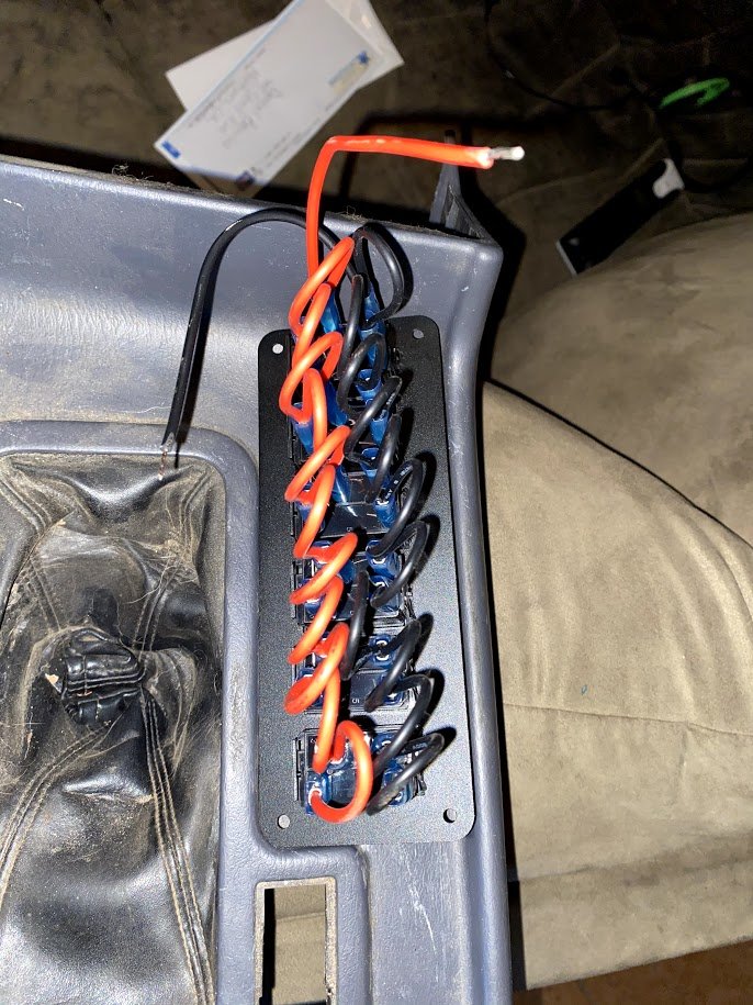

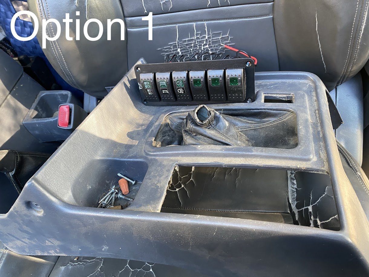

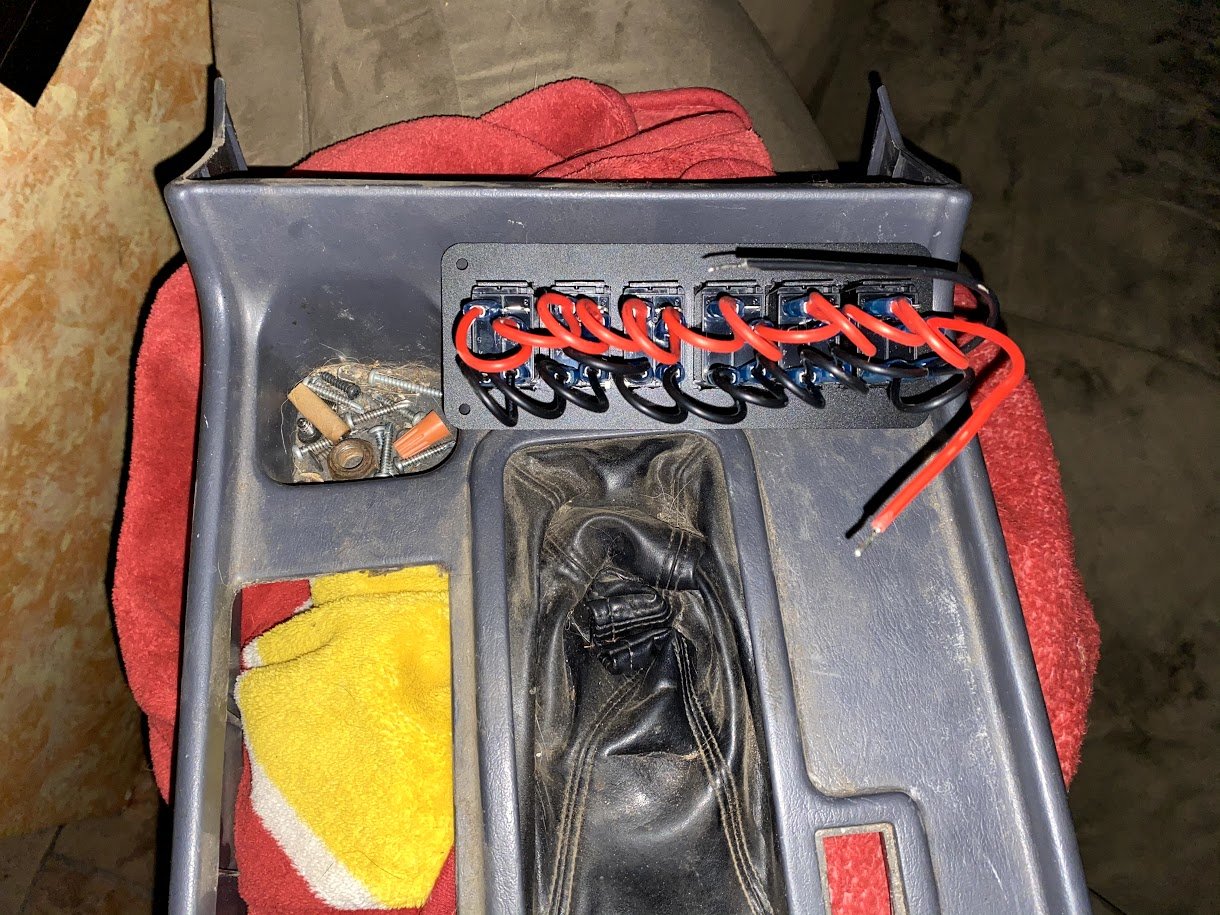

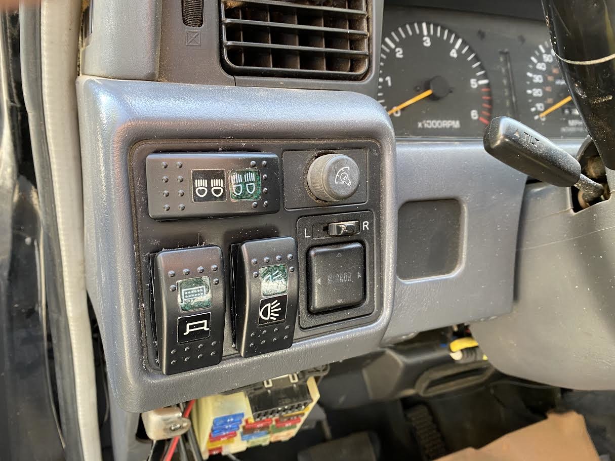

    Another project I'm working on is getting the wiring and switch panel ready for the accessories coming in. I took a chance on a pre-assembled carling switch panel from Amazon (linked here) that turned out to be a lot nicer than expected. The switches are your standard carling on/off switches with a green backlight, the faceplate/panel is made of aluminum that feels strong, and the pre-wiring looks clean. For $30, I'm impressed. In going this direction, I wouldn't try messing with what has been pre-assembled, as that is where some reviews stated problems arose (trying to remove switches, switch wiring patterns, etc.). I'm just going to install as-is to my lights and stuff and take this purchase as a win.
    However, I'm still deciding between two locations. The vertical option fits best as-is and provides the cleanest install, but it also blocks the spot where a cup holder is typically added to this cupholder-free vehicle. The horizontal option would require some cutting of the front area to get the panel to fit and wouldn't look as clean, but it would allow for a cup holder. Adulting is hard...

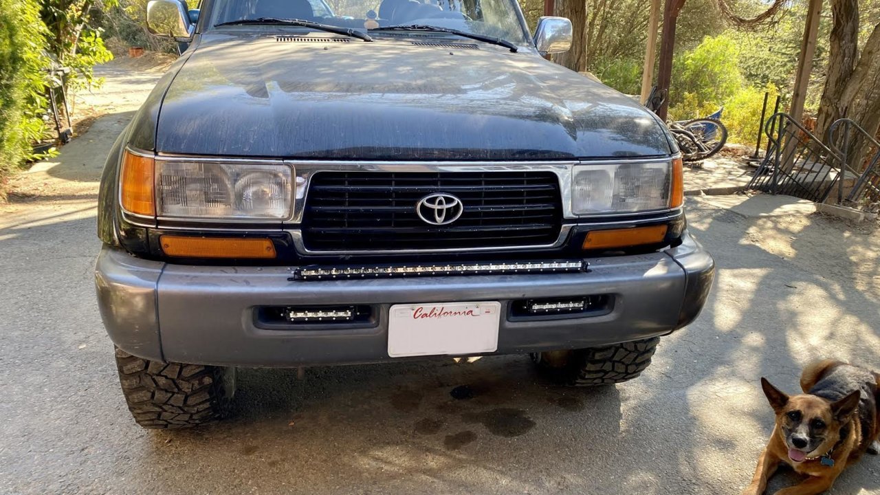

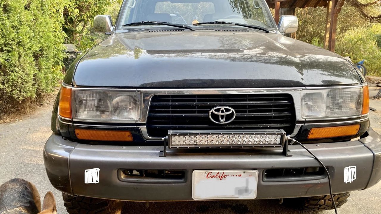

    Apparently the little 7" led bars in the bumper openings aren't gonna work out without some custom mounts (which I don't feel like doing), so I'm going a different route now. The front bumper is thankfully vertical (or close enough to it), so I'm going to get some flush mount pods from @memario1214 and mount them in the front bumper. It's so nice that it's a metal bumper because these mounting options are awesome lol

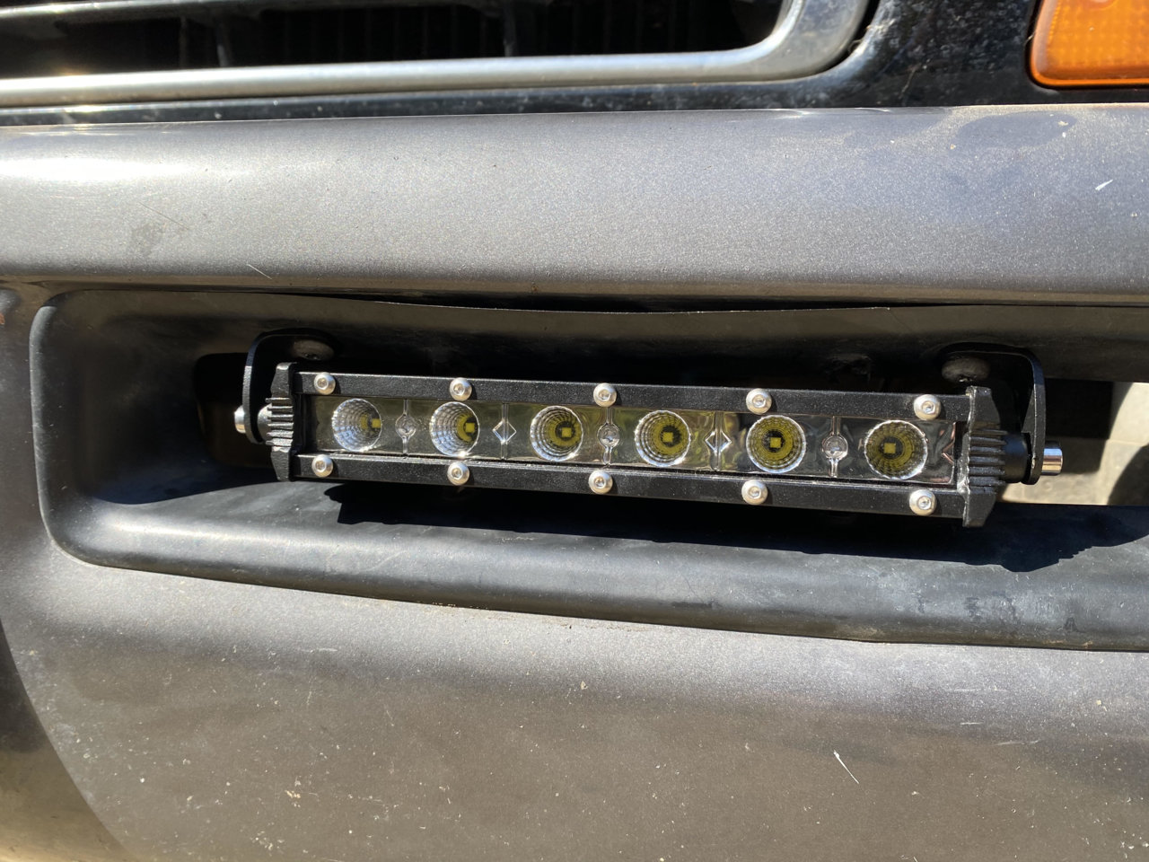

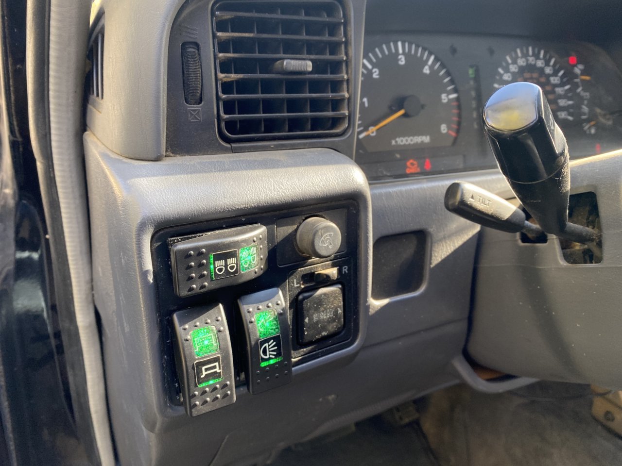

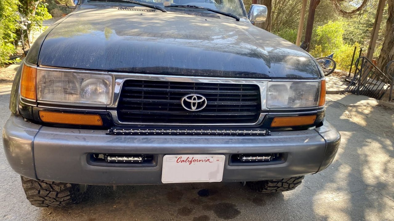

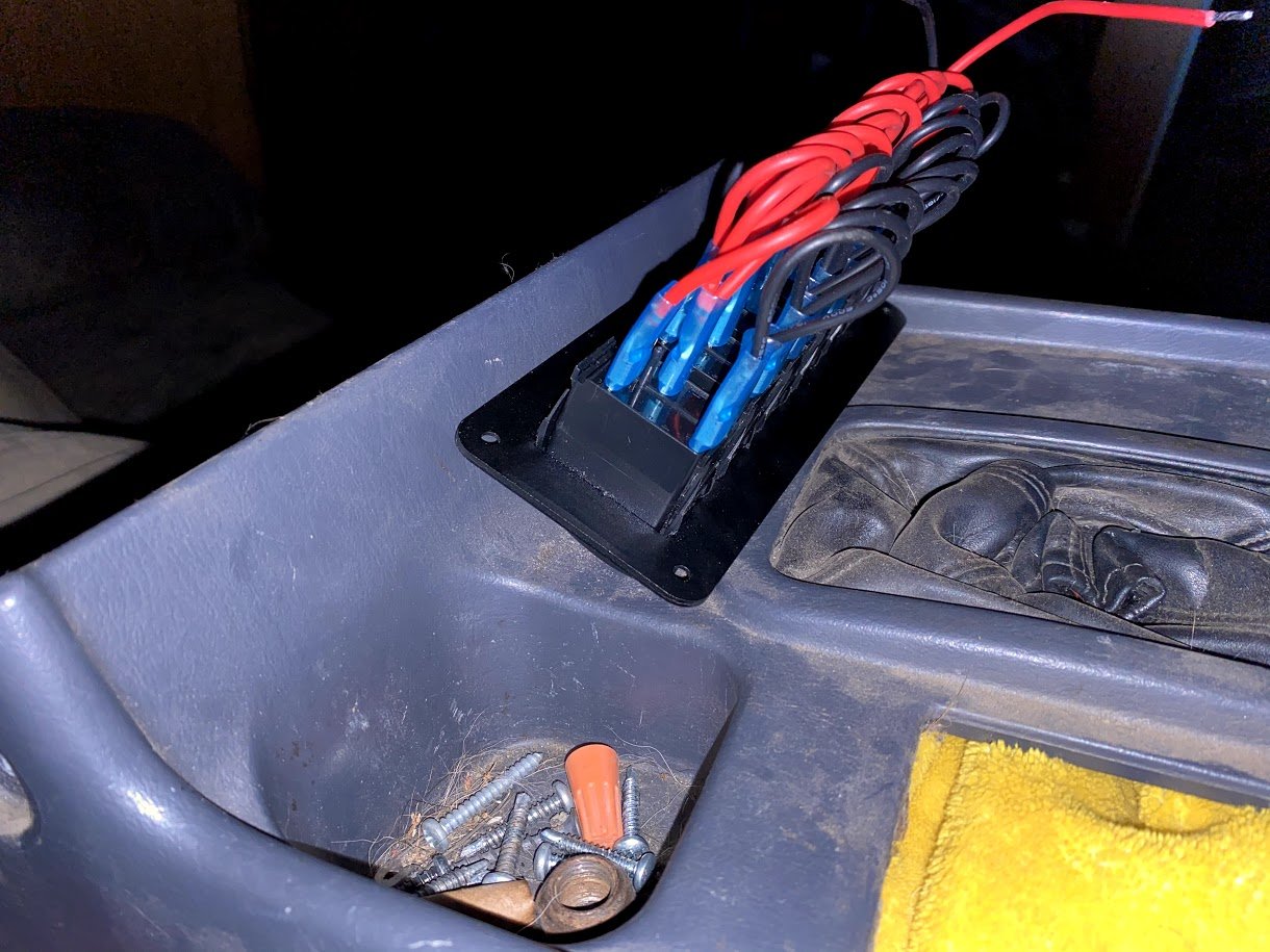

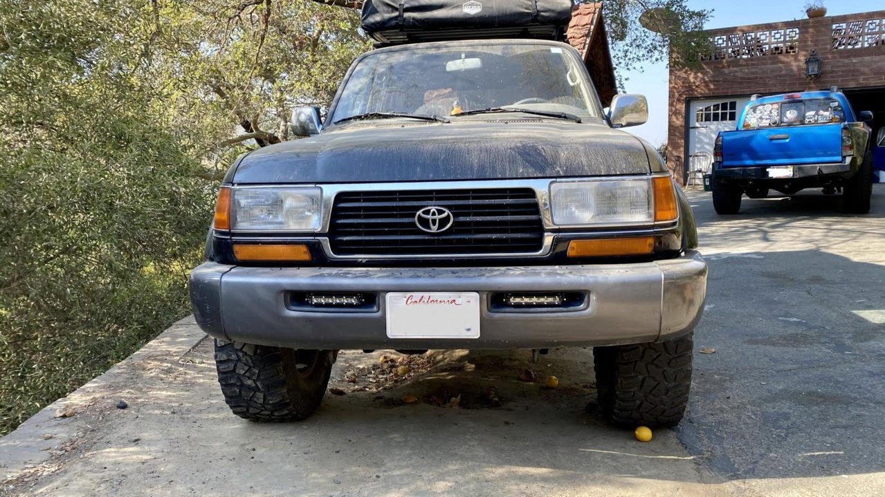

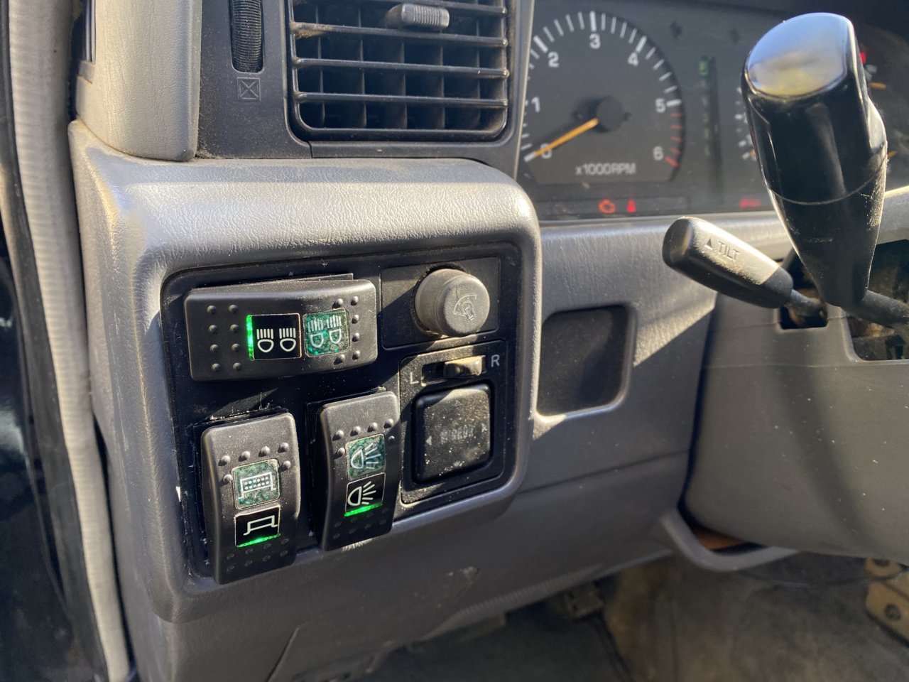

    Almost ordered a new set of flush-mount pods, but something told me to try one last time. Try I did, and this time I inverted the mounting feet - they ended up lining up with the plastic accent piece juuuust perfectly enough to massage the light bars into the mounts. Once I tightened them down, the feet were nice and straight again. Stoked this actually ended up working out! I also ended up deciding to use the switch blanks since they were actually fairly easy to access and had a lot of space behind them. I stole three switches from my switch panel and some of the wiring. Everything came out nicely, just waiting for my fuse taps to show up so I can get the constant-on/independent switch light to come on with the ACC.

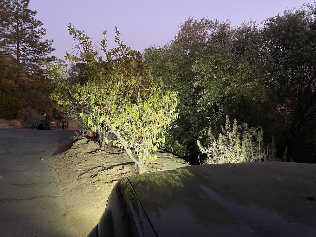

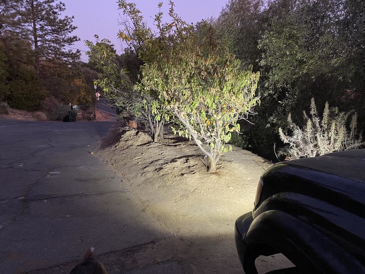

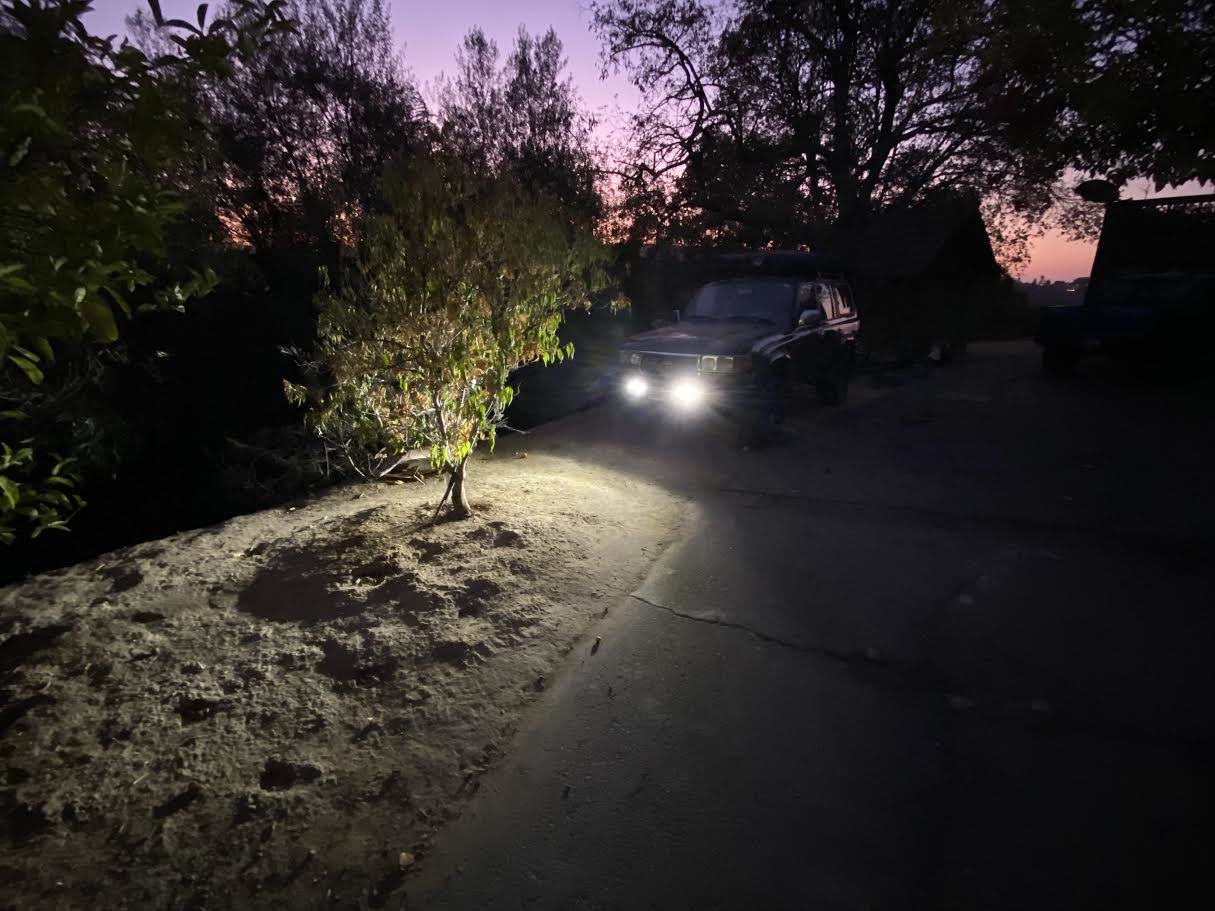

    I was too lazy to put things back together and move the truck, so this is the light output picture I was able to get last night. Not bad for a $55 pair of little 7" bars! I'll get some better ones when I get my fuse tap and button everything back up lol

    Fuse taps showed up, so I got everything buttoned up. Came out pretty good I think!
    Top: bumper lights
    Left: light bar (wired, but waiting for my new 30” slim bar to arrive)
    Right: rear dust light

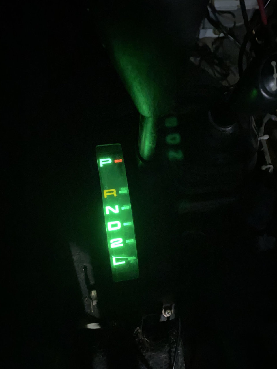

    I honestly didn't even know this lit up until seeing the LED everything thread lol. I got a green LED bulb from superbrightleds.com and it looks great now. Can't wait to literally LED all the things on this truck
