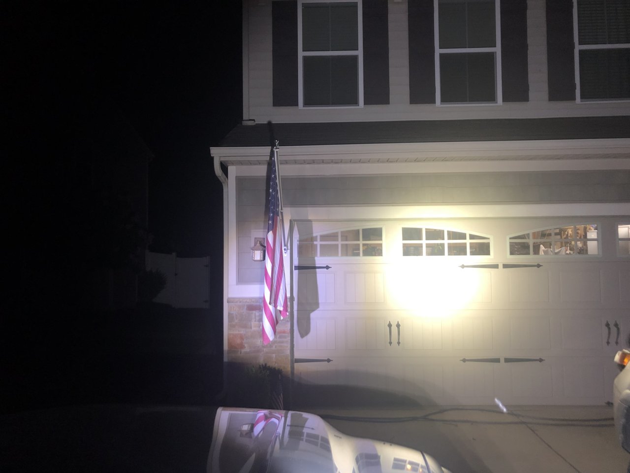

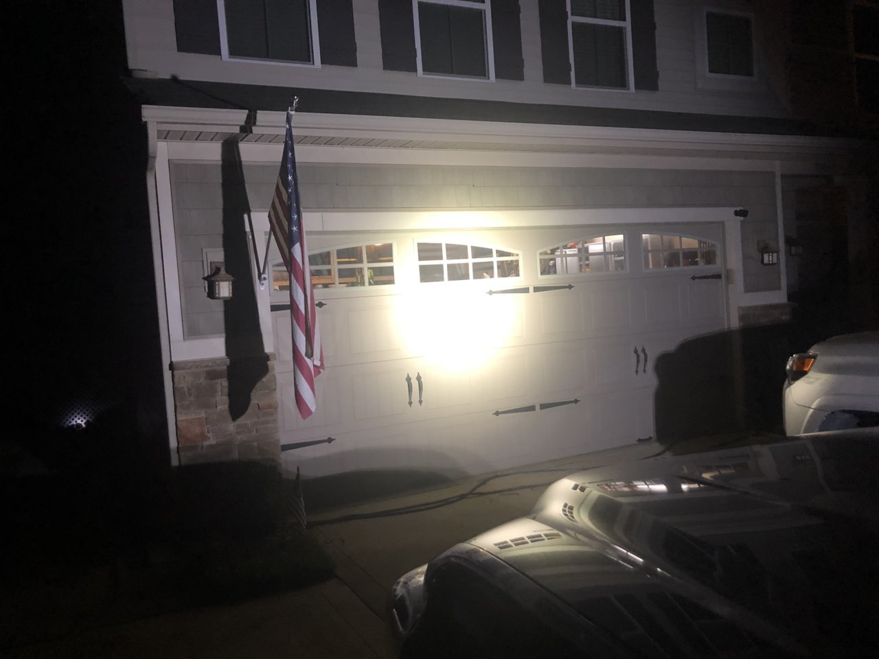

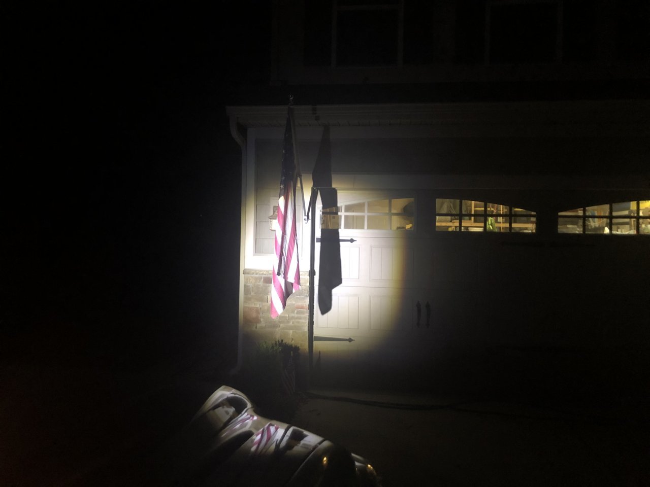

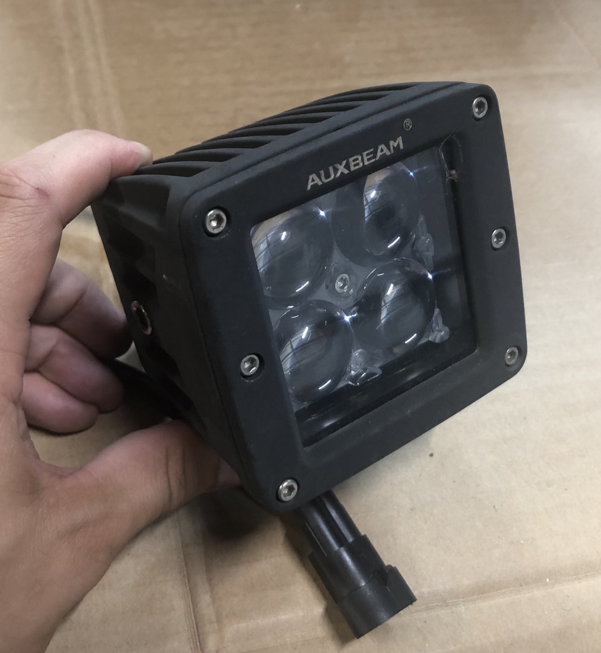

    So I got my lights 3 days after ordering and finally got a chance to hook one up this evening to do a super quick side by side. I’m still going to do the same in an open field tomorrow but the initial impressions are pretty awesome!
    DDS4 vs Auxbeam 3” pod in my driveway, both clear spot
    The Auxbeam I’ve had for 2yr
    Auxbeam only - focused hotspot, little to no spill over, cooler light color almost blueA79E0465-18BD-400C-8E3F-4BDEEE88398F.jpg
    DDS4 only - great hotspot and large amount of spillover, more natural color light0391DC80-D2D6-4402-A045-93B067C0FD36.jpg
    Both - can really see the color difference although the camera does exaggerate the yellow of the DDS4 a bitD9998C65-9F8E-4458-BCA6-C8F696998253.jpg

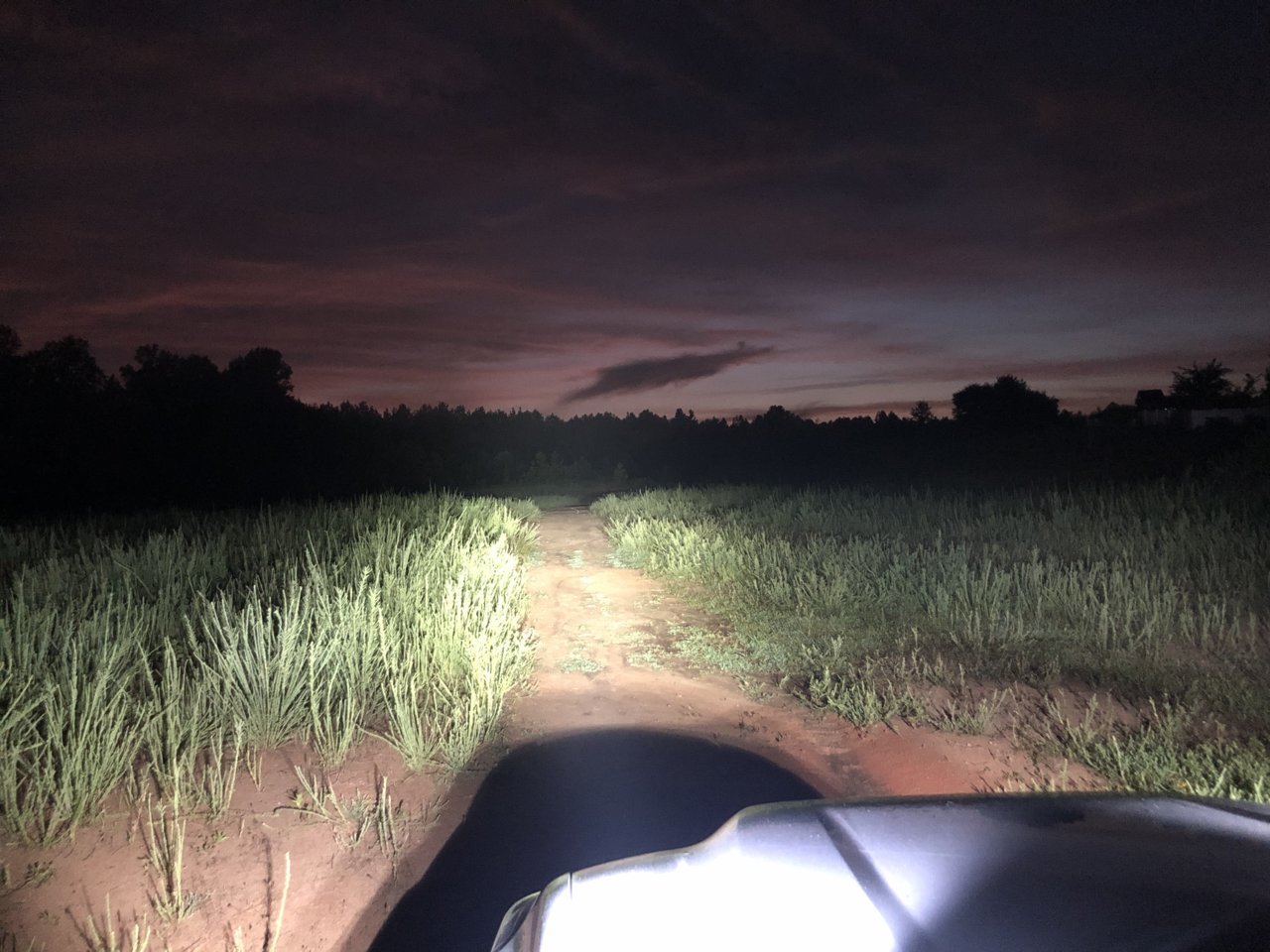

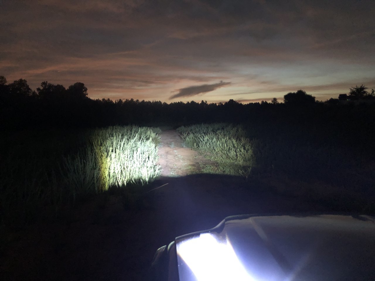

    Despite a rain storm coming through and knocking out my power, I was able to get the lights hooked up and test them out in the open field near my house.
    The DDS4 have a nice finish to them, I believe they’re powder coated. I’m curious to see how the finish stands up the the NC sun since my Auxbeams have faded badly becoming chalky looking after only 1yr.
    To my pleasant surprise, the DDS4’s have the same type of water right connector that I used on my other lights. I did have to swap the polarity on mine because I had it reversed but that took 10min, pretty easy. This made swapping the new and old lights a piece of cake.

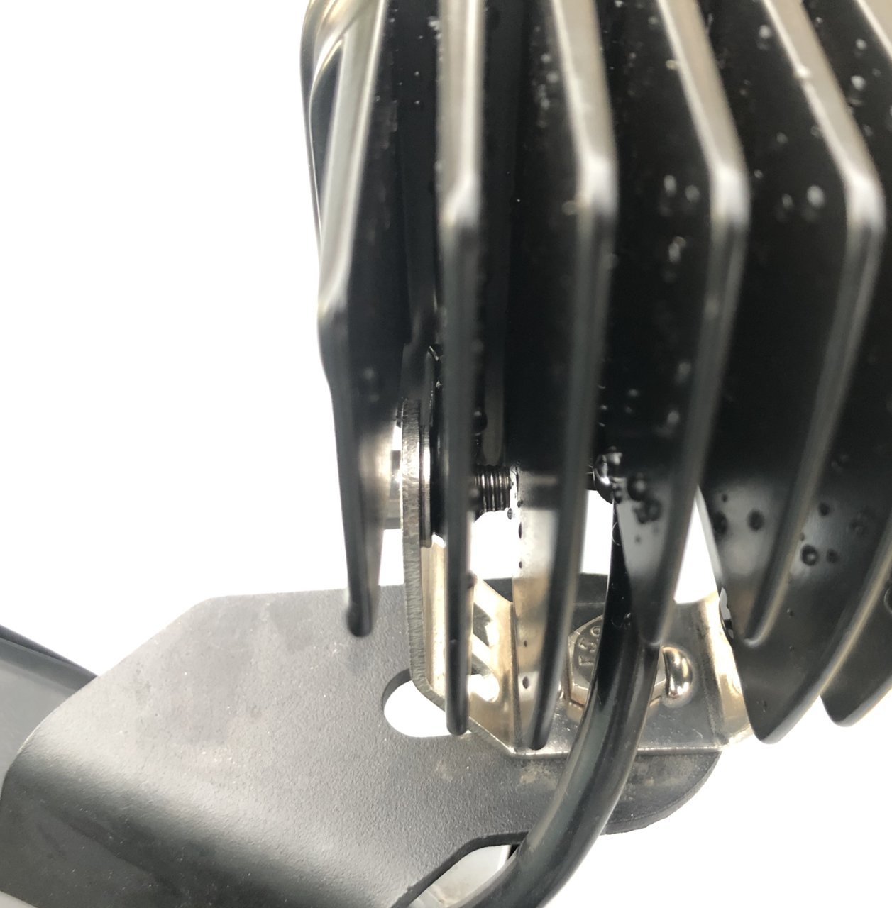

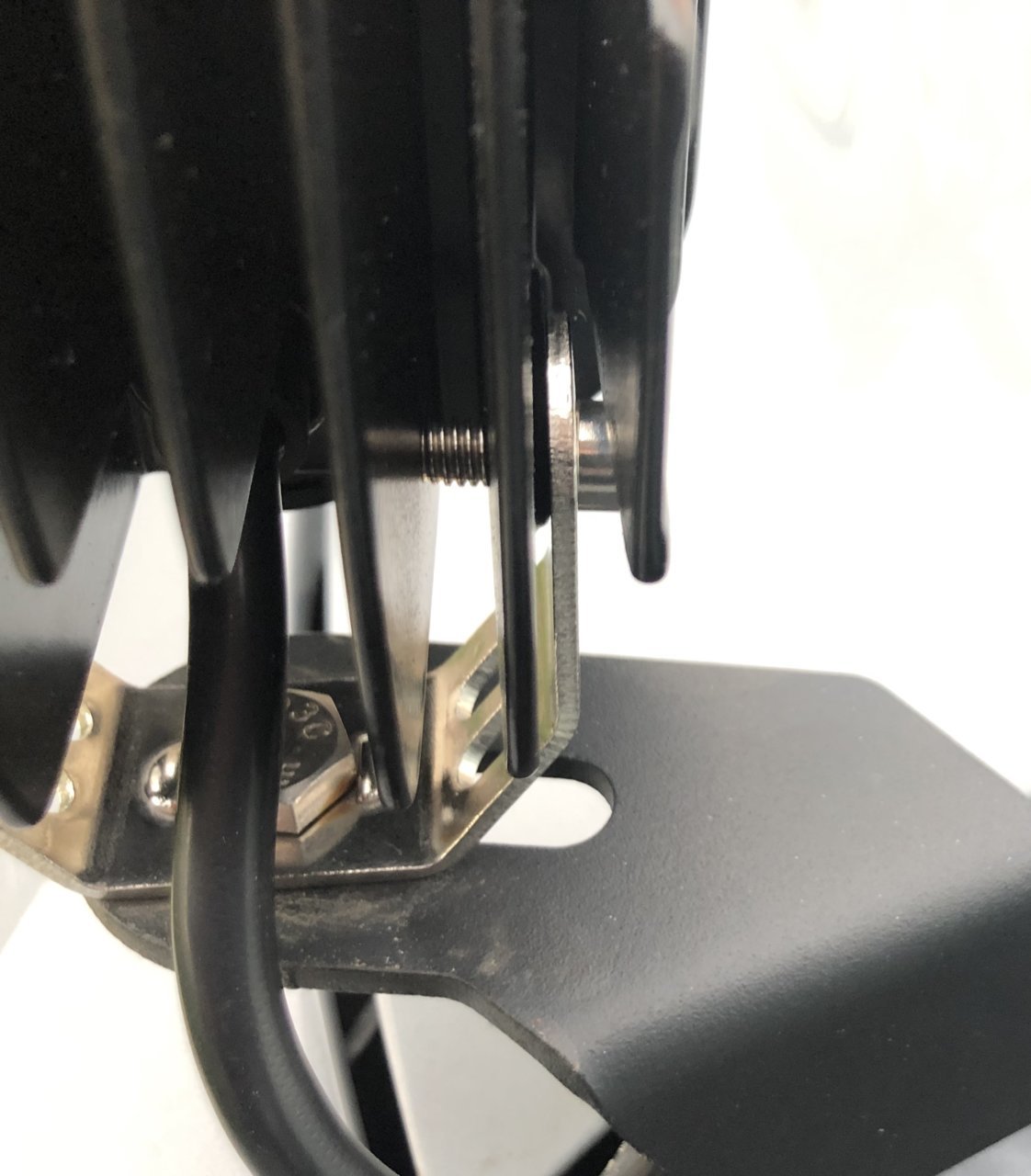

    While mounting the lights, I noticed that they come with all stainless hardware which is great for weather resistance. I had slightly shorter SS bolts and nylon locknuts that I used on my old lights so I reused them to avoid having to worry about the nut backing off. Minor personal preference thing. One minor hardware issue, when mounting the bracket screws into the side of the lights, the screw bottoms out on the next cooling fin before fully tightening down the bracket. I didn’t want the light bounding around at all so I put some stainless washers between the bracket and light housing then inserted the screws. A better fix for this would be to simply grind down the screws or use screws that are maybe 3mm shorter. Squeezing those washers in was a little tricky, it’s a tight little space but it worked as you can see in the pic.
    Screw bottoming out
    Washer in place, screw tightened down
    Even in the daylight, against my garage you can easily see the DDS4’s shine, not so much with the Auxbeams. My friend @Tacomasprime05 and I looked at them head on in the daylight and again, it’s not even close. I think he said something to the effect of “holy... what do you need those for?!” Haha
    The Auxbeams are a more focused, higher temp (more blue) light but light output isn’t even close! I love the spot pattern of the DDS4’s. They have a nice strong hot spot and plenty of spill over to light the surrounding area, and really good throw. The tree line in the distance in my nighttime pics is about 175yd.
    Auxbeam 3” 20w pods, no headlights (tried aiming different ways, didn’t make much difference)
    DDS4 pods, no headlights
    I think the pictures speak for themselves. I’m all about “bang for the buck” so I’m not the guy who is gonna spend $350 for a set of pods when I’m not desert running; I go for the best blend of cost and performance. This showed me hands-down that the DDS4’s offer a ton more performance for about +$95 ($130 vs $35). Honestly, I think the ~$100 price point is a sweet-spot for pods, though there are very few options there for some reason. On paper, these match Baja Designs Squadron R’s which are 3x the price!
    Thanks again @blondi.josh for offering these lights at such a great price point and for the recent deal!

    Bracket screws should be maybe 3mm shorter
    I’d prefer a nylon locknut for the mounting bolt
