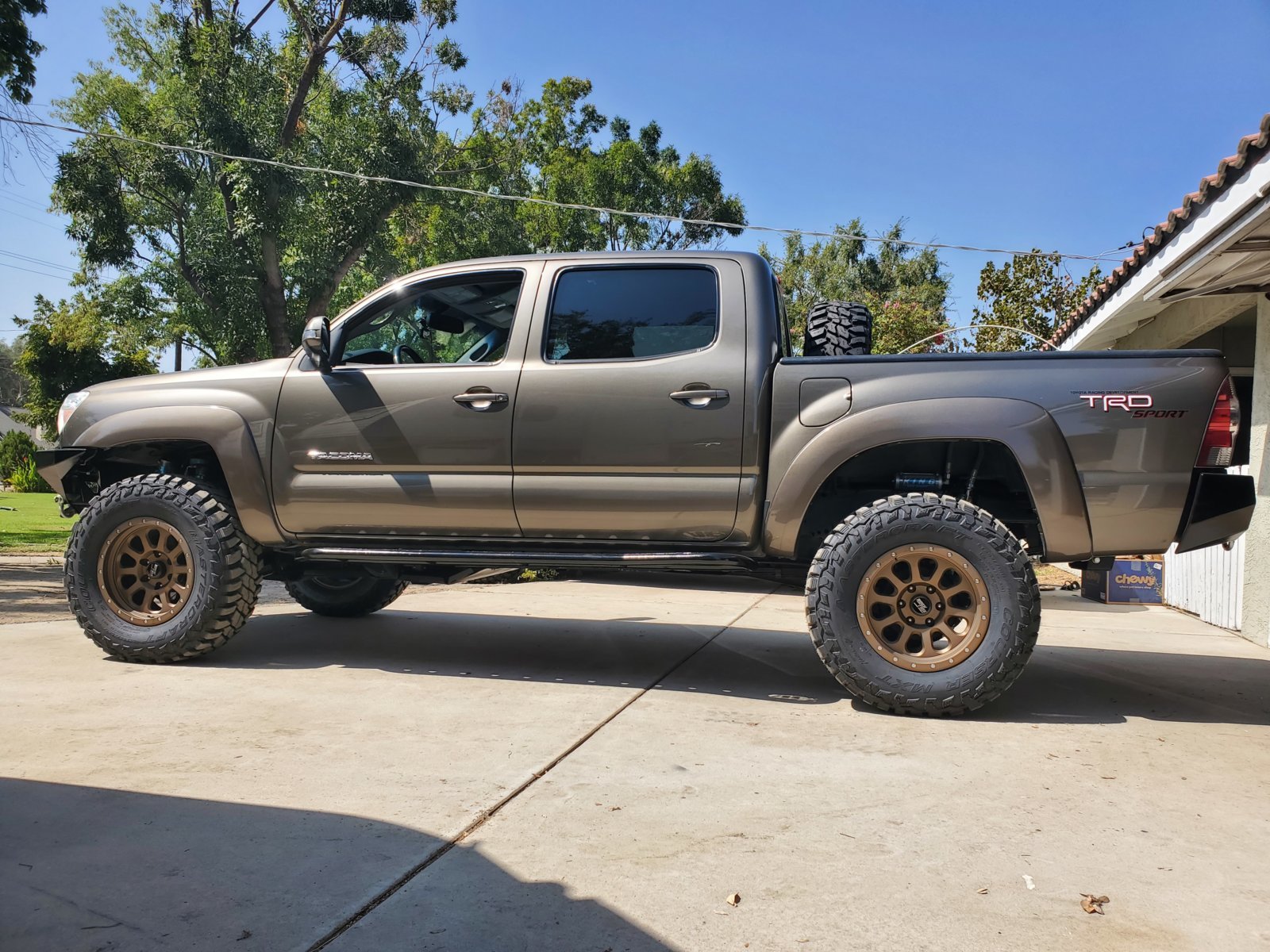

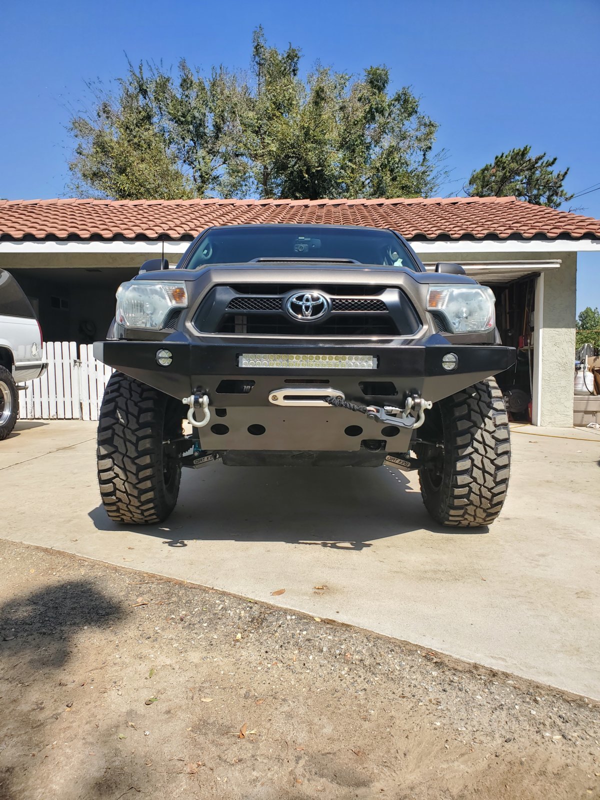

    Axles coming out of the TC, I need to see this, maybe I have been doing it wrong this entire time. My trucks lifted and has 68K+ miles on the original CV axles with no problems.
