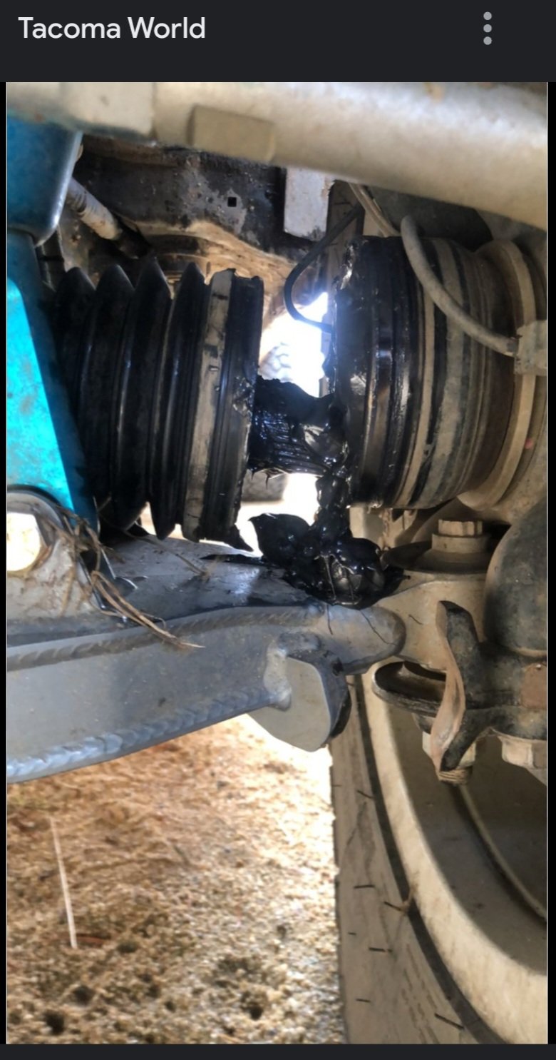

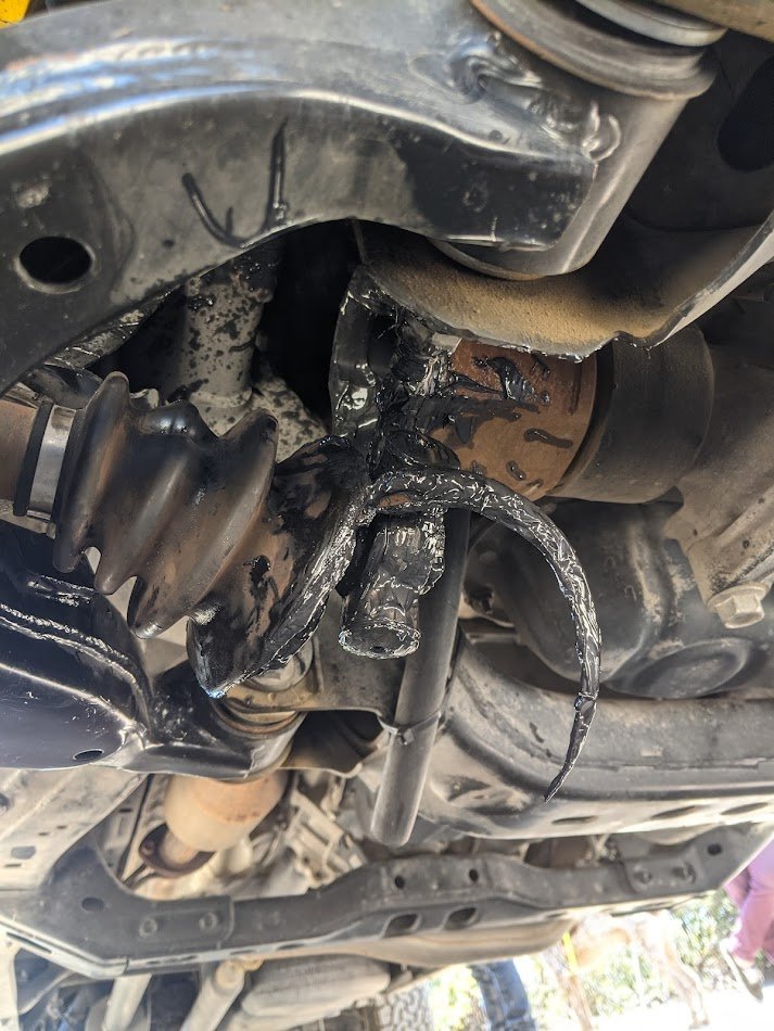

    Op, here's what losing a CV looks like, it's destroyed.

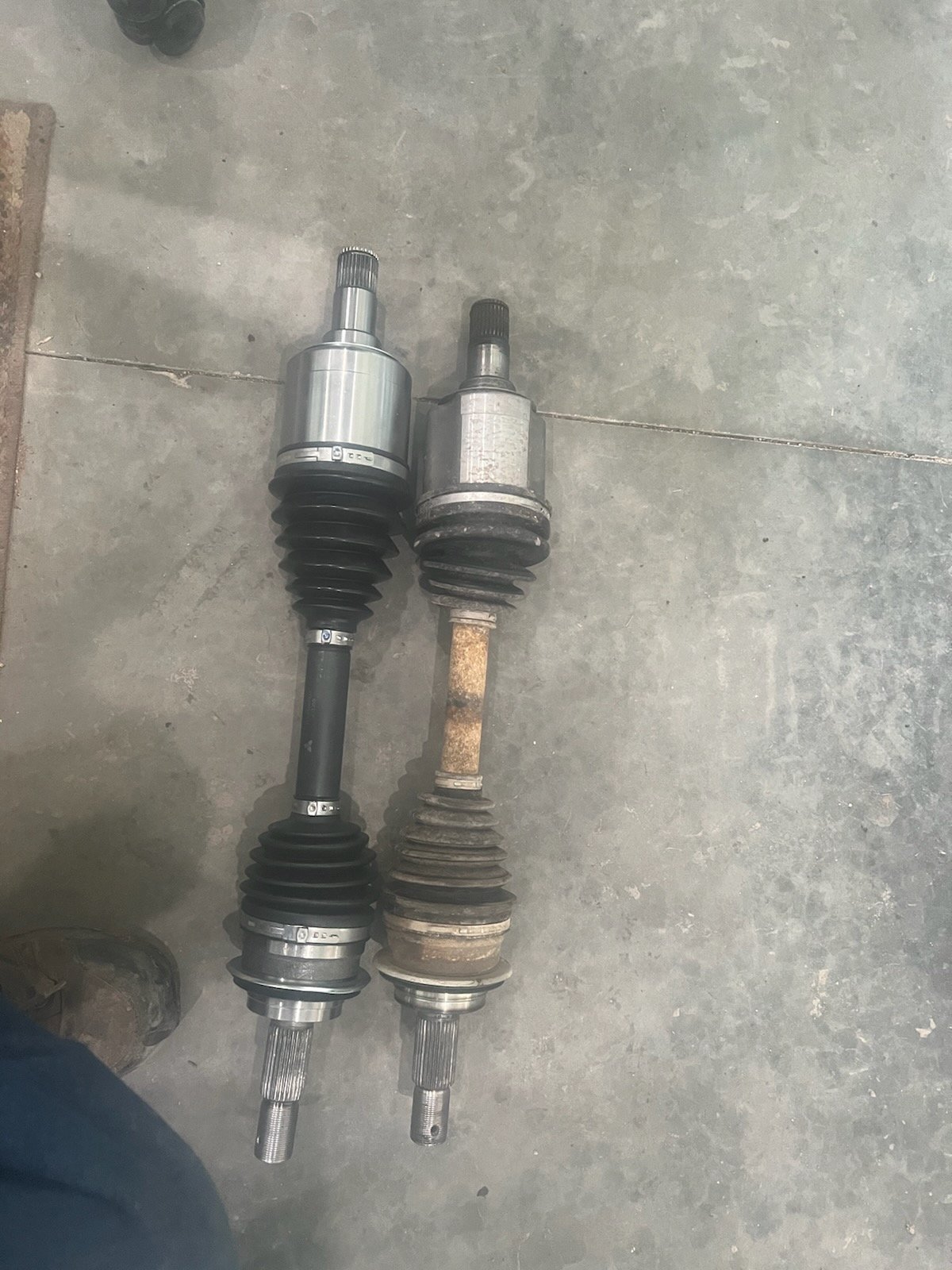

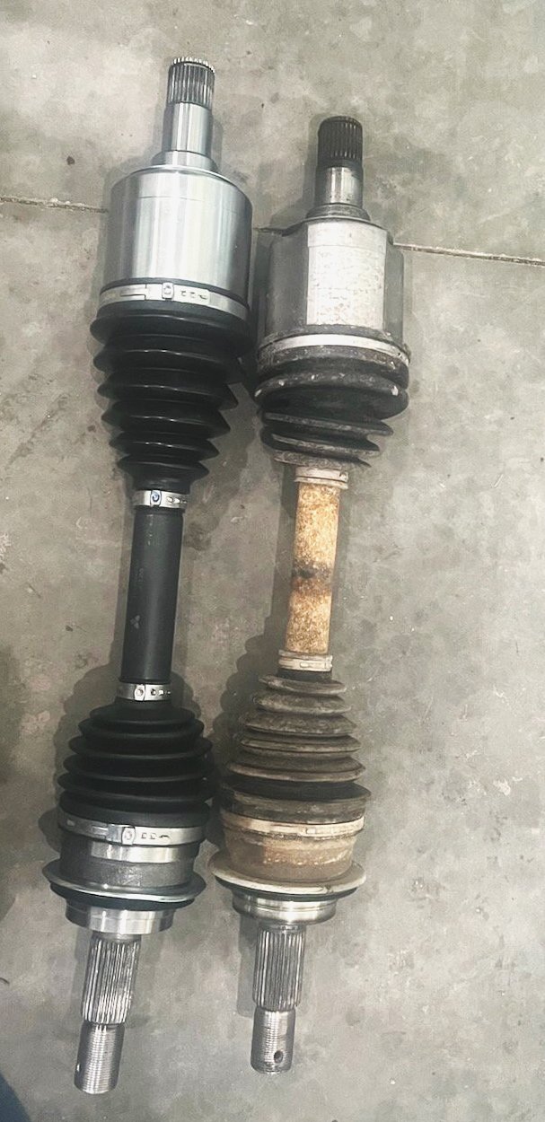

    So here is the photo of the new and old CV axles. The one on the right of course is the NAPA axle that came out of the differential on the passenger's side this time. The new axle was one the mechanic ordered so I am not sure who made it but apparently, he has had good luck with these. It does look longer to me. What say you.

    ^The inboard CV joint has some telescopic travel, so you have to physically compress the axle and measure at the shortest point.
    The new axle is built with entirely non-OEM parts. The Napa axle inner joint is non-OEM also, judging by the absence of chisel notches.
