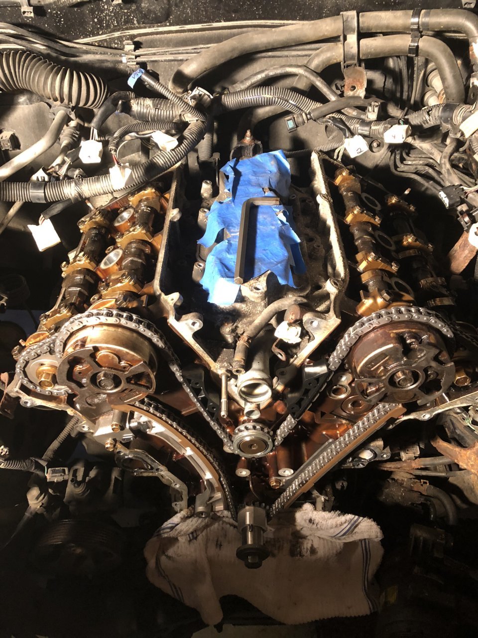

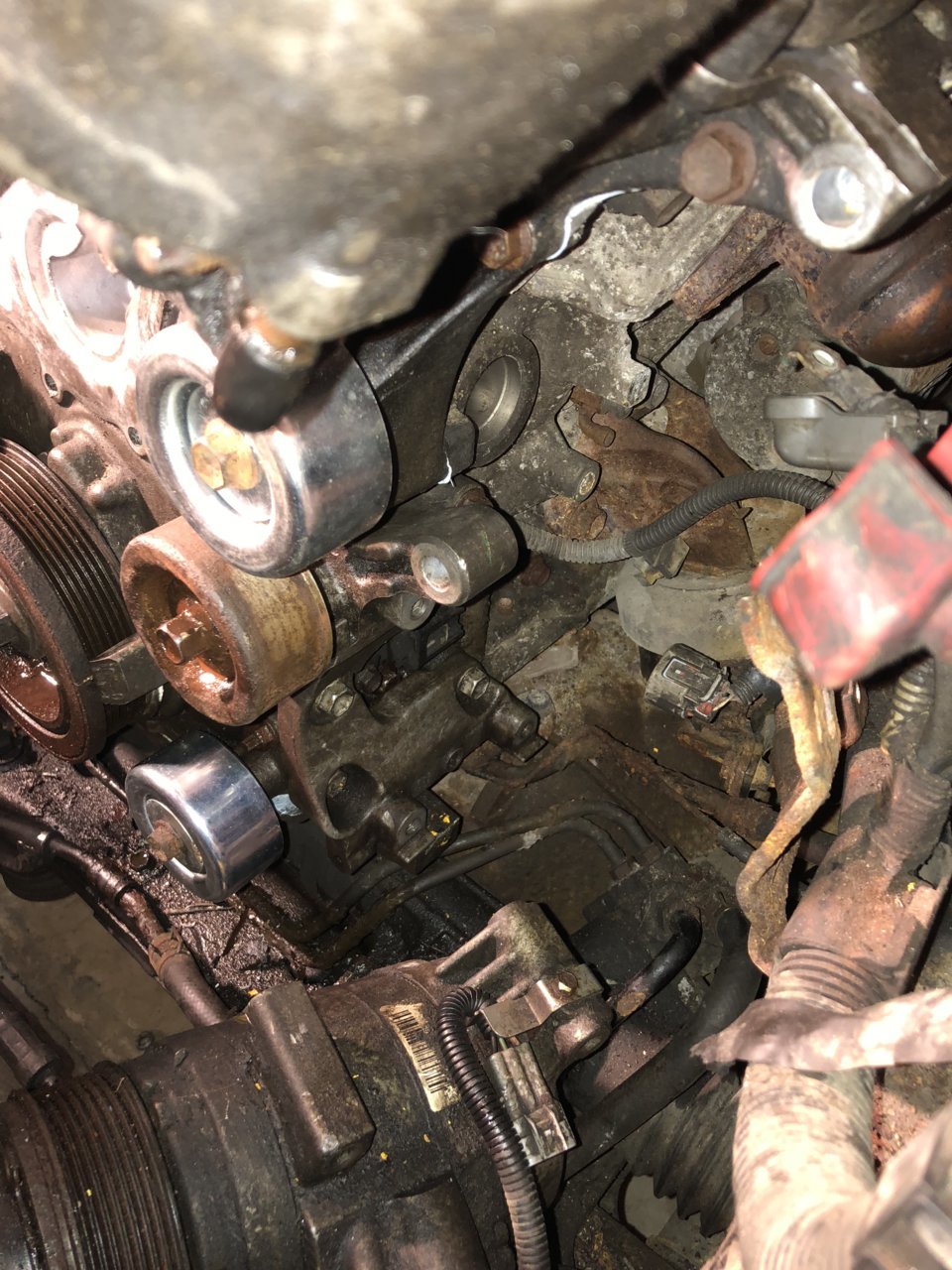

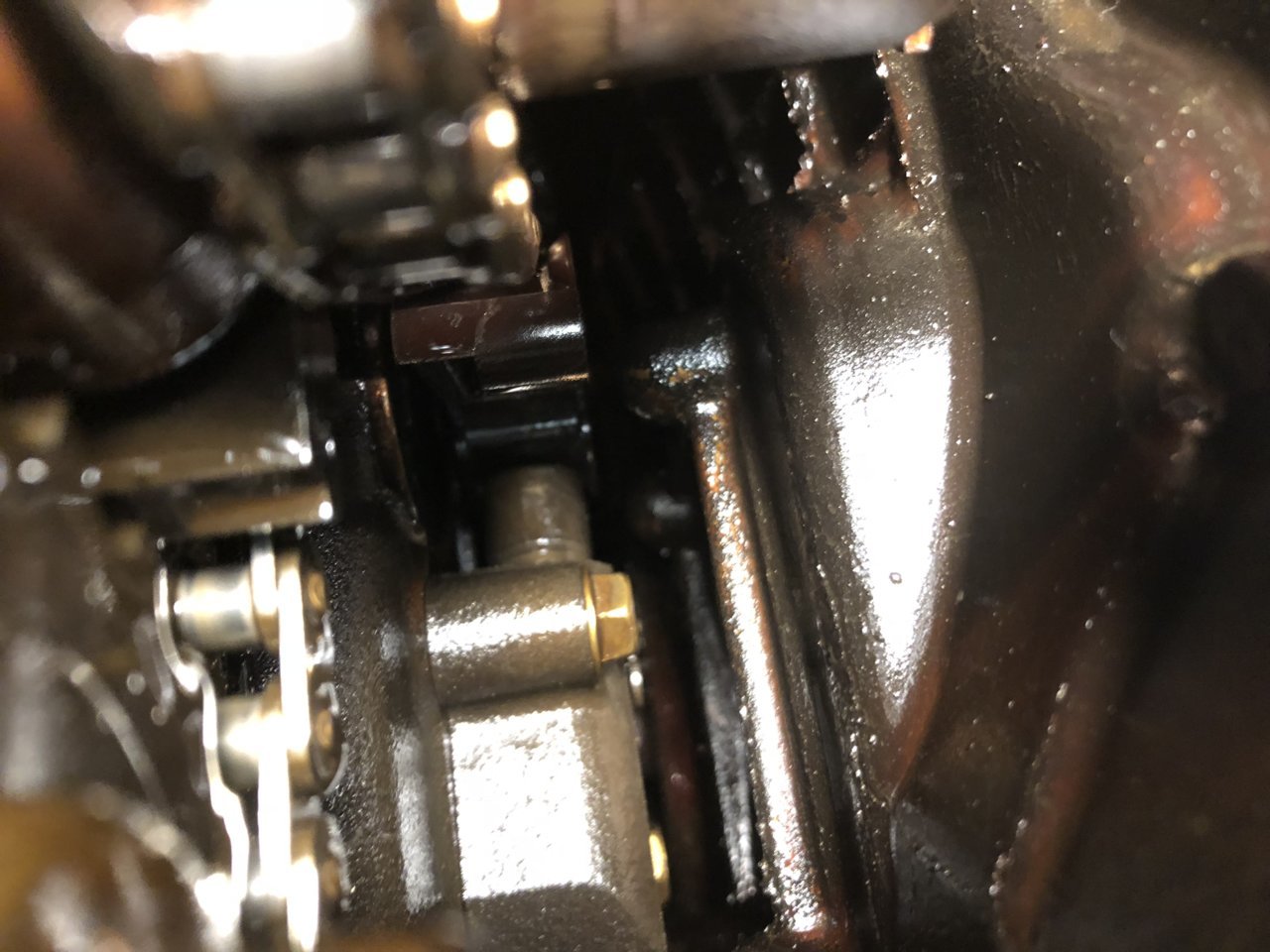

    Tensioner all the way out. From what I can tell, cams are off too.
    Looked like the gasket was starting to leak @ the water pump.

    Your in pretty far. Looks like you've got a good plan by the looks. That gasket is def torched. How does the oil look? Just thinking about the heads.

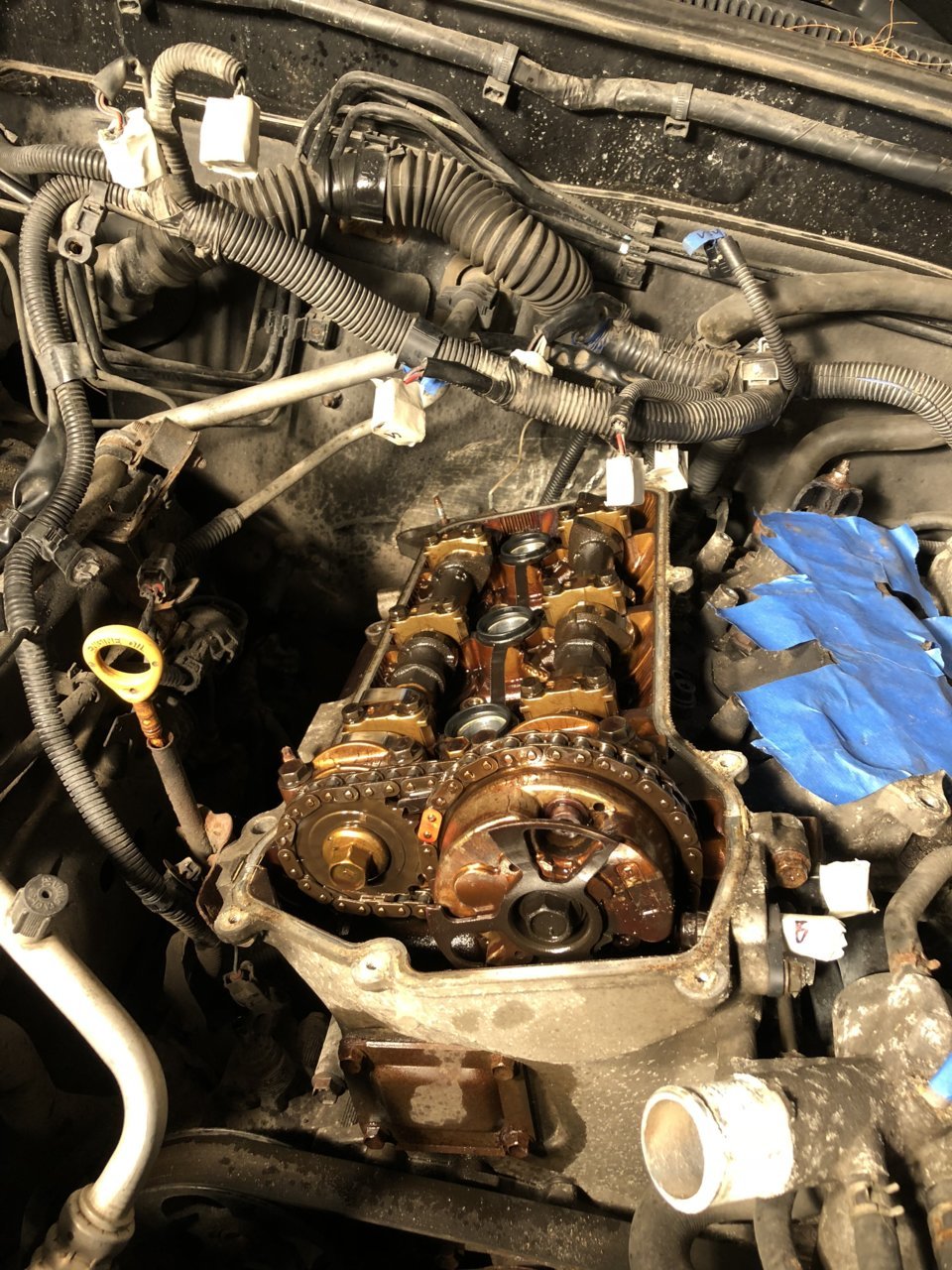

    FE0AB935-1CB7-476A-B282-4837B9441C91.jpg FE0AB935-1CB7-476A-B282-4837B9441C91.jpg Alright, another successful day.
    Accomplished most of what I set out to do today. How often does that happen? Not very, that’s how.
    • Successfully Removed (2) the stuck AC compressor bolts from the tensioner. Multiple soakings of liquid wrench + vice grips + muscle.
    • Removed the stuck VVT sensors from the motor. These were almost impossible! Top broke off, had to hack away with whatever i could find to grab on to. Can’t believe I got em.
    • Removed stuck bolt from the intake manifold! :frusty::goingcrazy:
    • Mounted belt tensioner, new idler pulleys,
    • Reinstalled valve covers, ignition coils,
    • Mounted the oil pump.
    • Ordered new bolts for the AC compressor. Picking em up tomorrow am
    One piece I have been struggling with is getting the harmonic balancer / crank pulley back on. kits from Autozone nor Pep Boys have the right size bolts for it.
    I am gonna go grab some from the hardware store and make my own SST like I’ve seen some guys on here do.
    What are they 7 mm?
    Frickin ridiculous.
    Got all the last parts I need showing up in the mail tomorrow - water pump, new upper air intake manifold, VVT sensors and timing chain cover gasket showing up tomorrow.
    Will try to get a new balancer gasket too while I’m at it locally, and some other O rings and things.
    Neighbor is coming over tomorrow to help too. Hope this thin runs right when I get it back together. There were some metal flakes I discovered in the oil that came out of the oil pump...

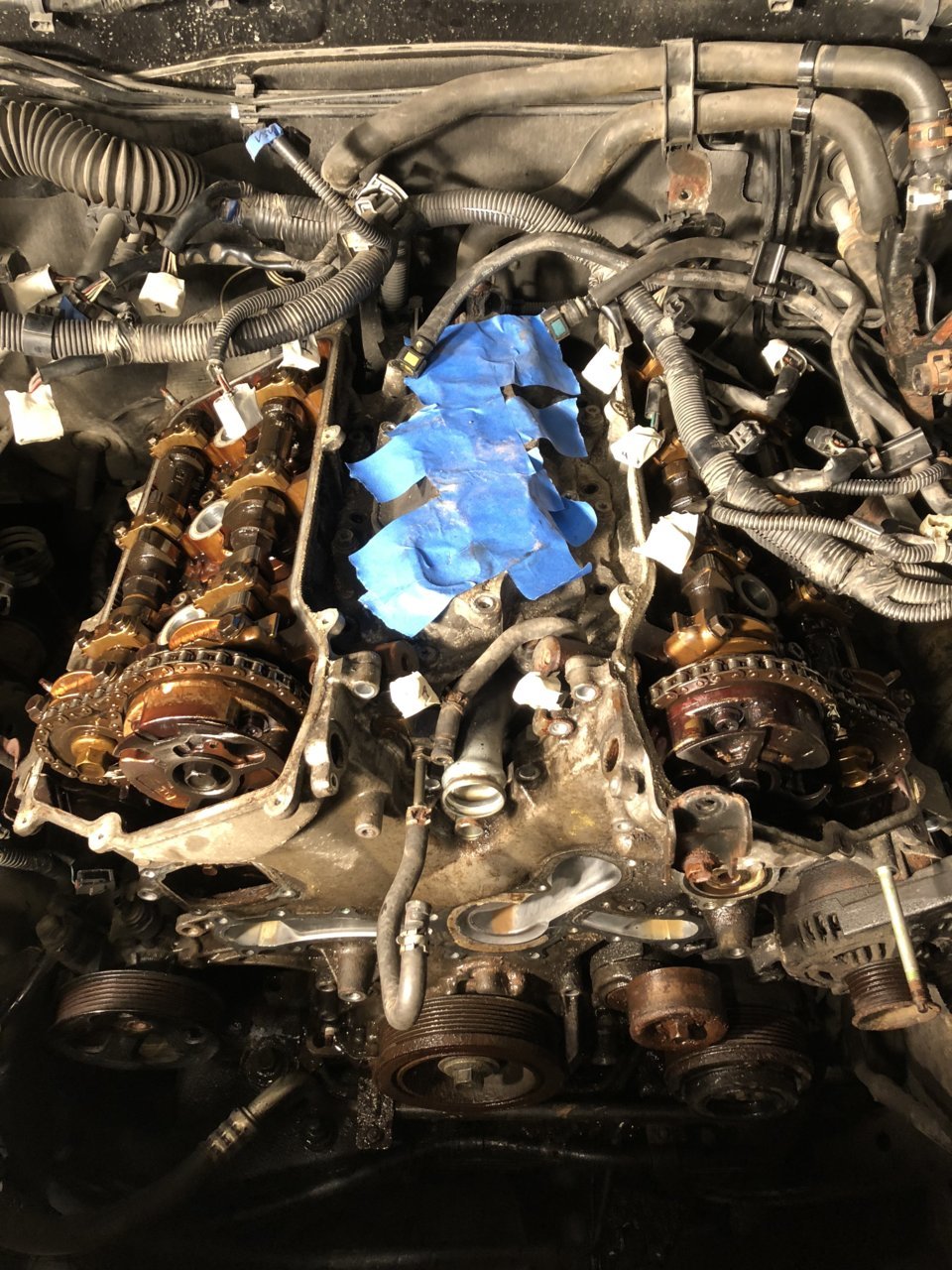

    Alright time for an update. I’ve been hard at work the last few days reassembling the motor.
    Got new AC compressor bolts yesterday from the dealer, along with some other goodies; new crank pulley gasket, oil pan gasket.
    Yesterday tried to crank down the crank bolt, and broke the timing mark off the block! :censored:
    JB Weld to the rescue...
    Got the new water pump on, alternator back on, lower air intake manifold, air cleaner assembly, wiring all hooked back up, brackets, etc.
    Started her up today. Timing is fixed!
    Started right up with a jump, 1st try.
    But, still running rough. Seems like it’s not firing on all cylinders.
    Checked the codes, and getting:
    • P0300 - Random misfire
    • P0304 - Cyl 4 misfire
    • P0305 - cyl 5 misfire
    • P0306 - cyl 6 misfire
    So, it seems I may have two blown head gaskets.
    The code reader’s recommended fix: replace head gasket.
    So, I’m looking at diving back in to the block again. deeper this tim3.
    Or I may try the Blue Devil..
    we’ll see.
    But at least I got Er started back up and she runs!

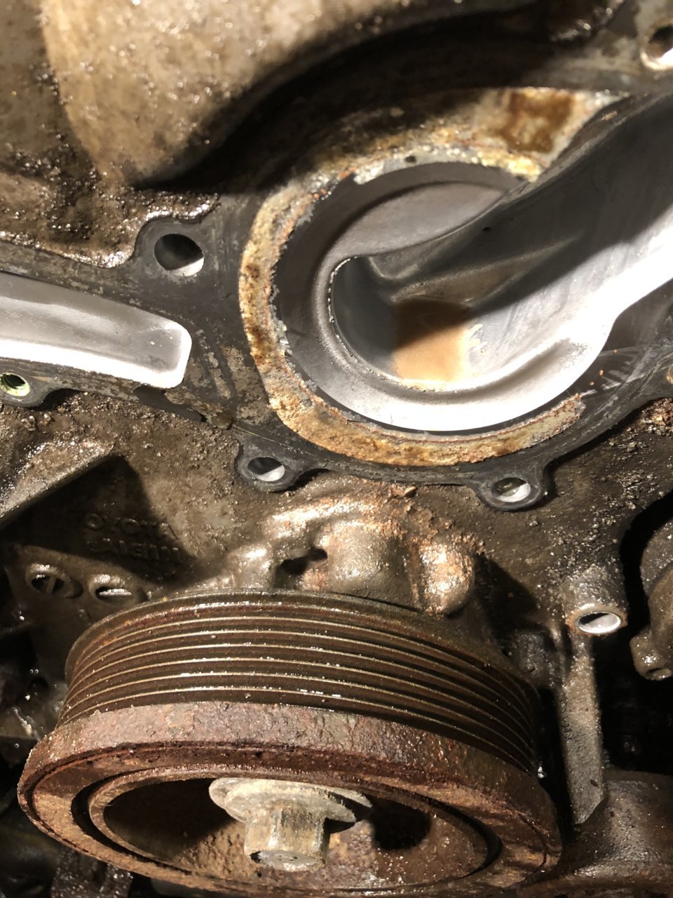

    New year update.
    After asking the Tacamaworld gurus here, and consulting with the Mrs., ive decided to replace the headgaskets. Not going to try and use the Blue Devil or anything. Gonna do it the right way.

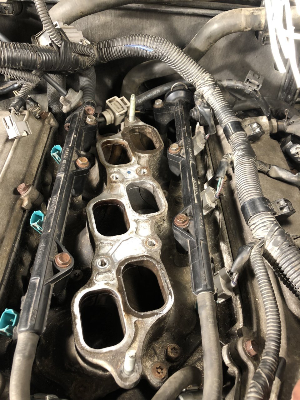

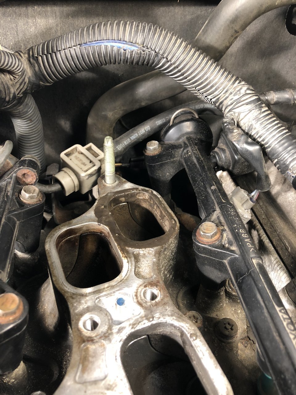

    Started er up again yesterday. Shes belching white smoke pretty bad. Mover her to the other side of the garage, and she died 1/2 way in and wont start up again.
    So, i guess im not closing myngarage again anytime soon... doors 1/2 way down over the bed w the cab inside. Good enough.
    Started ripping er apart again. Got the upper intake manifold off and it looks like theres nasty grey sludge coming up from lower air intake. Consistency is grainy, like dirt! Gross.

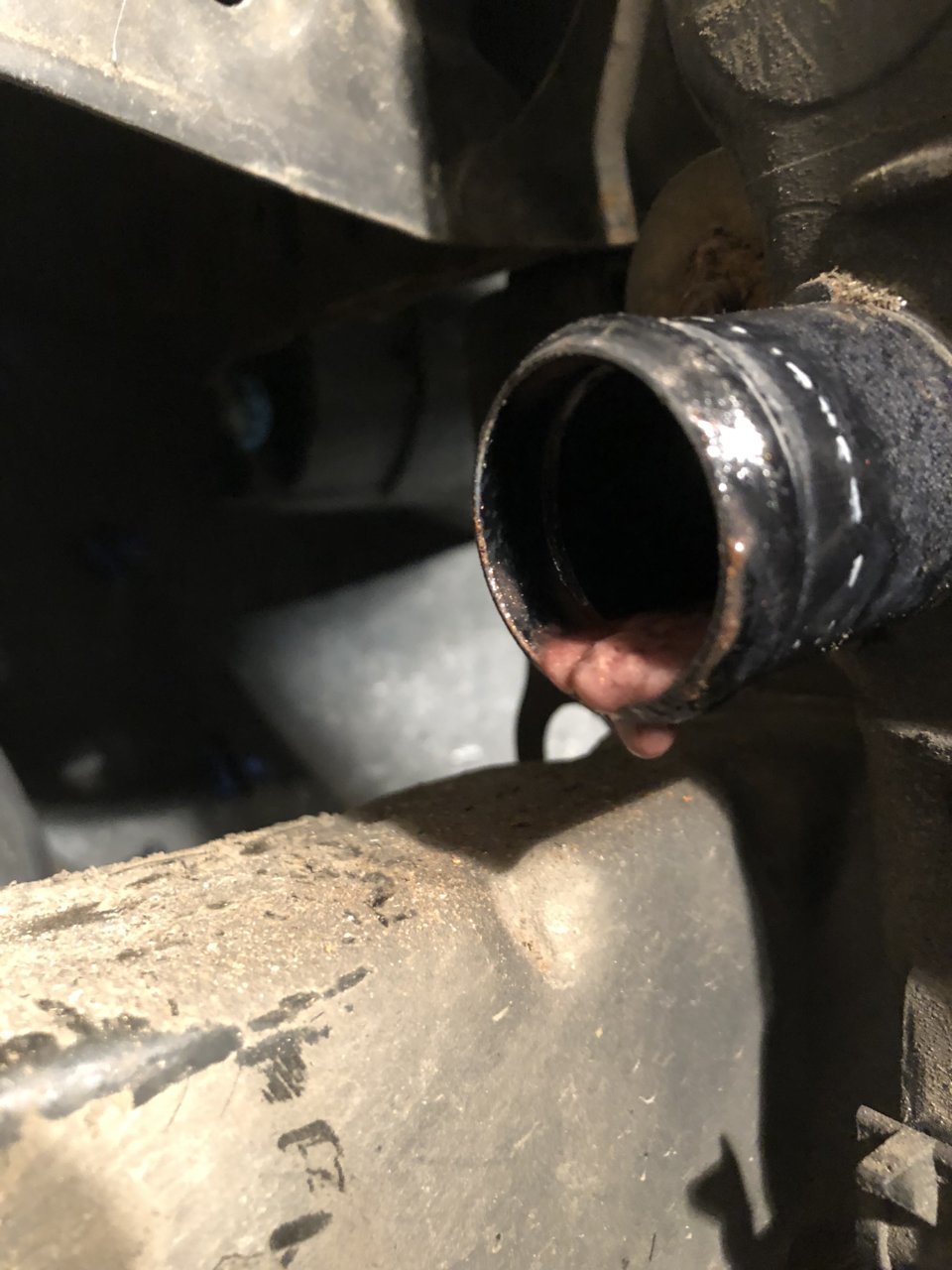

    Could see beads of moisture in there too.
    There was also some nasty build up of coolant snot in the radiator hose..? No bueno.

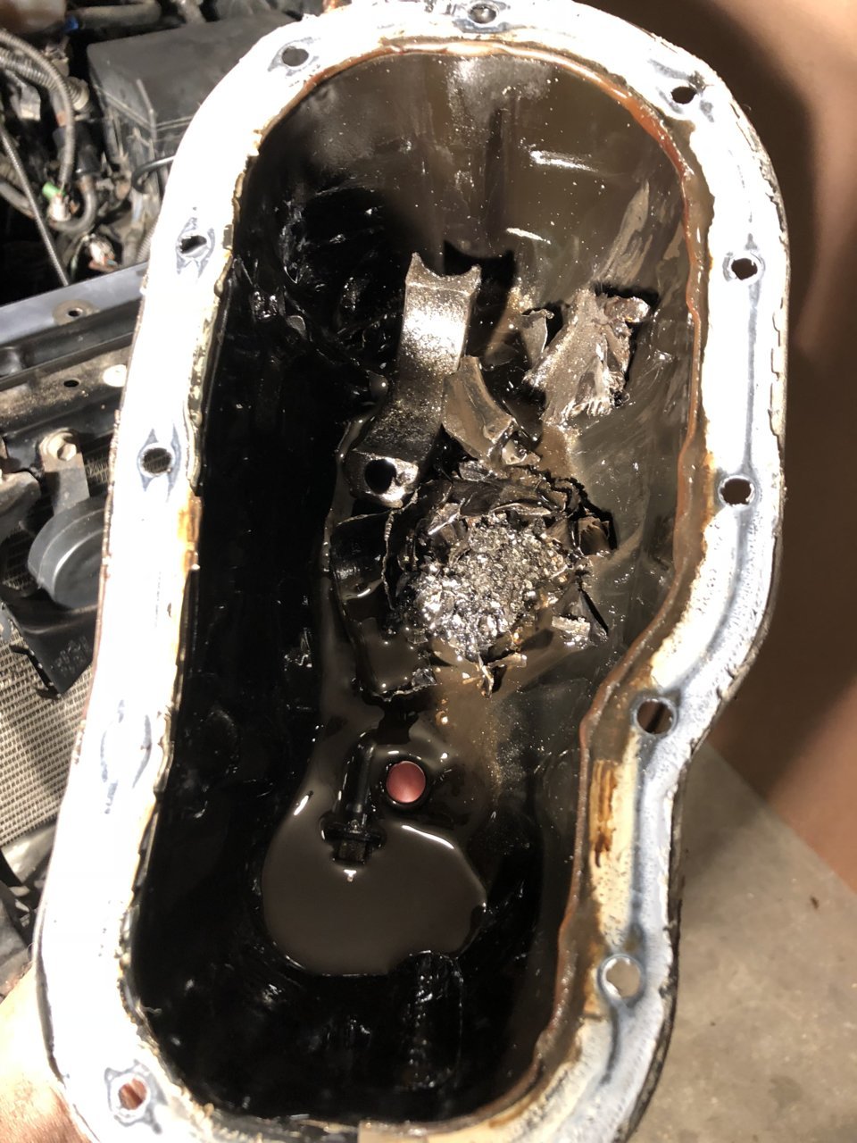

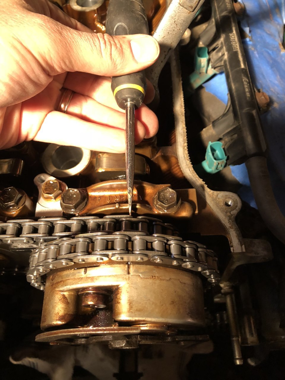

    Motor is toast!
    Should have dropped the lower oil pan 1st thing. I had read you have to drop the axle to get the oil pan out. But, I did notice at some point this week that you can get the lower oil pan out without doing so.
    Took it off today and found some serious shrapnel in there.
    Piston bearings were shredded. Ugh
    Had already started ripping into to it to pull it out today after I couldn’t get the exhaust gasket bolts off.
    Just wish I hadn’t spent so much time trying to fix it already.
    oh well. Good experience I guess.
    I’d already started shopping for used engines couples weeks ago when I originally thought it was rod knock.
    Got a line on a good one in NH w 100k mi, and some refurbed like new ones on eBay for similar prices. $2,200 - $2,600.

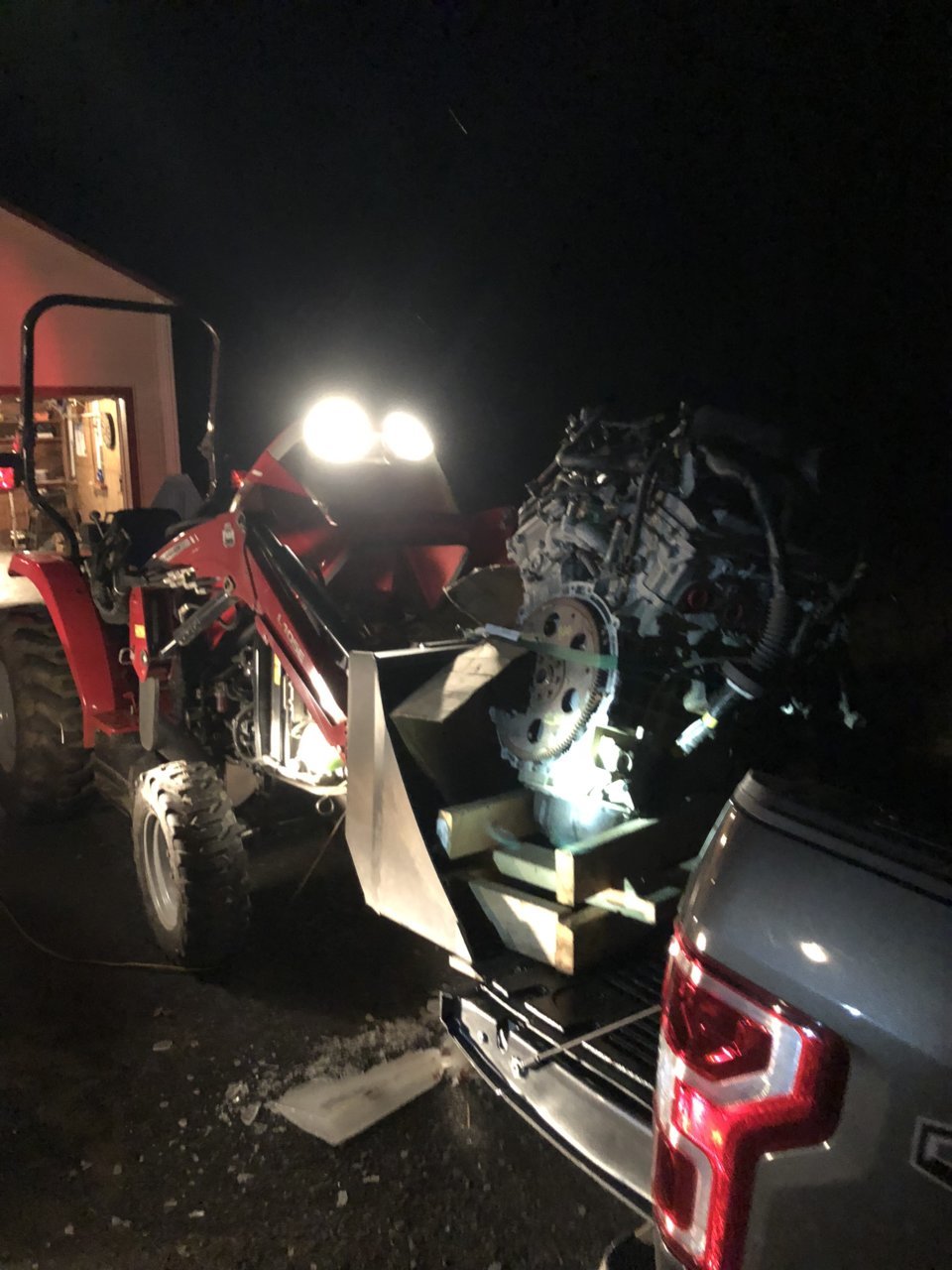

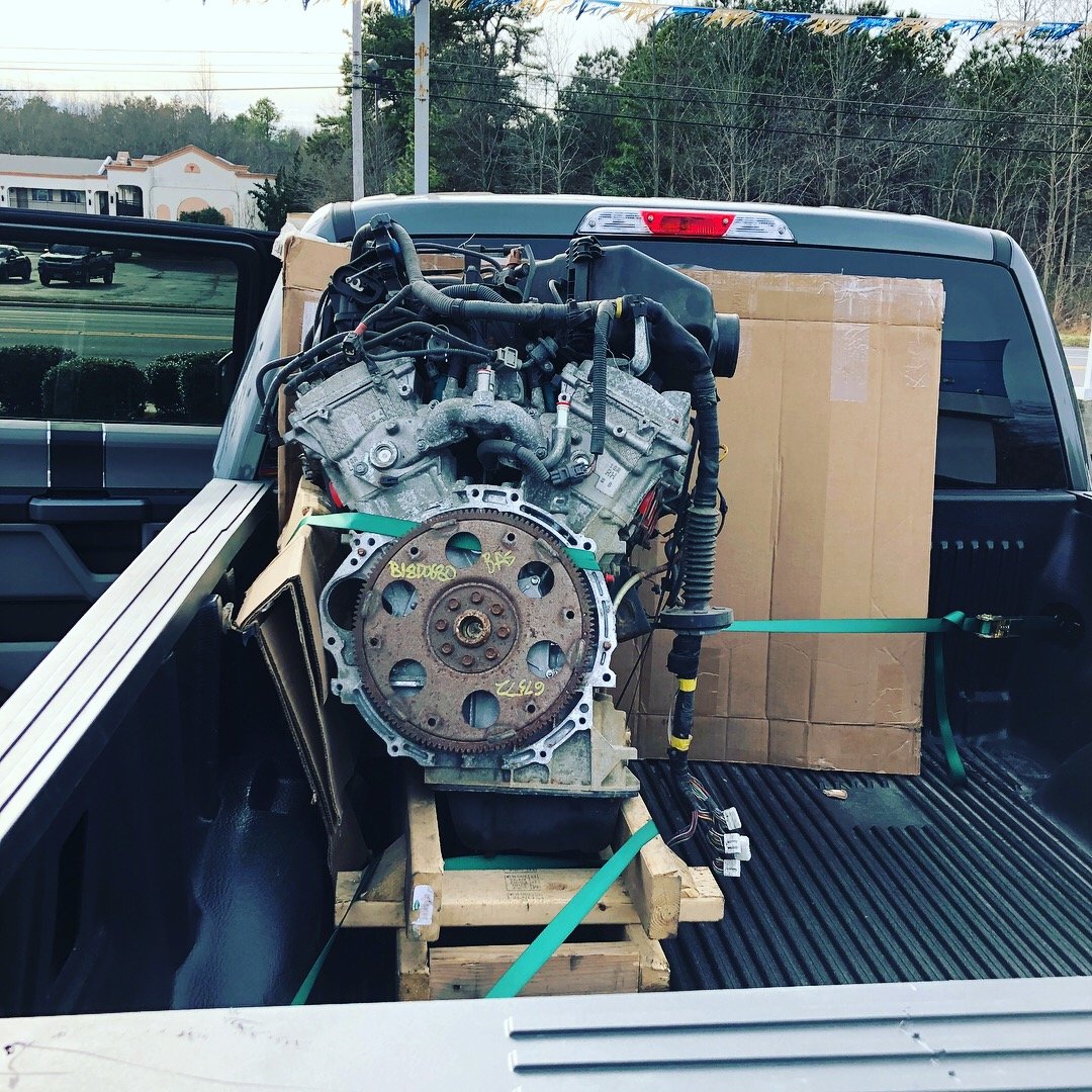

    Picked up an engine today in NJ!
    Ready for a motor swap this weekend.

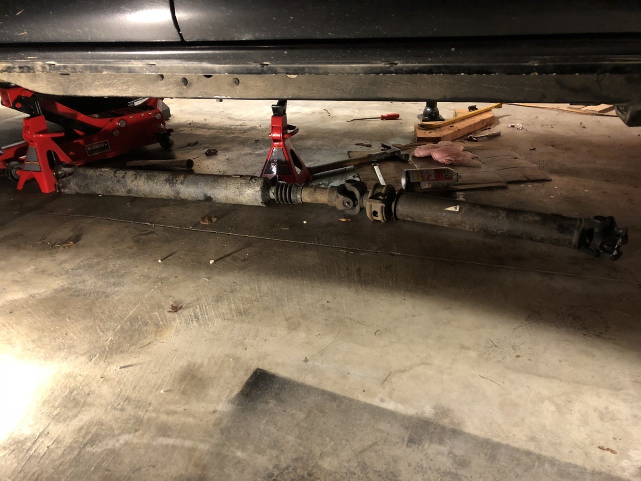

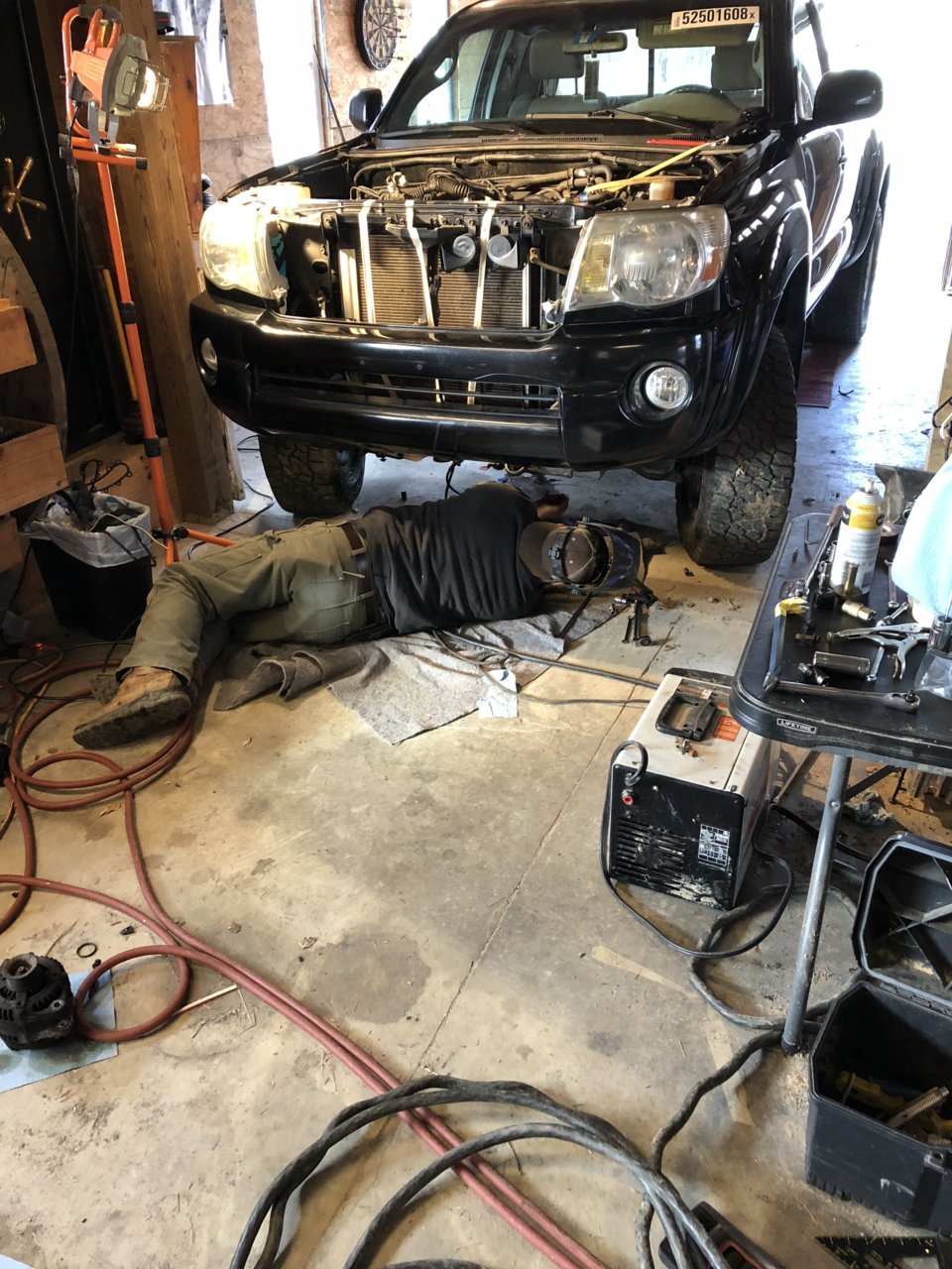

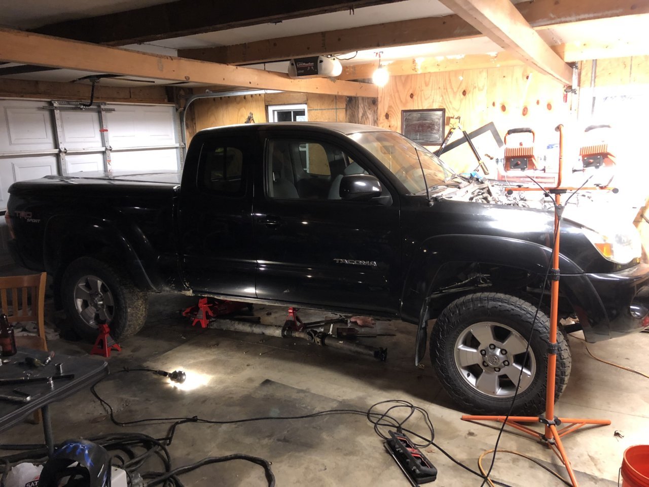

    Got the drive shaft out today. Had to get some tools first. Was stuck on pretty good.
    Got the bolts out of the frame crossmember.
    Gotta take the exhaust Y-pie off tomorrow, and a couple more bolts out of the fly wheel housing and I can drop the trans and then pull the motor tomorrow hopefully.
    Truck is all the way back in the garage again, thank goodness. It’s 38 degrees here during the day.
    Want to get both engines sitting side by side once out to see if there’s anything that’s different / missing before I put the new one in.

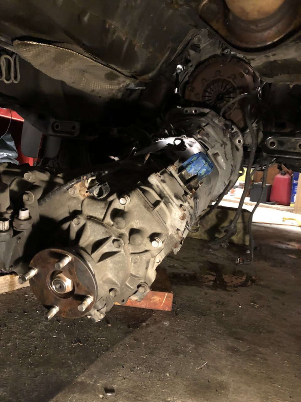

    Trans is out! Ready to pull the motor
    Man that Was a B*tch!
