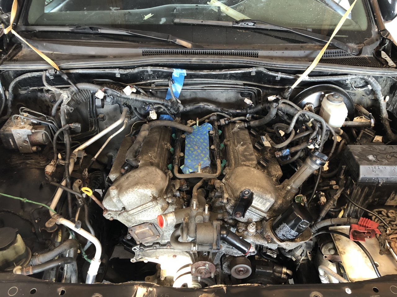

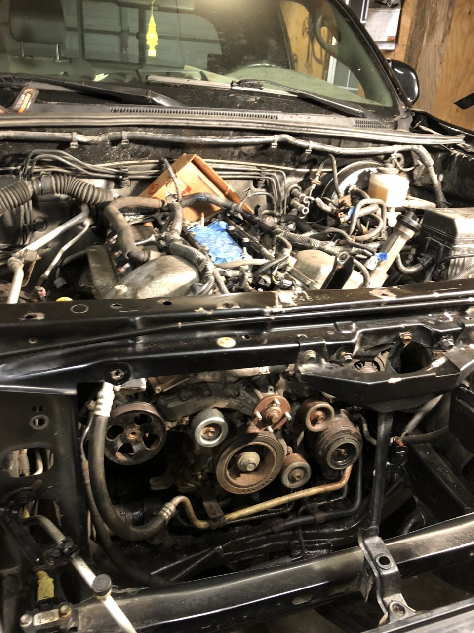

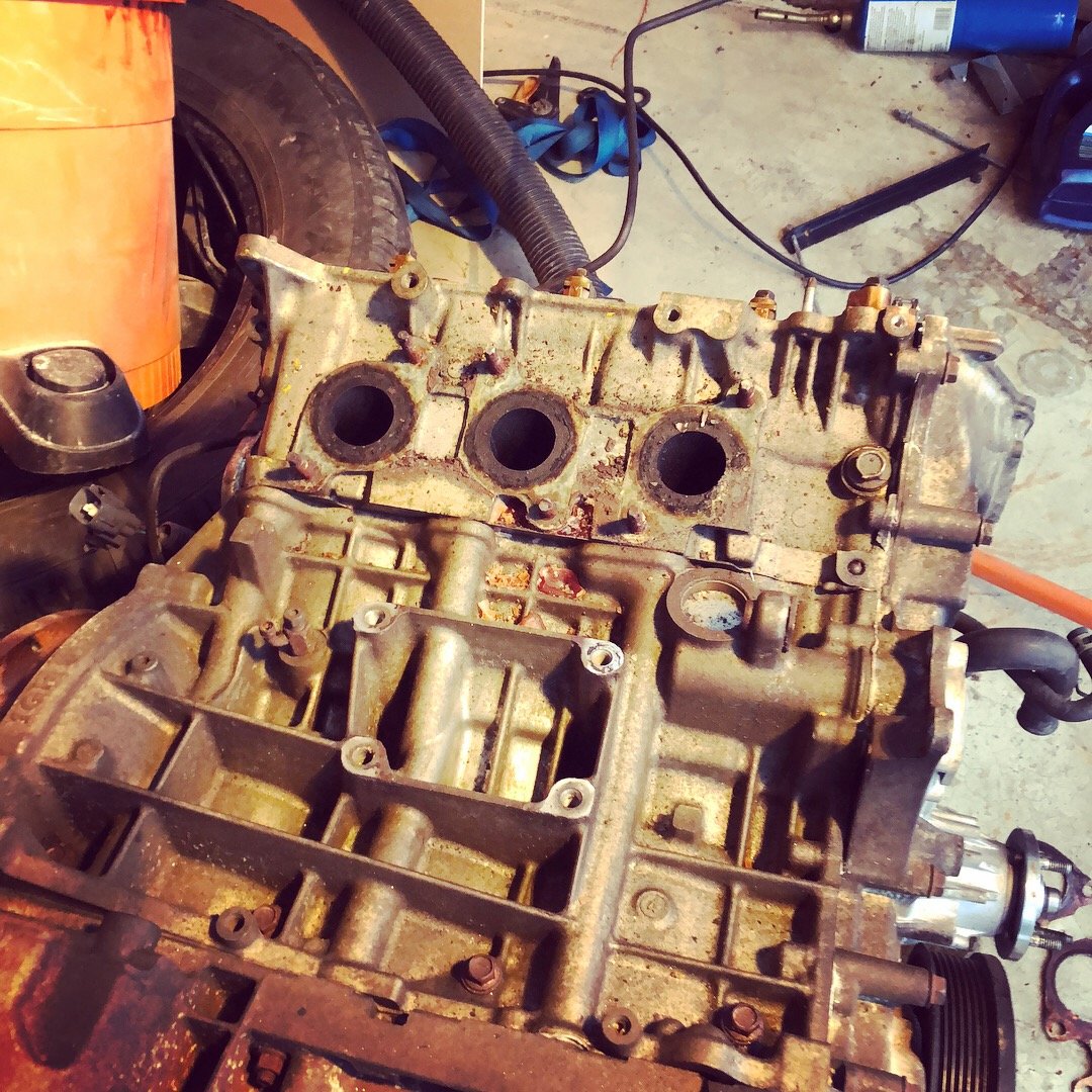

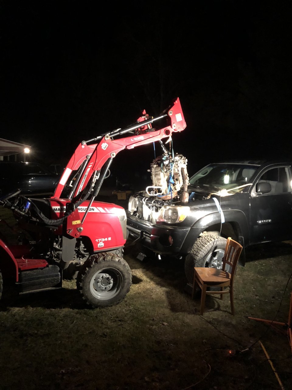

    D952A494-373A-4A7C-87E9-96DD5CCE581D.jpg Motor is out! Wasn’t pretty, but it’s done.
    Damaged the AC condenser and Frame crossmember in the process... :(:mad:
    but it’s done. Truck is back in the garage.
    Time to move on the next step.
    Got both engines side by side, will check which parts are missing or should be swapped from old to new.
    Have to order some new exhaust manifold studs and bolts.
    New clutch and pressure plate. Clutch master cylinder, and some other knick knacks.

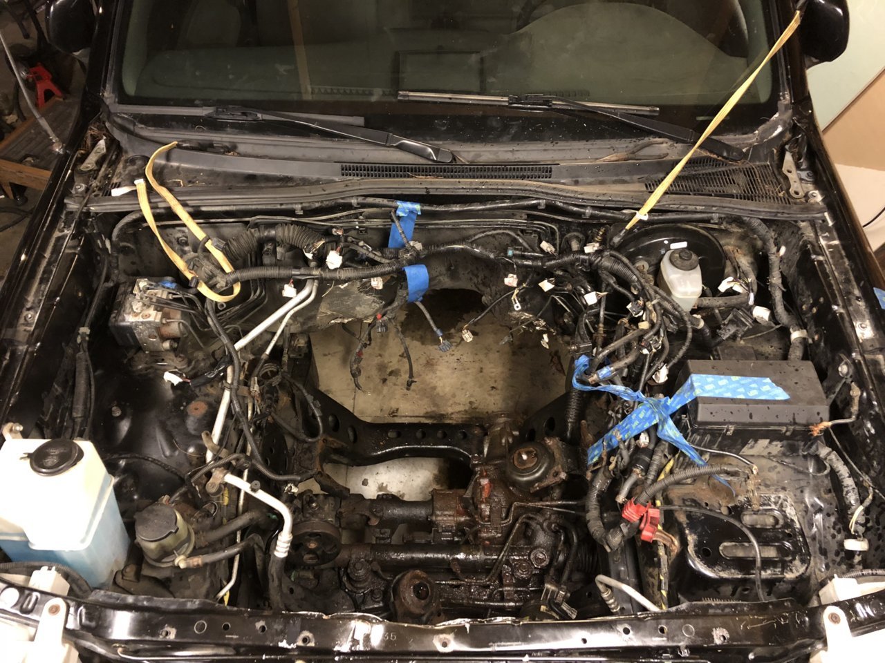

    Tried to take the exhaust manifold off this weekend, but theres a couple bolts that are reeally stuck.. so, I took off what I could off the old motor, and started taking some stuff off the new one too to get ready to pick er up and drop er in.
    Removed the air cleaner assembly & upper intake manifold. Removed the wiring harness. And cleaned the block a little bit where the exhaust manifold bolts to the new engine.

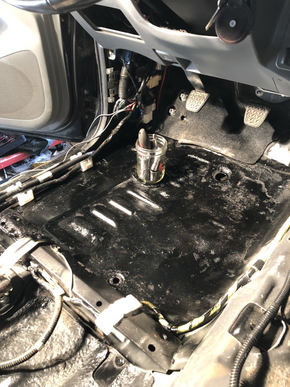

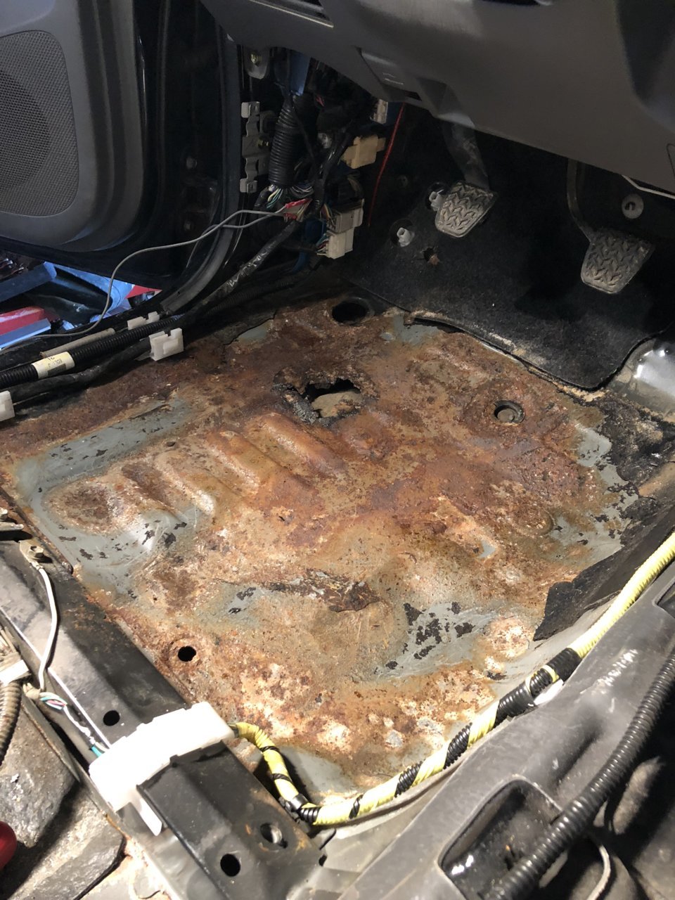

    Pulled the carpet up in rhe whole cab. Was really rusty in the drivers side! Thats why I did it.
    Scraped up the underlayment, rust, hit it w steel wool. Patched a hole with a tin can lid &some liquid nails, and then painted with some black rustoleum paint.
    Will need to replace the underlayment with something. Sound dampening, insulation stuff.

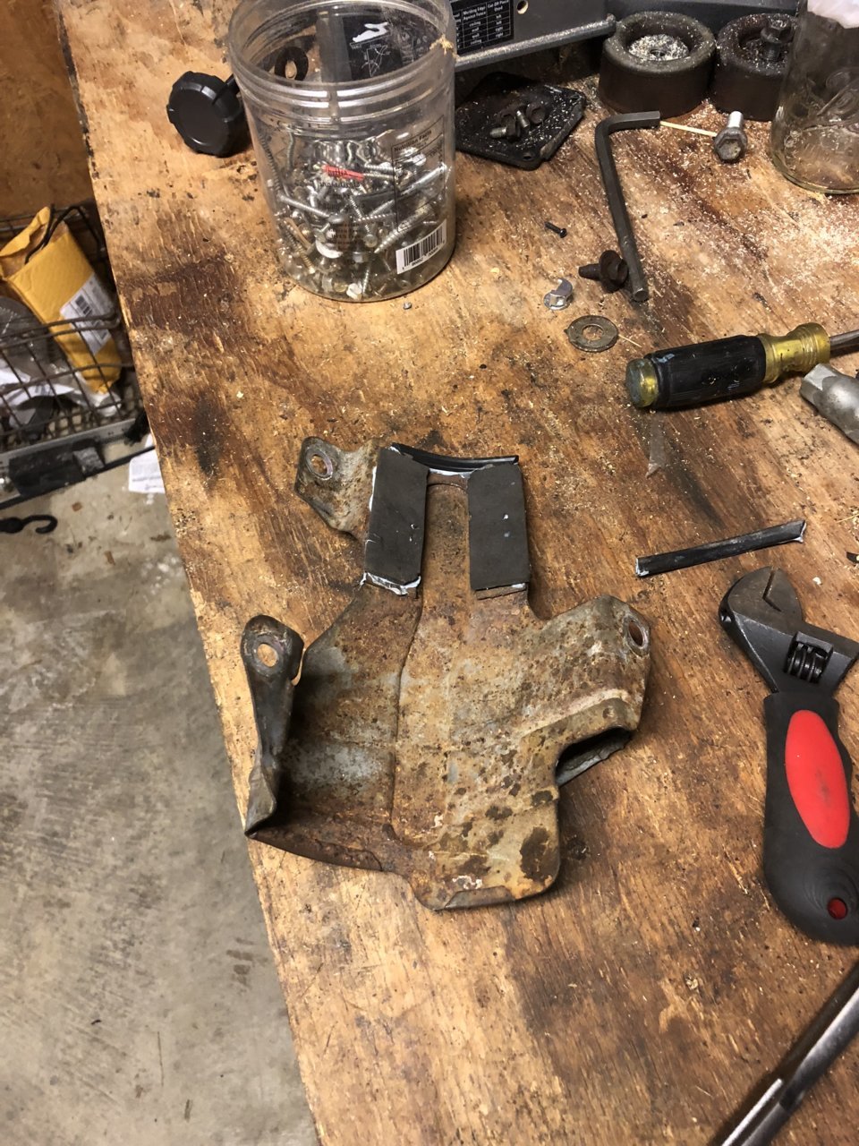

    Meanwhile, used my angle grinder and got the last 3 stubborn studs & nuts off the old block. So I was able to get the old exhaust manifolds off! Now I can reuse them and save a lil dough.
    (At least until I’m able to afford headers..)

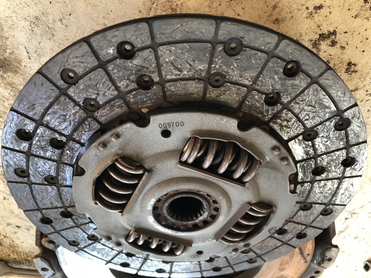

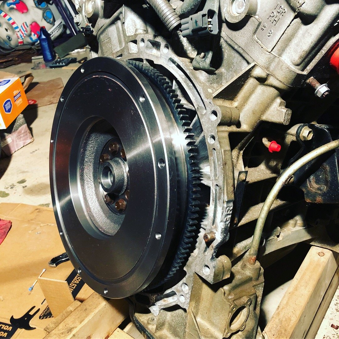

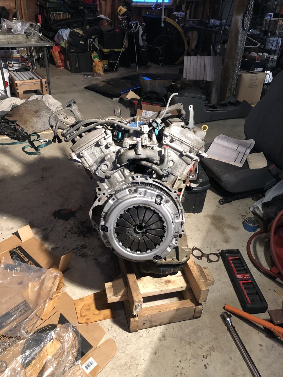

    Flywheel on, clutch and pressure plate are now mounted!
    Ready to drop the new motor into the truck tomorrow 5B776A4A-2DBA-429B-A29B-CF844E532FEE.jpgAF996413-A55D-47F8-A816-E31F914D3C00.jpg

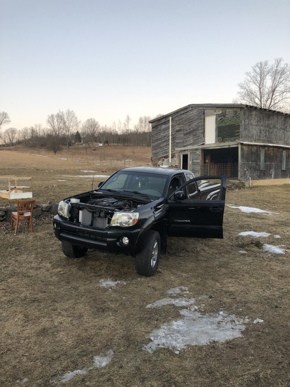

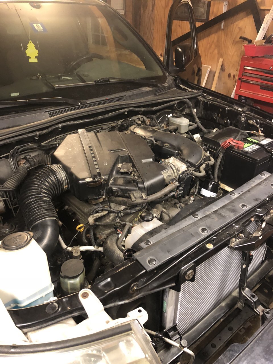

    Got the engine in!!
    Stoked.
    Put the flywheel on Friday night. Clutch plate on Saturday. And now engine in Sunday. Had to plow some snow first, but chained the engine up and picked the engine up w the tractor and it was nicely balanced. Neighbor came over to help.
    Fit right on the mount bolts. Done in 5 min.
    Pushed it back in the garage. Started putting parts back on. Got the AC compressor, power steering pump, starter and alternator on. Had to fix the starter after I broke the housing getting it off the old motor. I used some JB weld and some camo duct tape- so you know it’s good! ;)
    Wiring harness mostly on. Tranny under the truck ready to put in.
    Can’t believe the truck has a power plant again! Turning a corner here.
    See if I can get her running this week.

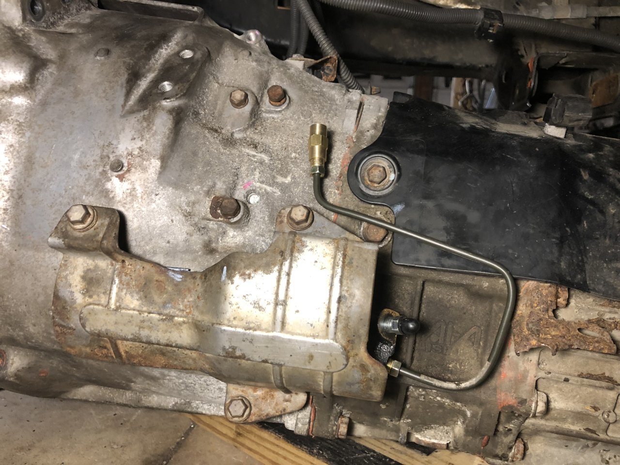

    A0688866-182F-4329-9DF4-08A30F950A7A.jpg 2553E29E-290D-4366-8891-534B04A148E5.jpg EED08CC3-76F1-458E-BE62-8C4EFEF46642.jpg Tonight I removed the accumulator. Thanks for the tips Tacoworld!

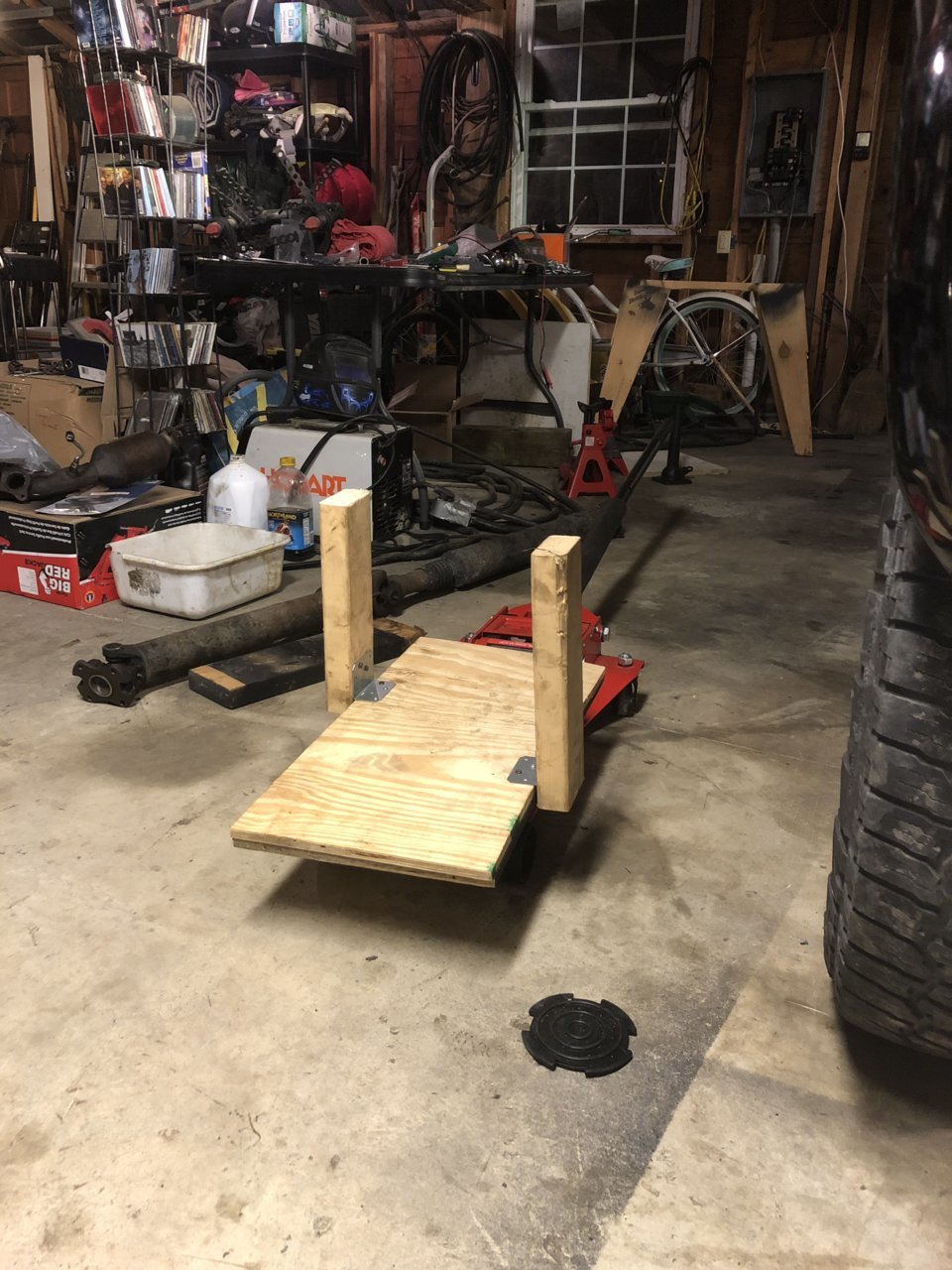

    Also had to put a new gasket on the clutch bell housing cover.
    Built a trans mount for my floor jack out of plywood and 2x4s.
    Got it under the trans under the truck.
    Ready to lift er up and slap her into place! Maybe tomorrow? This weekend for sure

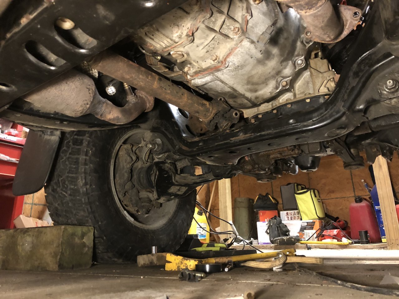

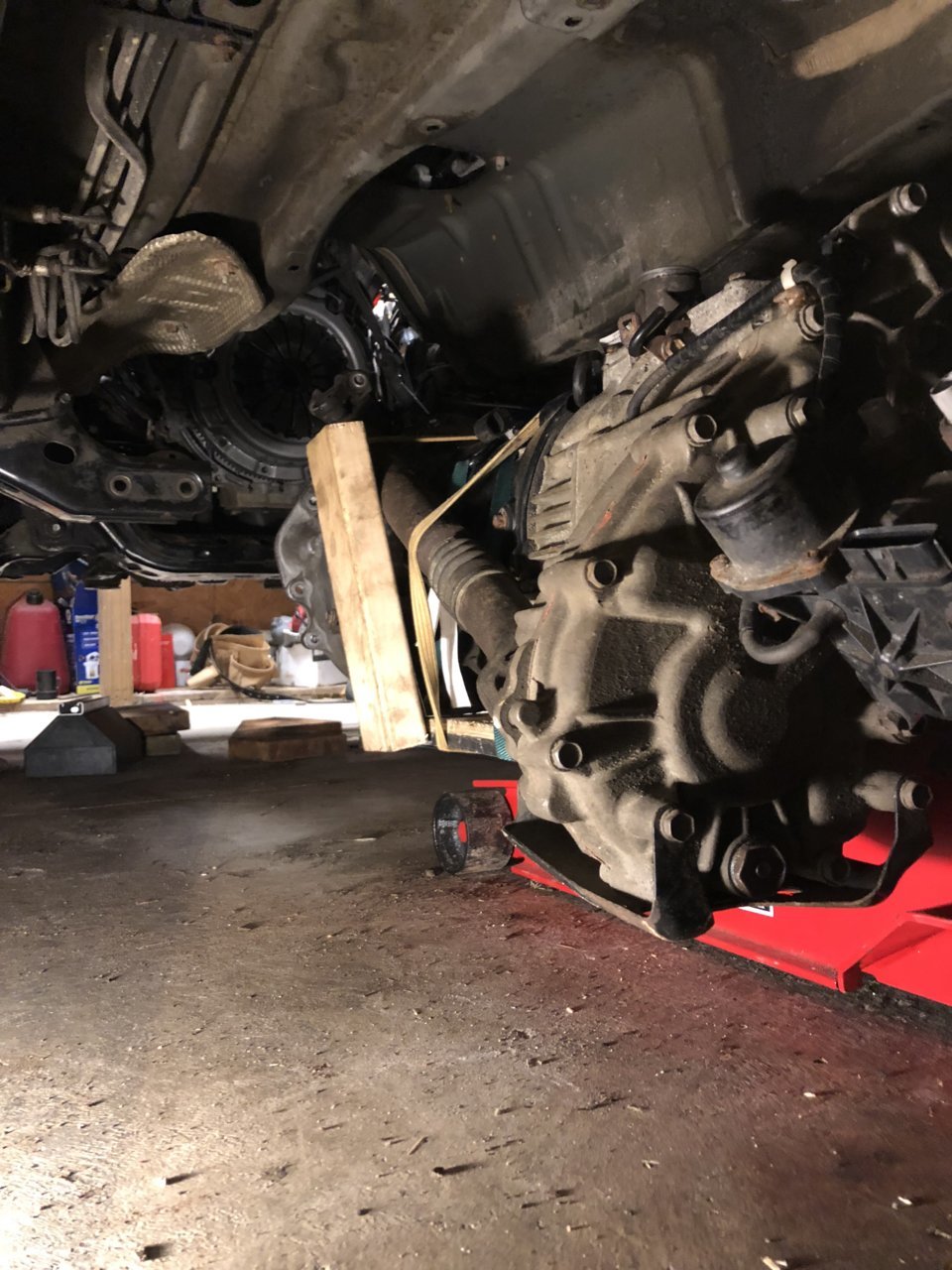

    Alright got the transmission back in! My makeshift trans-mount worked pretty good. It was a little hairy, but I didn't break anything. :thumbsup:
    3FE0F572-D0CB-4776-8549-B38D270ED0A0.jpg FA99E903-A214-4900-BC69-073445475DE9.jpg

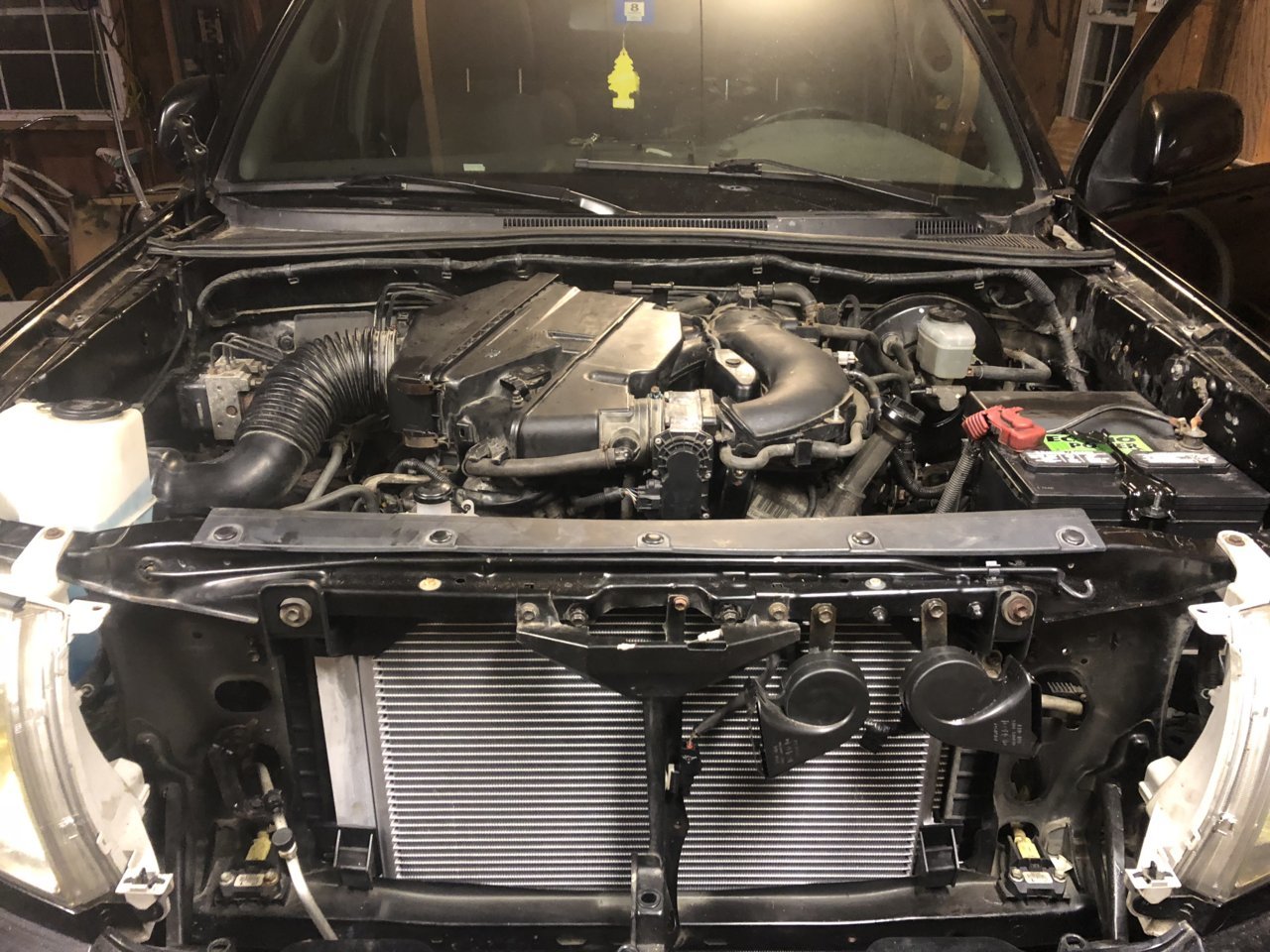

    Spent a long time on this truck last night. installed the new A/C Condenser (shiny), re-installed the Radiator,
    put the front driveshaft back on. still need to do the rear.
    put the upper intake manifold and throttle body back on with new gaskets.
    mounted the exhaust manifolds and new gaskets.
    put 5 qts of oil in. Need to top it off and swap the oil filter for a new one later today.
    added 1 gal of coolant. got some more today.

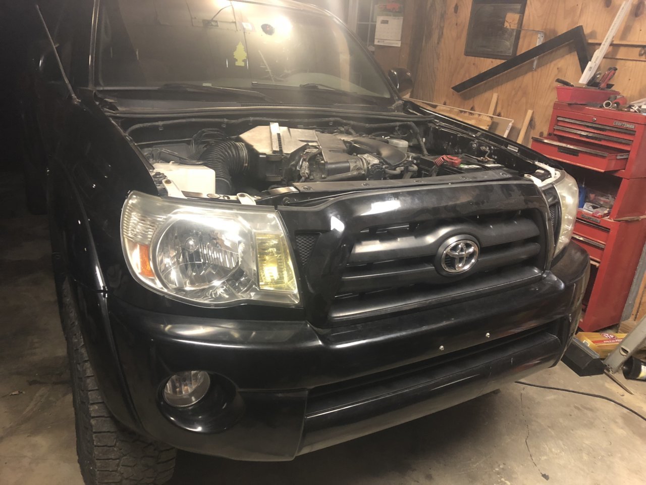

    She Lives!! :rofl:
    Had to replace the starter yesterday. But got her started up. 1BB4CEAA-EB46-4FD4-874A-4EA2C08FCFC4.jpgD4D7C397-CA5B-4E46-AC86-56F8A4D5BAC3.jpg I can hear the throw out bearing spinning though. It is touching the pressure plate fingers.
    Got to adjust that today.
    But otherwise the brakes seem to work okay, and the truck handles nicely!
    There’s a little clicking noise when shifting into 3rd gear. Not sure what that’s about. But, I’ll drive it around some more today and see if it keeps going.

    The 4x4 light went off after I plugged the wiring harness into the front diff! haha. oops.
    check engine light still on. Going to be taking it to the stealership Thursday to have them go through it.
    Snow in the forecast tomorrow! will get to test out the four wheel drive Tues / Wed. :muscleflexing:

    Drove it home in the snow yesterday & it handles great! 4.5” of fresh snow, no problem. Needs some weight in the back tho.
    Stopped and got some new wipers too. 46D6FDB5-5641-4CB6-9A32-3067FE8CA82F.jpg Update today: Bitch is street legal now!!
    Passed inspection yesterday, registered today. What’s up?
