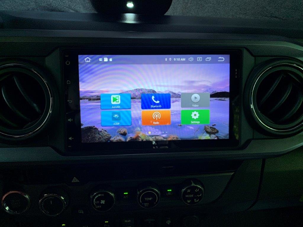

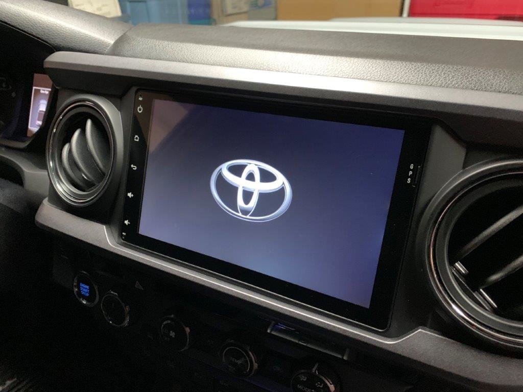

    OK ..... this could not have been simpler.
    This unit is out of the box complete. OEM audio plus was fully installed with the Entune (non JBL head unit. Simply unplug the Entune unit and plug in the Dasaita Android 9 unit and boom. DONE.
    I added a wireless apple carplay dongle (works both wireless and wired). I also added a oem gps to sma connector in order to maintain the factory GPS antenna.
    Factory GPS, OEM Audio Plus, Factory USB all retained. The head unit retains the factory steering wheel controls. No need to drill and reuse the OEM brackets. Buy a Scosche dash kit and use the brackets from the kit to mount the unit.

    what’s the advantage of this brand, vs a good brand of equal price - alpine, sony, etc?
  3. Jul 23, 2019 at 7:55 PM
    svermilyea
    svermilyea [OP] Well-Known Member
    Jul 31, 2018
    #261213
    1,567
    Scott
    East Tennessee
    2018 Taco Sport (Cement)
    3in leveling lift (Coilovers and AAL) 285/65R18 tires 18" Fuel wheel/tire package Pro Grill, Morimoto XB LED Headlights, DD SS3 Pro Fogs Body Armor Front and Rear Bumpers Pioneer WC6600 head unit w/ OEM Audio + Reference 500 System with dedicated sub amp Meso signal lights, gas hole, led interior lights, ECT relocate, Chrome delete kits Meso Overhead Molle Rack, Seat Risers, Katzkin Leather seats (self installed...it was a fucking bitch) VFTuned .....KDMax Pro!
    The head unit, complete with oem interface unit was 399. The Wireless carplay was 79. GPS adapter and mount kit were 14 each. Basically, half the price of Alpine/kenwood/Pioneer with a maestro oem interface module.

    Will this just drop right in and connect to oem harnesses on a 17 SR5 with the base entune radio? New Tacoma owner here. My dash surround by the radio appears smaller than yours as your new HU sits very close to the inferno colored piece on the dash. Will this unit work for me?? I love the 9” size and don’t want anything smaller if I go aftermarket
    Here’s what my current one one looks like
    Thanks for replies.

    Hi, I guess harness should work without any modifications. The Dasaita, IYING or similar unit should fit both are 9 inches. The most challenging part will be the trim around the radio. You have two options, buy a new trim or fire up you dremel.
    Good luck.

    UPDATE 8.11.19: 5nahalf found me the correct dash panel on ebay for $80 so I scooped that up. Also I lowballed the ebay seller(Official Dasaita Store) and they came down to $345 on the HU if anyone else is interested in this unit.
    Alright I ordered this unit, can anyone make suggestions on trimming the center panel to the appropriate size for this unit. To order the correct size is 220.00, ridiculousness. I was thinking I first need to make a template of the unit face and go slightly larger. Not sure what tools to use on this, I do have a dremel and some cutting wheels for it and then fine sand the edges by hand with a block.
    delonix can you comment on the opening on your center panel is it pretty much centered left/right & up/down on that panel? Also is it easy to make mounting bracket adjustments to get the correct placement of the HU through the opening?
