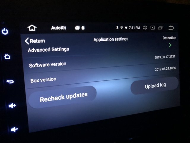

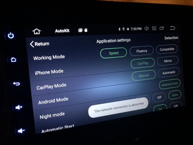

    Well now it’s giving an error of an abnormal connection when I try to update the box via autokit app, see photo. I did update the autokit app itself so I’ll see on my commute tomorrow if that helps with the stuttering audio which seems super random now, it’ll do it all the time then I unplug the dongle reinsert it and all is well. Second pic shows the versions of autokit app and dongle version dates, lmk if the dongle firmware date is old

    I just tried to do this on mine tonight and had the same results as you, "abnormal connection"
    With the stuttering audio and no Spotify integration on Waze through CarPlay I've pretty much decided to ditch it and just run Android full time.

    Yeah the Box Version I installed was from July 2019, and it flat out says "iOS 13 stutter fix" in the release notes. I did not get "abnormal connection", but I will say that I have a hell of a time keeping a wifi connection in the driveway, for updates and/or app installs. I've chalked it up to having a mesh network, which some wifi chips have problems with.

    I even drive the truck to the side of the house within 20’ of the damn gateway and still got this error, then connected to my neighbors WiFi and still same error. Anyway to connect the dongle to a laptop to update the firmware?
