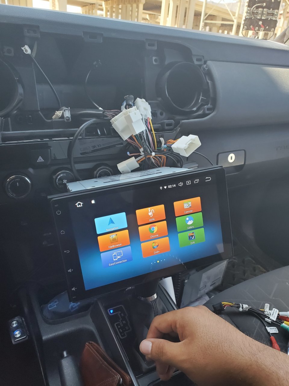

    Hello I'm installing mine. Anyone know where I have to drill the holes for the original bracket?
  13. Sep 26, 2019 at 12:11 PM
    #373
    DaMaDo
    DaMaDo Well-Known Member
    Aug 14, 2017
    #226790
    505
    Northern AL
    2018 White TRD Pro
    Nice, mine just shipped too. Looking forward to getting it installed.
    DoubleD.17BlazingBlue likes this.
  14. Sep 26, 2019 at 3:08 PM
    #374
    DoubleD.17BlazingBlue Well-Known Member
    Aug 8, 2019
    #301592
    102
    Derek
    2017 Blazing Blue SR5
    No sorry I bought the aftermarket kit suggested in the OP and had to modify it to get it to fit, looks back near the beginning of this thread for my pix. Good luck

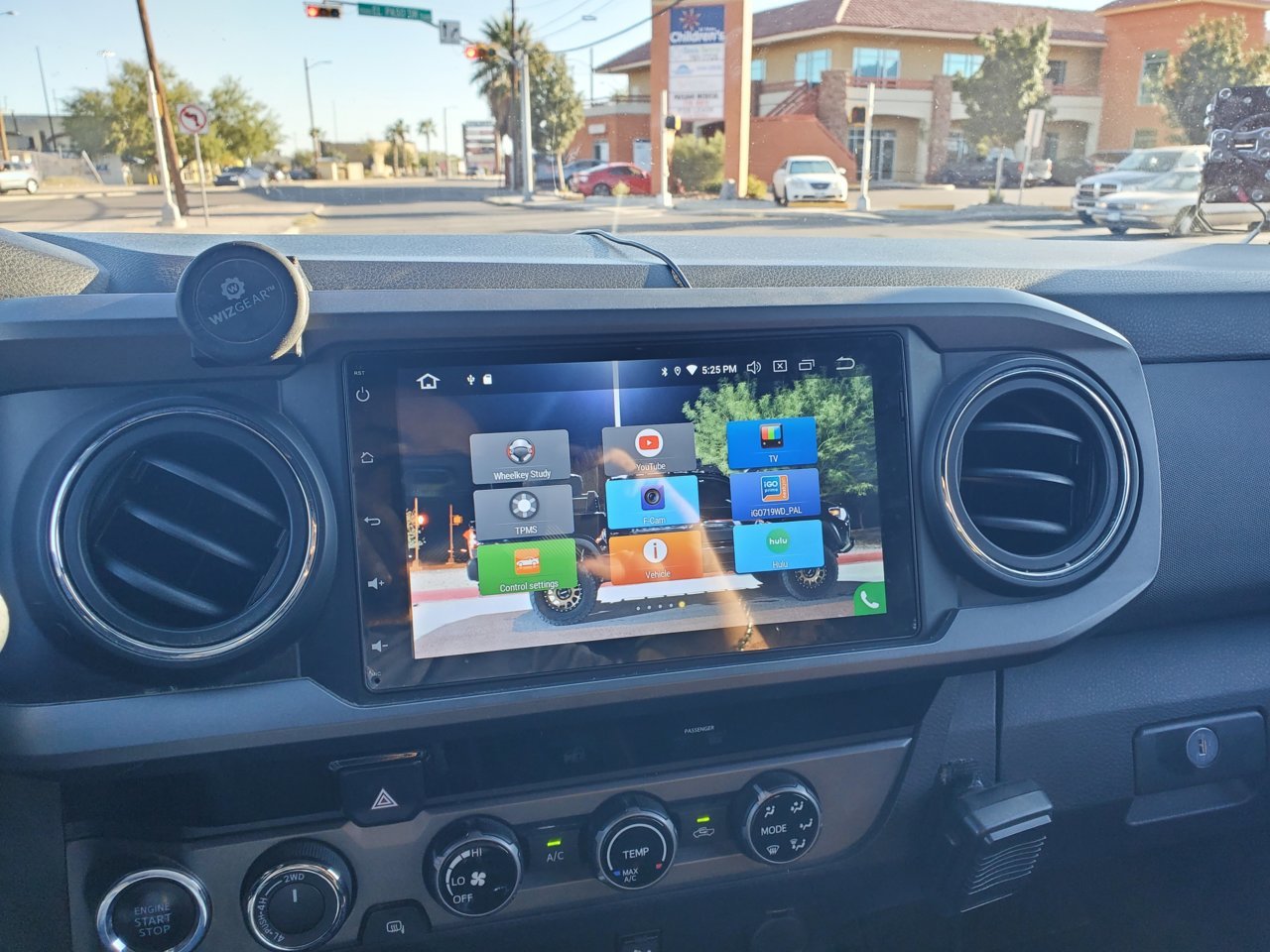

    How did you get that UI?
    Or how do I get different UIs
  16. Sep 26, 2019 at 6:25 PM
    #376
    Aug 8, 2019
    #301592
    102
    Derek
    That’s a car launcher, the Agama Car Launcher. I’m actually not even using it any longer, I’m using CarPlay now through the CarLinkIt dongle. The Agama launcher is cool looking but I wanted artist/track/album art etc on and that just doesn’t do it

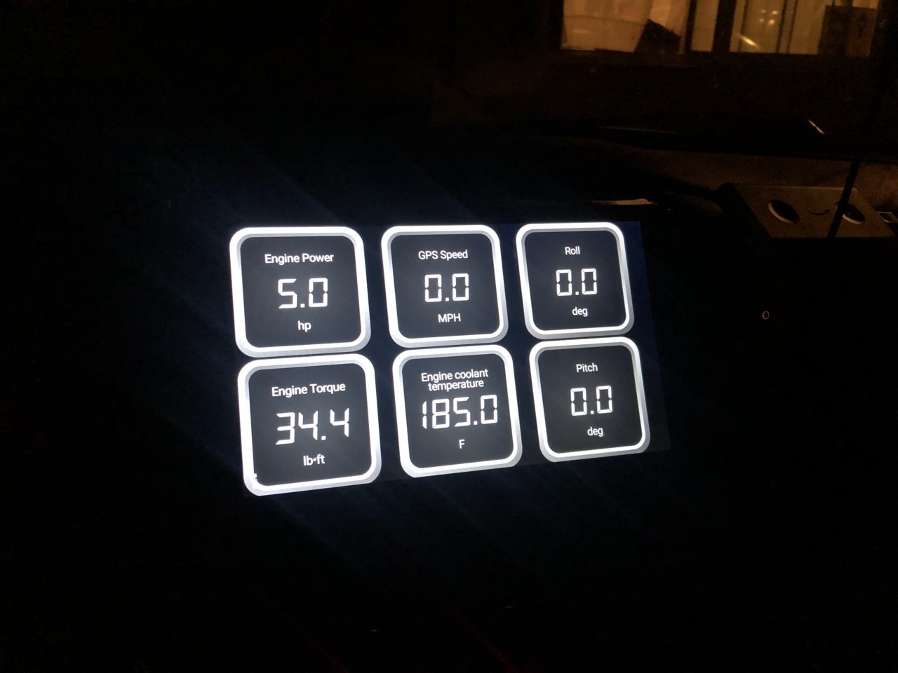

    Got the VeePeak OBD work. Trick here is make sure iPhone BT is not connected. This brings up the prompt to add but nothing. Change the pass code to 1234 then try and it connects. Once its connected you can use both but it won’t add if your phones connected already.
    Odd but this will get it to work. I did order the elm just in case but looks like no need for it now.
    Now need to get my switchpro to work on it.
