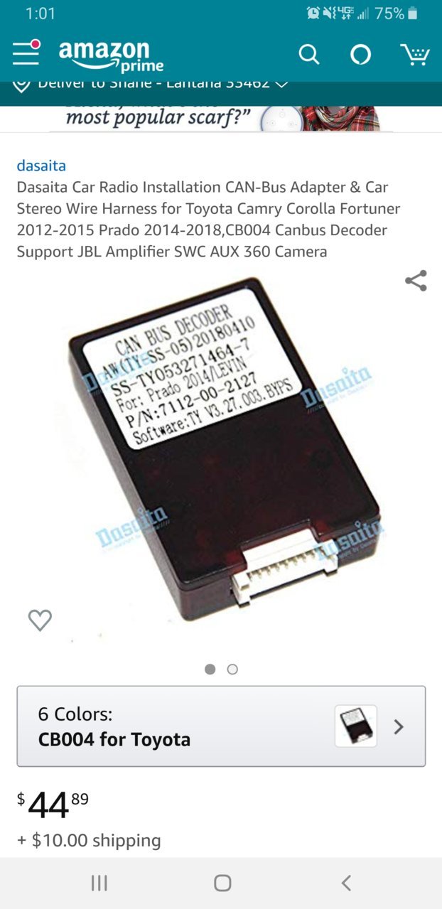

    Do you know what adapter for the stock rear camera? Where to find it? I already have the anytime front and rear camera setup, but have yet to install because I want to upgrade to this HU. If it's not needed I'll just sell it.
    I wonder if it's apart of this wire harness that Dasaita I'm said I needed for install. I'm actually going to install the 10.2 size unit, but all the internals are the same.

    Thats for the JBL setups from what I understand. Got it. I wonder how much that is going to stick out from the front. the 9" fits it like a glove already.l

    When I ordered mine, Dasaita said I need the canbus adapter if I will be using a factory camera. It's the same one you need for he JBL (which I don't have). They added it to my order for an extra $30.

    ah got it. I was chatting with the guy and side mine was fine since I did not have JBL. I guess he left out the canbus need then. should be better labeled 2012 and up need the canbus and pre 2012 do not.
