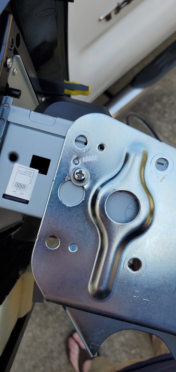

    Just did this yesterday. Mounted to factory brackets with one screw on each side with this hole location (2011 non jbl, Dasatia PX6). The factory screws do not fit the holes on the new unit so you have to get a couple that do and I knocked the top 2 locating bumps off the bracket with a dremel so they would sit flush. ymmv

    nice, I figured I would do that as well.
