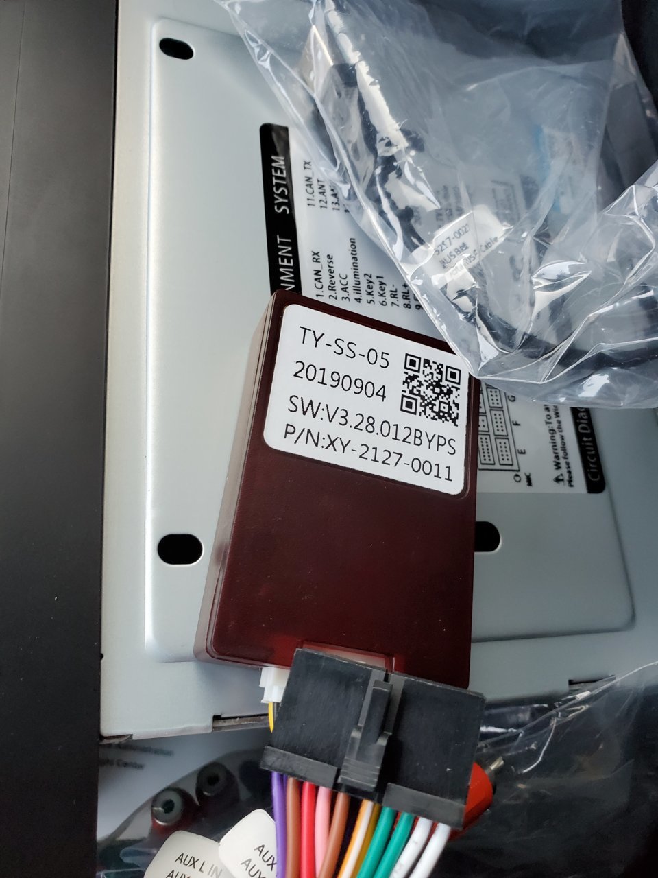

    This is the canbus thing that came with mine for the rear camera

    Got mine installed. Loving it except for one thing.
    My phone auto turns on its hotspot when I connect to the HU Bluetooth, but the HU won't connect automatically unless I open up the list of WiFi networks on the HU, and then it connects.
    Anyone know how to fix that?
    HU has the 08/28 patch.
    Also, what canbus protocol do you use?

    Nope. It's why I use a dedicated hotspot.
    One of the Rav4 ones. Sorry, I can't remember which one exactly.
