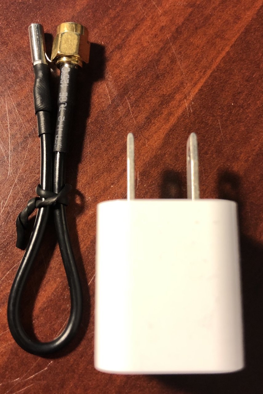

    I got the USB cable with my PX6. The discountcarstereo cable was great for connecting to factory GPS antenna.
    Loving the system. Wifi *usually* connects automatically within 30 seconds for hotspot, but sometimes I have to make the HU connect by going to the wifi page that lists them and it will then realize it's being lazy.
