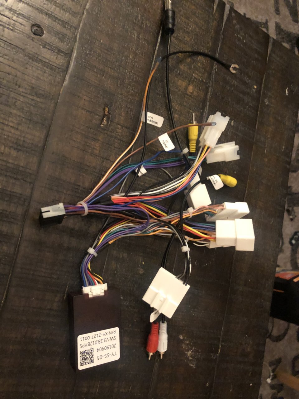

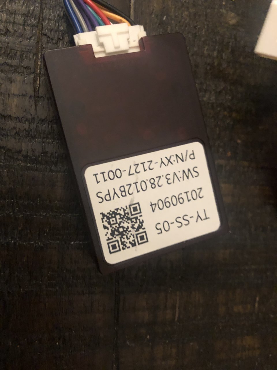

    Anyone with a canbus wore setup have a photo? They sent the wrong one so I ordered a new one based on their feedback and record it today. It does get the camera to work (although my anytime did not work) did not bother with my front setup yet) the big frustrating part is the steering controls did not wot on the new one which leads me to believe they sent another wrong one. Looking at the connections front factory to the new ones it’s missing wires.
    trying to find out the right one. So close gain camera lose But lost controls. For now I put the old harness back in.
  14. Oct 17, 2019 at 5:21 AM
    #514
    DaMaDo
    DaMaDo Well-Known Member
    Aug 14, 2017
    #226790
    505
    Northern AL
    2018 White TRD Pro
    Did you try different car setups from the factory menu? And also the button mapping page?
  15. Oct 17, 2019 at 7:01 AM
    #515
    QuicksandYoda
    QuicksandYoda Well-Known Member
    Aug 6, 2019
    #301429
    68
    Shane
    '19 quicksand 4x4 OR
    You gotta change the factory settings to number 8.i had the same problem. I have the Px6 10.2 in screen but I'm sure there isn't any difference in canbus or the setting

  16. Oct 17, 2019 at 12:24 PM
    #516
    Taco_Coma
    Taco_Coma That's a lovely accent you have. New Jersey?
    Oct 30, 2018
    #271144
    2,982
    South NJ
    2018 DCSB SR5
    You have the right canbus. Go to settings > then the one that asks you for the password I think it's either car settings or factory. I the password is "126" then you have to go to canbus and choose rav4 for the steering wheel settings to work. As far as the back up cam. make sure all of your connections are in. You have to hook up all the RCAs to the right ones and then you have to plug the rca harness into the right back up camera slot there's a diagram on top of the unit that will tell you which one it has to be plugged into. Slot D. if that doesn't work. take out your back up anytime kit it's fucking it up
  17. Oct 17, 2019 at 1:13 PM
    #517
    nudavinci64
    nudavinci64 Robert @ Holy Horsepower
    Nov 14, 2013
    #116533
    10,145
    Robert
    San Mateo/Cayucos, CA
    13 S/C TRD OffRoad 4x4
    Boosted Money Pit....
    Thanks did not know about the RAv4 settings. The camera works just fine so that is not an issue. The anytime was not working but thats a different issue. Its a home made anytime kit so not one of the prebuilt setups.
