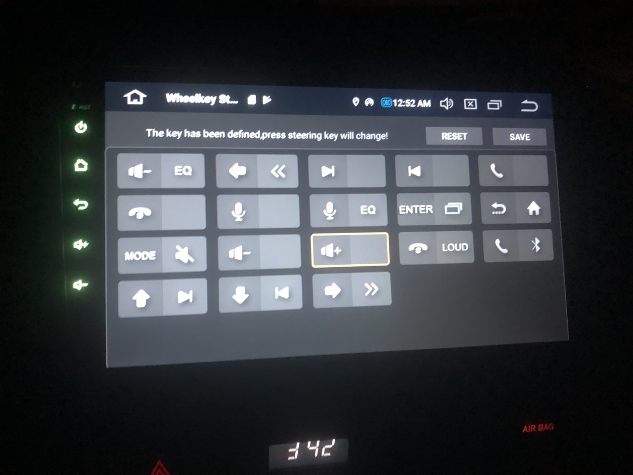

    I had the regular cable on SWC and most settings worked that you experienced. I just connected the canbus again and did change that setting to canbus from swc and then went in and was able to program all my buttons on the canbus and everything works. even the buttons that you had to modify to work, work with the can bus, programed it to up/down/left/right enter, return and a bunch of buttons. At first it worked but limited settings on the canbus and once I updated it from swc to canbus or canbus to swc (forgot which way need to check) I was able to customize much farther than the non canbus setting. Camera works too.
    The canbus option seems to give you much more flexability. Works navigating the UI and even navigating carplay if you program the buttons to navigate. I programed the up/down L/R to navigate then the long press works the forward track/back ward track.
    In a nut shell I now have way more functionality then previous non canbus setup and even more than the factory radio.
    I’ll test out my setup for the front camera that had other shortcuts. May not work due to conflicting canbus settings since it had its own canbus for camera switching but we’ll see.
    SWC setup. Some are duplicated I think due to canbus and non canbus setting.

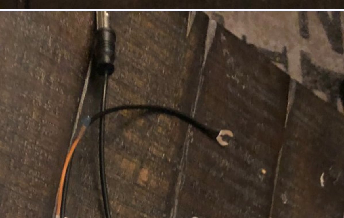

    What did you guys do with this ground like wire?

    There’s a ground point behind our dash

    figured that was it. Any idea where it is? It as not clear.

    It’s closer to the passenger side I had to take apart the passenger side to get to it
