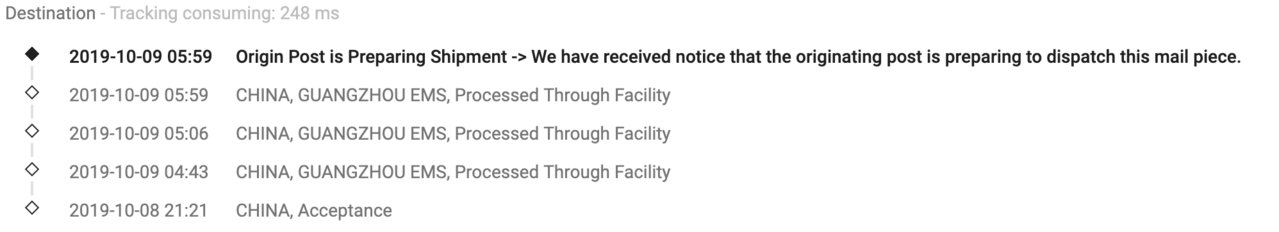

    Anyone else order from their ebay store? I ordered two weeks ago and received shipping confirmation pretty quickly but shipping info hasn't been updated since. Curious what your shipping experience was like.

    I did. Try the tracking number on USPS. It might be a little more detailed. They don't tell you, but a signature is required for delivery.

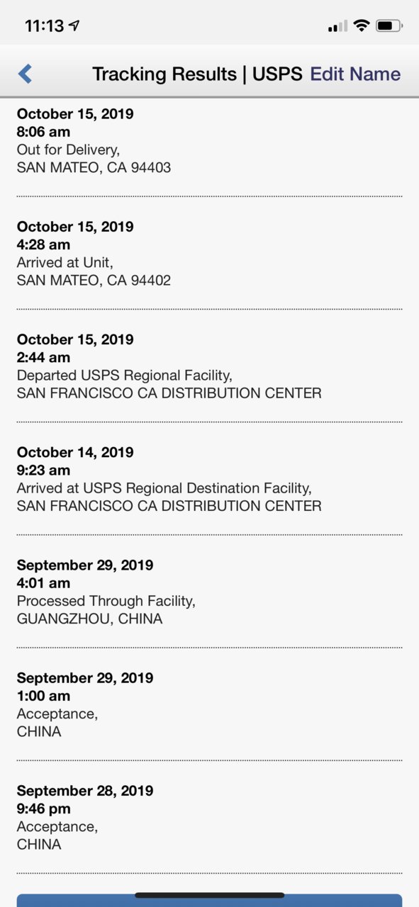

    It varies. If they shipped it DHL you should get it pretty quick 1-2 weeks. Since it seems this was shipped china post, EMS or e-packet then your looking at a longer ship time. The bad thing about that is it can go dark for some period of time before it shows up in the USPS tracking. I got my unit shipped via DHL but later needed to buy the canbus and ordered external TPMS module and that was shipped EMS or china post and it was dark for a couple weeks before it popped up in the US in customs. Give it time. If it has been 3 weeks hit them up but not much they can do once its shipped.
    below is my tracking when I had Dasaita ship me the canbus. Took almost 2-3 weeks. Most likely it’s stuck in customs.
