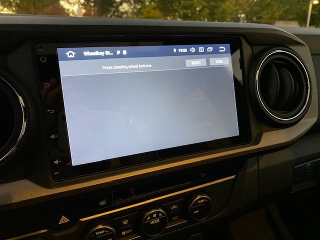

    My track forwards and backwards are the opposite of what they should be. Seems like I should be able to fix this in steering wheel buttons in settings, but this screen is blank. I'm not really sure what I could be doing wrong.

    I haven't done anything with the SWC buttons, but had a similar challenge with the panel buttons. This might help.
    https://www.youtube.com/watch?v=ZPCLqILDwUs

    If you have a canbus you need to change your profile to Toyota.
    Settings --> Car --> Factory Settings --> 126 - Canbus, then option 8
    zhazell likes this.

    Buttons are figured out (thank you for the replies and help). Another question, has anyone been able to get dashboard view? I have iOS 13 on my iPhone, and i believe you should be able to just swipe right in icon view to switch to dashboard view, but I've got nothing.
    Edit - figured it out.
