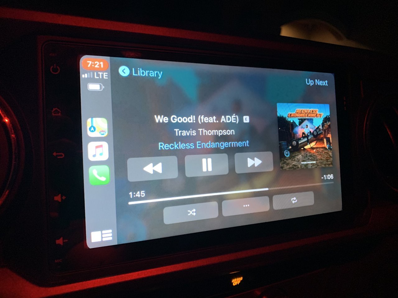

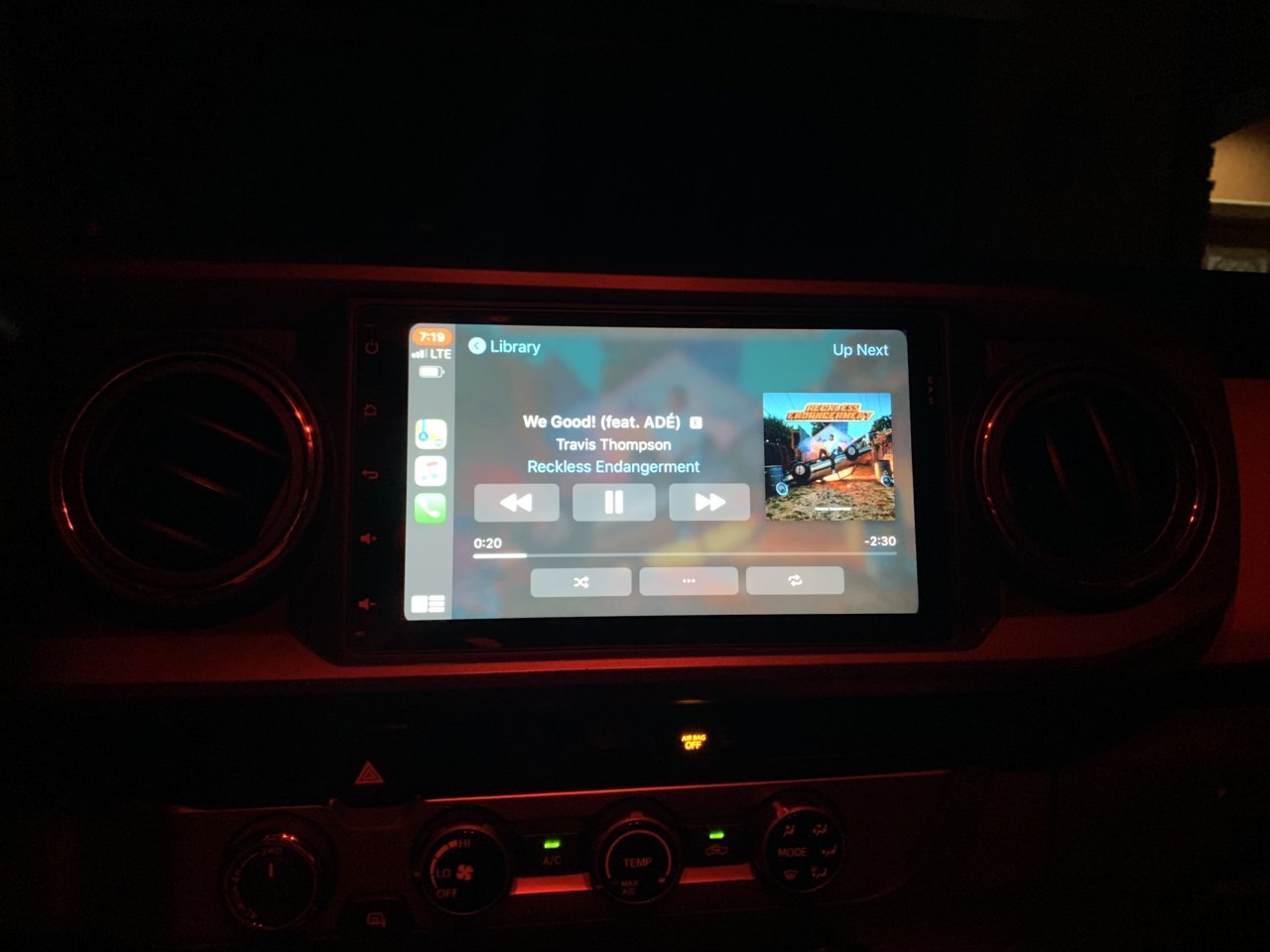

    Thanks to @Taco_Coma I installed my (his old) unit & bezel trim.
    My initial thoughts after 1 day are:
    1. Sound is totally different than what I’m used to. It blew me away right away, not in a good way. I was shocked. I’ve got the kickers all the way around & it used to be a great sound. This new sound is almost “muffled” and the bass is totally gone. It seems like it’s even unplugged. I have to turn “loud mode” on thru the amplifier EQ just to even hear any bass. I’ve fucked with the settings up and down, left and right & cant find anything I like. Hopefully I’m missing something and someone can chime in, maybe I need to add a diff EQ app or something to the unit?
    2. Wireless car play is fucking awesome. It’s a slow start sometimes & didn’t connect once today. I just had to toggle the Bluetooth on my phone & it hooked up. This feature makes everything worth it.
    For the price & wireless CarPlay you can’t beat it. I’ll deal with the minor nuances of this unit & hope to get the audio figured out. I drive for work & this is a huge upgrade over stock as is.

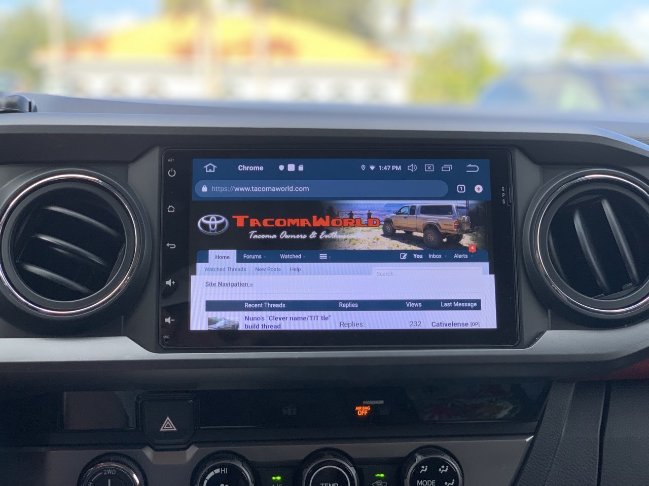

    It’s pretty fucking cool to be able to do this though!
