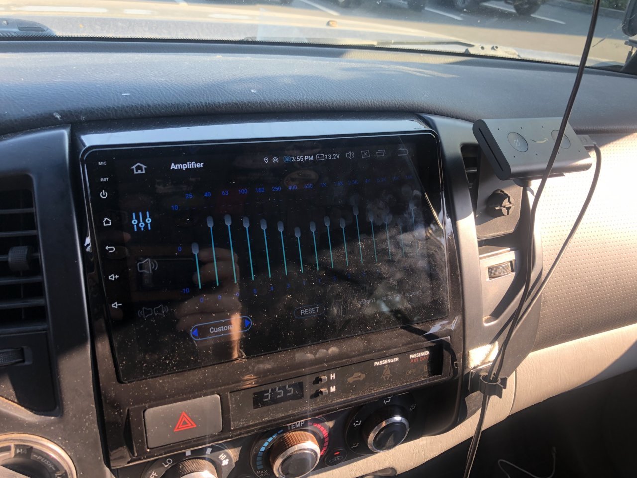

    EQing is certainly a matter of taste, but this is how I set up the EQ on my truck with stock speakers. The sound is SO much better than the oem head unit.
    I did break the first rule of EQ’s though, which is to subtract instead of add.

    I think I subtracted on the lower ones as well. Little speakers just do not like it turned up. EQ is a nice touch.

    Hmm that’s not how my EQ looks. I have way less bars to move around
