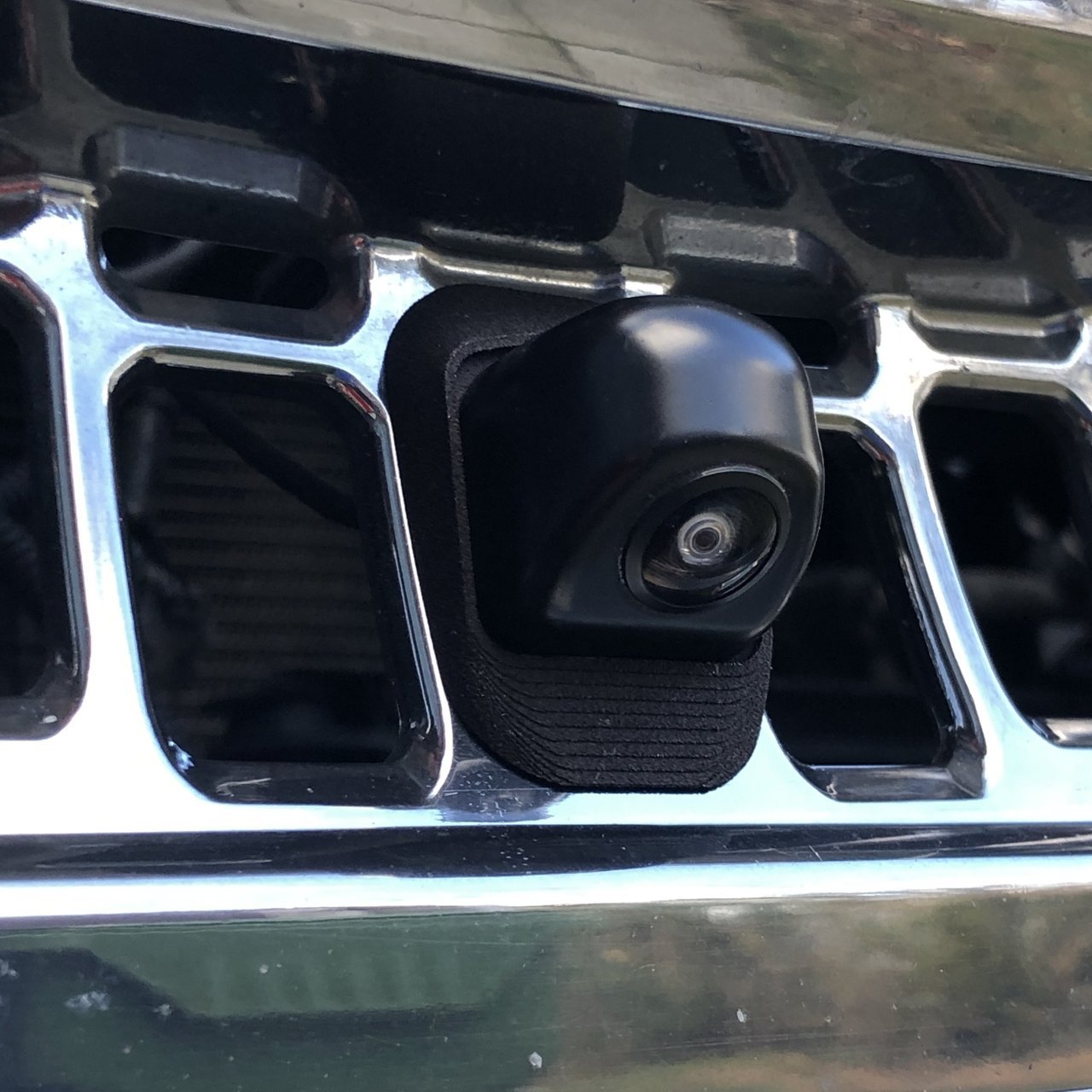

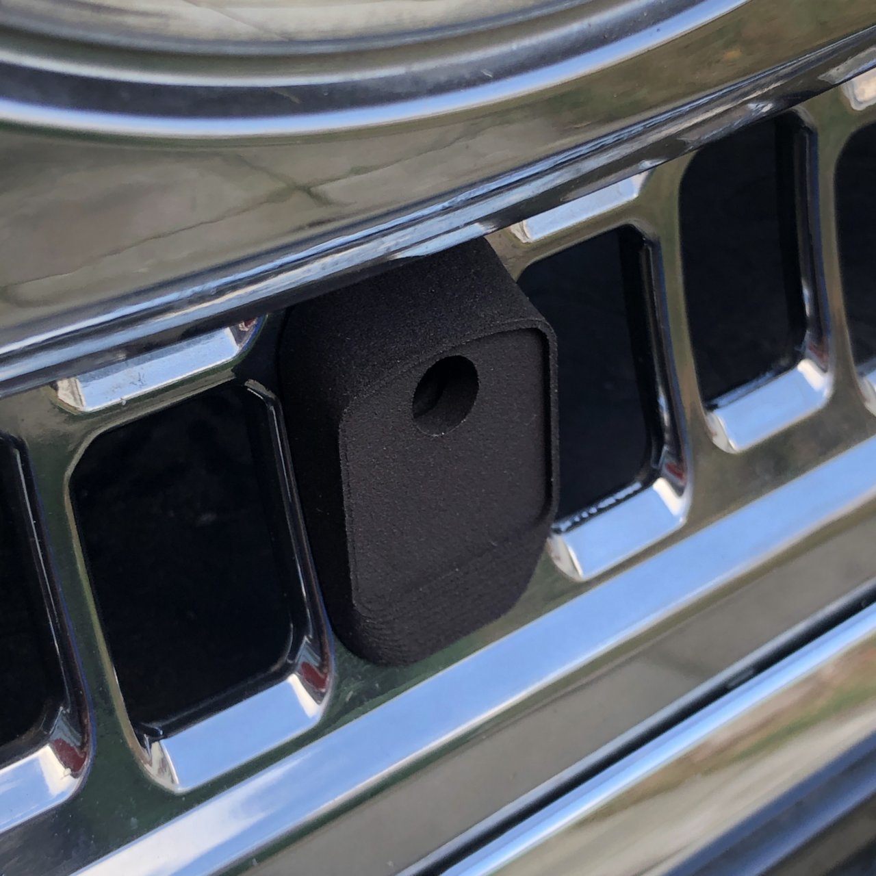

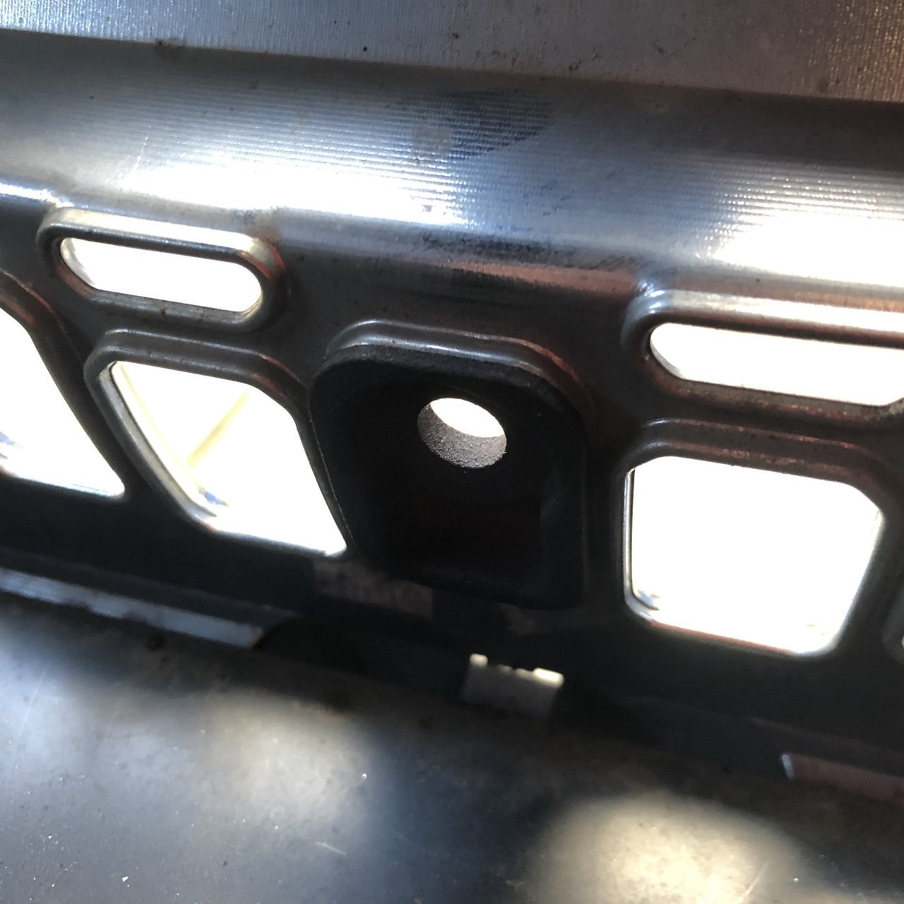

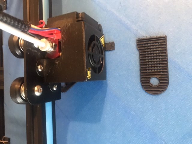

    Silverhammer, do you have the template you can share on thingiverse for this 3D printed mount? Really liking how it looks with that front camera.

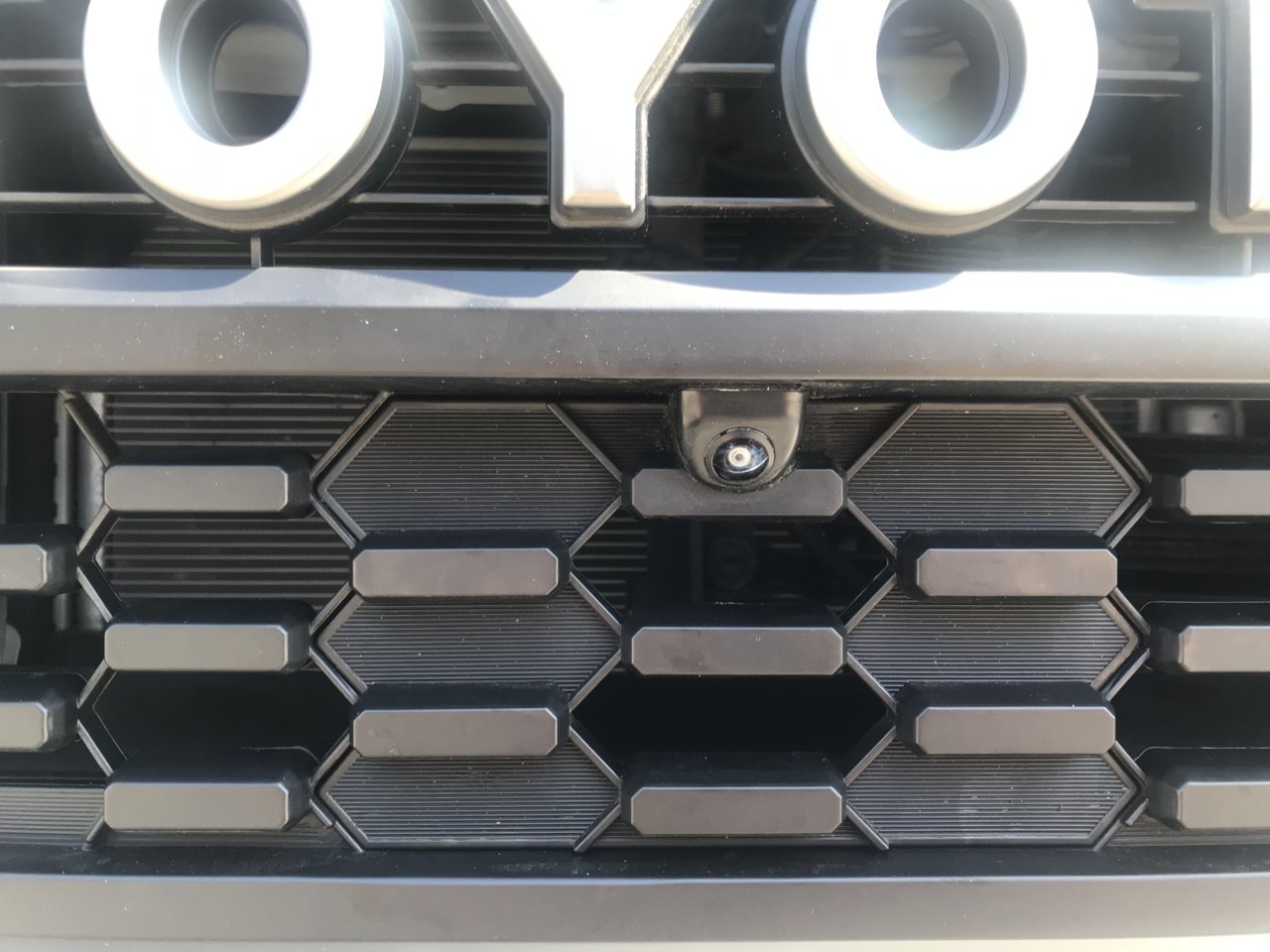

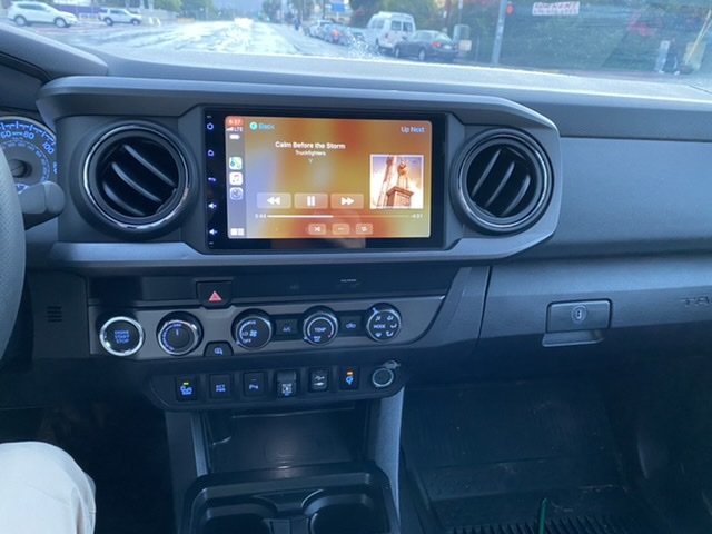

    For those with TRD Pro/Faux grilles, I too purchased the Natika front cam and installed it as seen in the photo, looks and functions awesome!

    I like this placement better. Looks good man!

    That's exactly where I put mine. Very easy install.

    I put mine in the middle. I don't have that fancy radar anti-missile stuff :D. I want to go back and notch behind it. It sticks out a hair. Probably add it to my list of things I'll get around to on the truck.

    that’s what I did. It was a pain, but it sure looks clean in the center.
