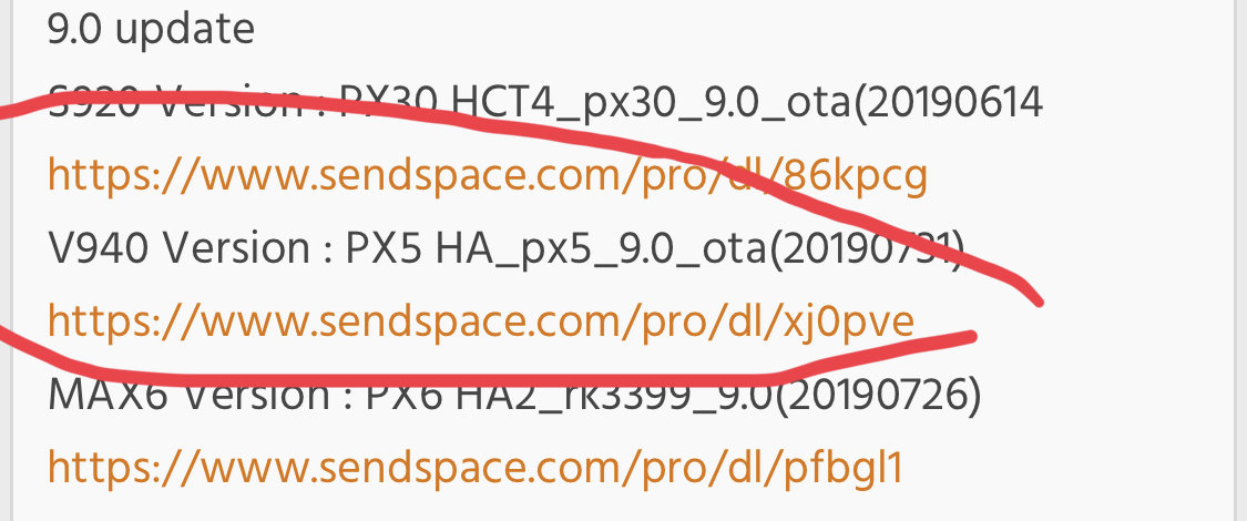

    Is this the update? If so how do you instal? I know nothing about Android

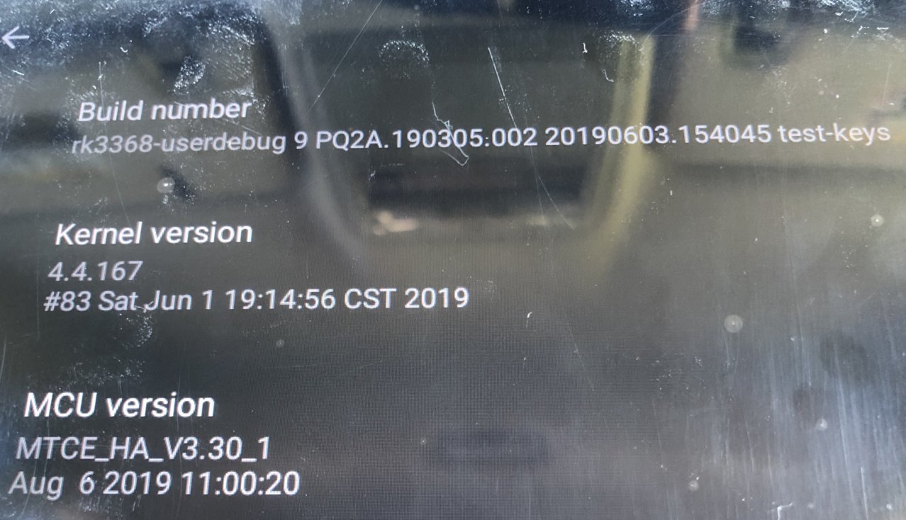

    Here’s what version mine came loaded with, dates look decent atleast on the MCU

    Download the .rar open it and extract the update. Then put it on a usb or sd card. Then under settings you can update. Yes that is the update. Our unit is V940 ver.
