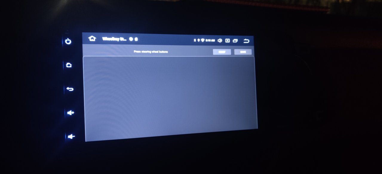

    So how do I actually remap buttons? It would be nice to change some things around, but I can't seem to figure out how.

    There should be a steering control app or you can go into the settings. I’d snap a photo but not near it. The app will bring up the area in settings

    I opened the app, but it's blank, and when I try to press a button to map it it doesn't do anything.

    See when I open up the steering wheel buttons settings, it's blank and when I press any key, nothing happens.

    I think I figured it out. It wouldn't let me map any buttons under the steering wheel controls option. I was messing around with the factory settings and changed the user version from 1 to 2, and after that it let me remap my buttons for some reason. Don't know why but it seemed to work

    Ah could be it. Did you ever change the canbus settings? I forgot o had to do that before it would work.

    I think so yeah. Maybe that was it and not the version. Idk, all I know is i got it to work finally, even got my voice button to bring up Google assistant. Just need to find a way to mirror sms notifications now and I'll be set.

    Hey dude go to the car settings after entering in the 126 code and then go over to the advanced and switch the steering wheel go map and it should work.
