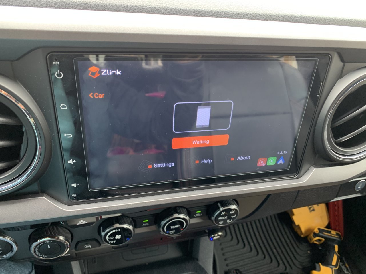

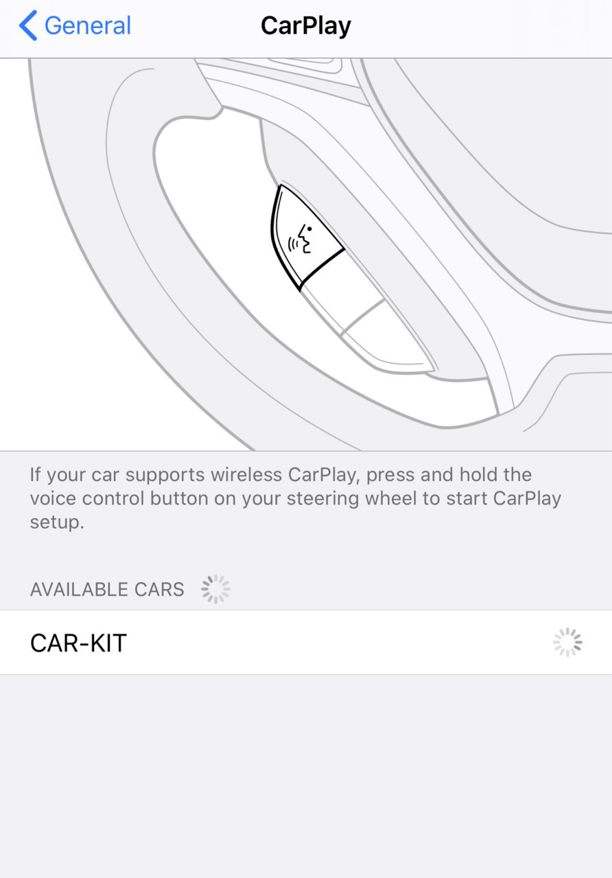

    Hi guys, can someone help me to get wireless CarPlay to work in my unit? I already Linked my iPhone to the Bluetooth app but when I open the Zlink app to open CarPlay nothing happens. It works great with wired CarPlay though.
    May be I’m doing something wrong?
    By the way I have the head unit with the $30 extra chip.

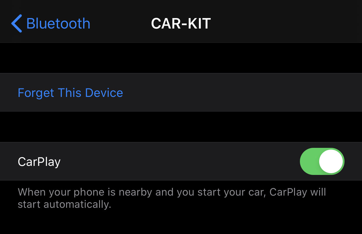

    So when I paired mine to Bluetooth, I waited on the Bluetooth screen for 30 seconds (after pairing) or more and a pop up came up on my phone stating if I wanted to use this for CarPlay. Once I did that, it connected wirelessly to zlink.
    Make sure it's enabled under bluetooth.

    Also check if you are connected to bluetooth. Sometimes it does not connect. It works most of the time but more often then not it takes longer to connect or the BT is not connected.

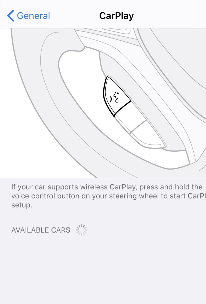

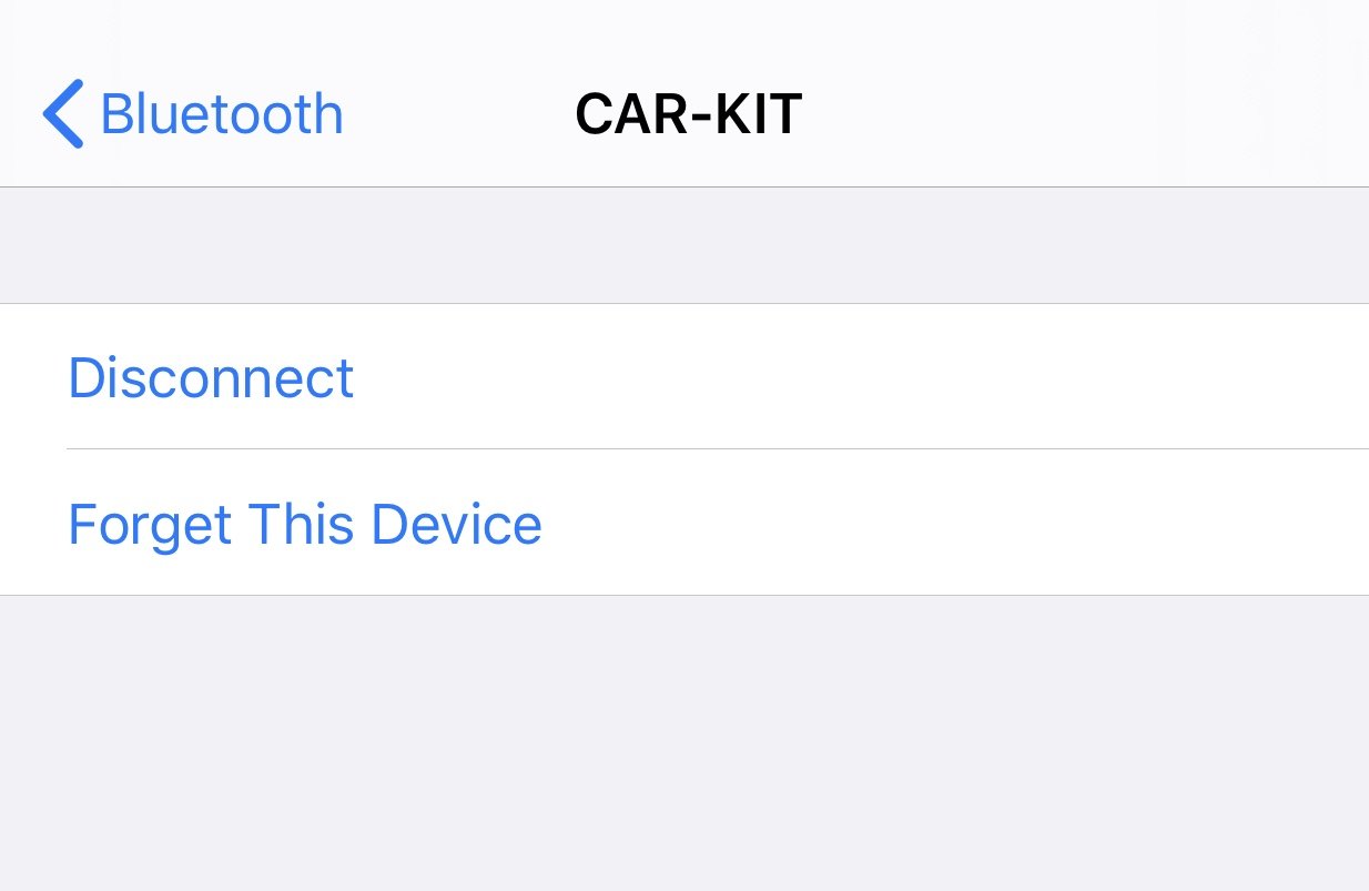

    Thanks for your reply, I waited like 2+ mins in the Bluetooth screen and nothing happened.
    It’s connected to the HU but doesn’t recognize the radio as a wireless CarPlay player however when I unpair the Head Unit it appears in CarPlay devices but when I choose it it doesn’t do nothing either phone or the head unit.
    I’ll contact Dasaita.
    Really appreciate your help.
    This happens when the phone is unpaired.

    Thanks for your reply the BT connection is active but it doesn’t recognize the HU as a wireless CarPlay player.
