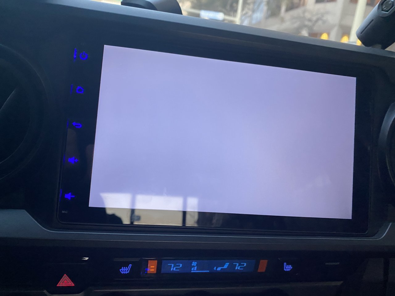

    Once you download the file, unzip it and you should see an update.zip file. Move that file (without unzipping) onto your USB drive or SD card. The head unit looks for the "update.zip" file. I made the mistake of unzipping the update.zip file and moving individual files over and that won't work.
    I would caution about the update if you're using the Carlinkit Carplay wired dongle, as since the update I get a blank screen when trying to use Carplay and have not figured out how to fix it.
