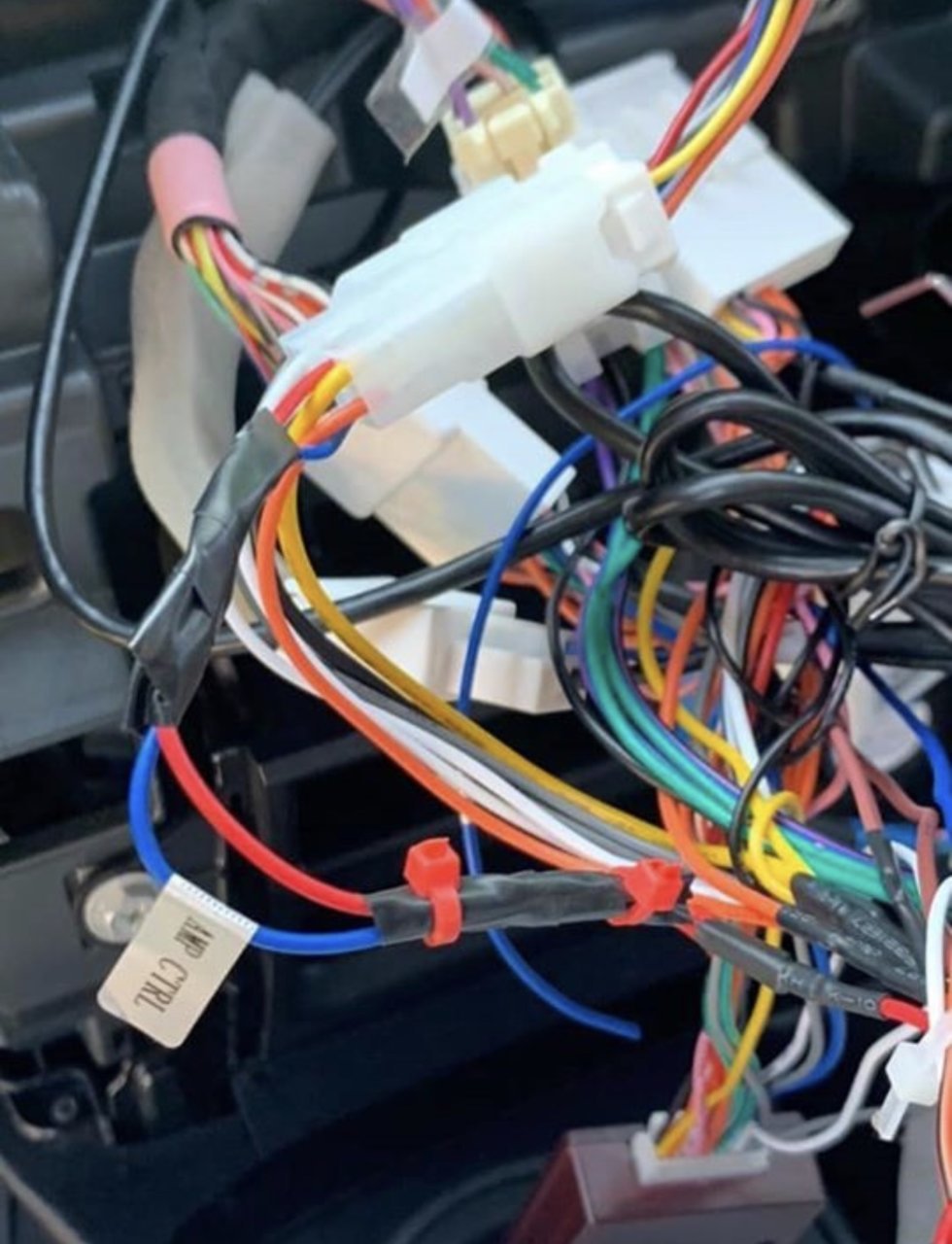

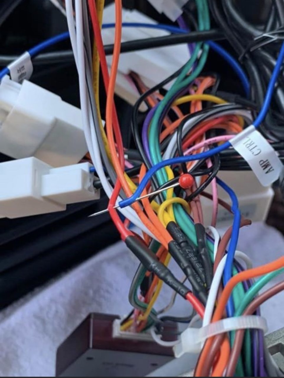

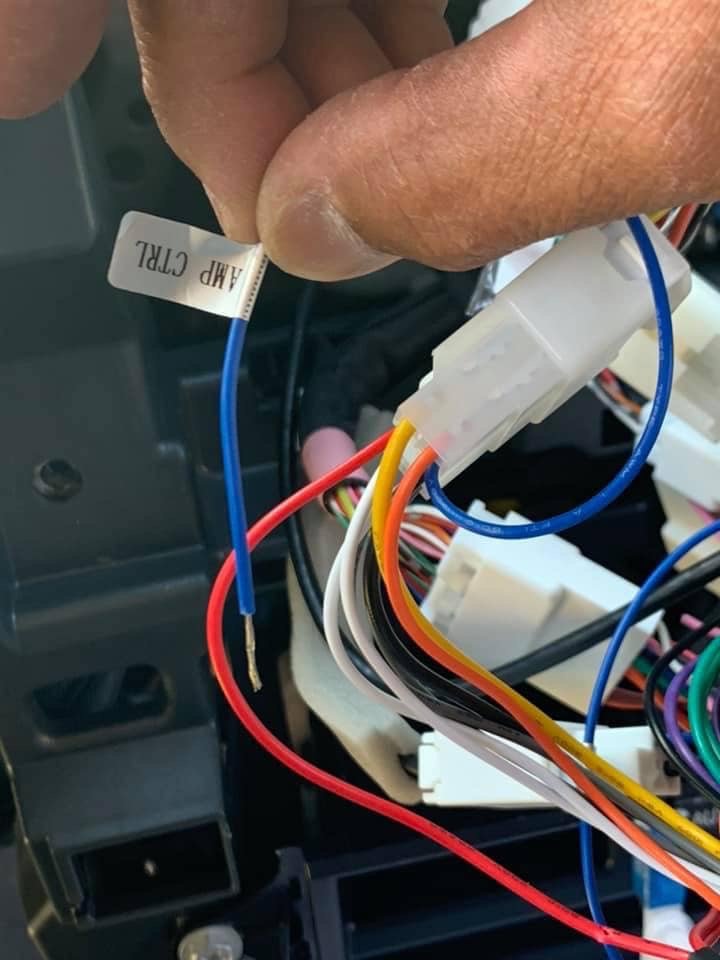

    I ended up using the L and R rear channels and had to set the crossover to filter out the high frequency. Messed up my plan to have a dedicated setting for sub like my pioneer eq. Either way, it’s a solution.
    For power, I had to tap into a 12v line on the harness. Here’s photos of how the 4runner folks on Facebook have it set up. Not elegant and a bit surprising considering the cheapest pioneer units have a remote and sub RCA out :confused:
    721ACDC0-F31F-4449-932B-16FFECC9479B.jpg 4A92A701-B255-4525-B378-C849B3788FED.jpg 6A7AB4AF-5C1B-4EDC-ABE3-472A44416001.jpg
    I soldered the ones I needed but a T tap would work too.
