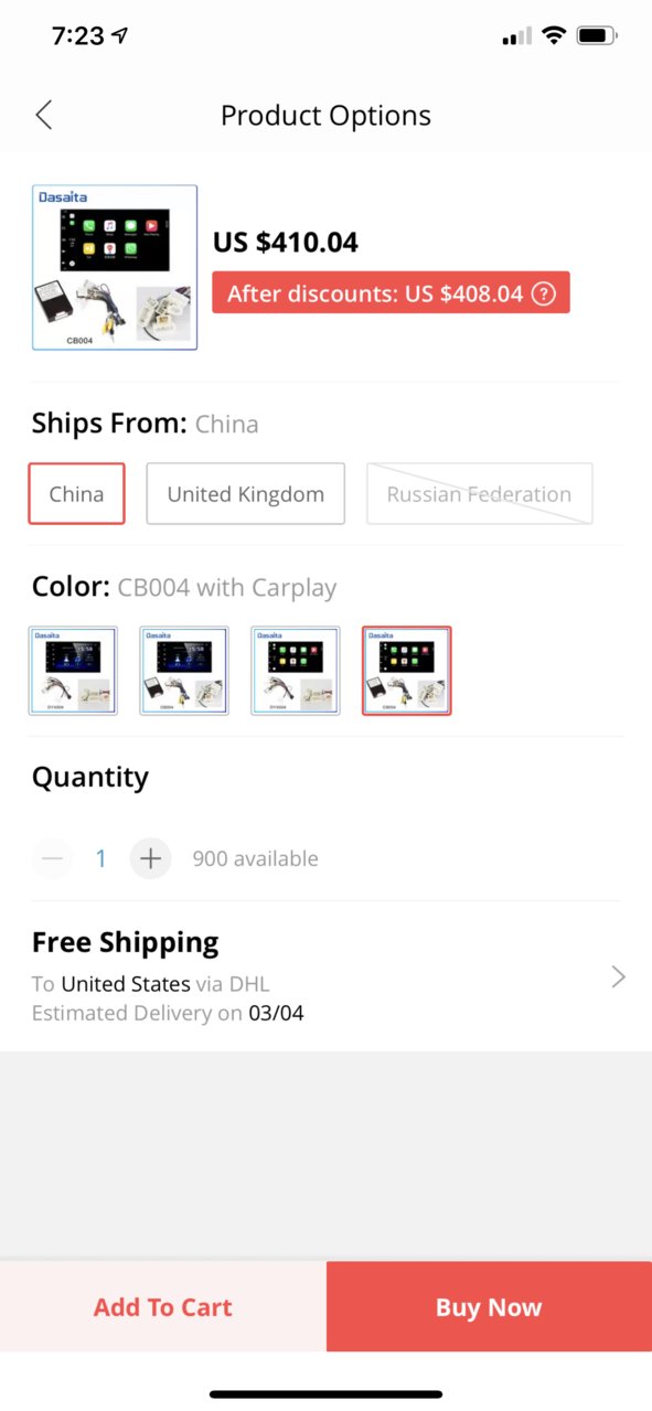

    I’m trying to order the px6 from AliExpress and I need to know I’ve got the right “color”. It’s the CB004 with CarPlay and I’m also assuming it has the canbus controller based on the picture.

  10. Feb 17, 2020 at 3:15 PM
    #1010
    nudavinci64
    nudavinci64 Robert @ Holy Horsepower
    Nov 14, 2013
    #116533
    9,876
    Robert
    San Mateo/Cayucos, CA
    13 S/C TRD OffRoad 4x4
    Boosted Money Pit....
    You want that or cb005 I need to check but you want the canbus version that’s for sure which is the 2nd or 4th option.

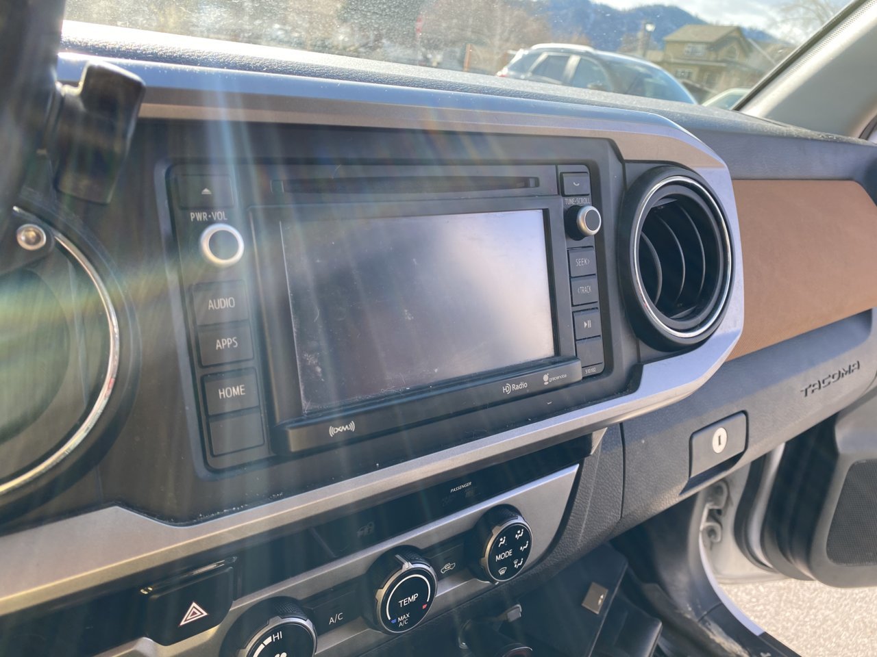

    77ED5B79-6120-4DFA-891A-5D3910D458F1.jpg Could someone tell me if this bezel would work? Its a 2016 sr5 non jbl
  12. Feb 17, 2020 at 4:01 PM
    #1012
    nudavinci64
    Nov 14, 2013
    #116533
    9,876
    Robert
    Nope it will not. You need the bigger premium one.

  16. Feb 20, 2020 at 5:42 PM
    #1016
    vsekvsek
    vsekvsek Well-Known Member
    Sep 30, 2018
    #267918
    82
    So I started looking on ebay for new ones and not 100% what to look for. Most posts just say "oem". Is there something to look for?
  17. Feb 20, 2020 at 5:53 PM
    #1017
    nudavinci64
    Nov 14, 2013
    #116533
    9,876
    Robert
    it would be the premium or Nav radio bezel that you need. try to find it used as it’s not a cheap bezel from comments I’ve seen. Someone should be able to link you. I don’t have part ids. But if that listing stated it has to be the premium Nav version. Entune and plus is what you currently have.
