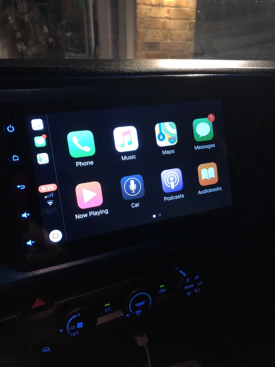

    Got my Carlinkit dongle in from Amazon today, works flawlessly so far. I think I’ll be about out put the dongle in line between the oem cable and the cable coming off the HU so it’ll be hidden behind the dash and I’ll just have to plug in a regular iPhone cable into the oem USB port on the dash
    Also can’t wait to use the new iOS 13 CarPlay with it, the dashboard view is going to be great

    I put my dongle behind the radio. There's a hole to the right side that you can route the lighting cable thru the passenger side and under the center console.

    So you didn’t connect the dongle to the oem usb on the dash and instead connected it to one of the other 2 usb the HU came with?
  5. Aug 21, 2019 at 6:25 AM
    #105
    zi0n
    zi0n Well-Known Member
    Dec 1, 2017
    #237409
    104
    Leo
    Puerto Rico
    2018 Cement Tacoma DCSB
    Yes! works fine.
    I use my dash usb port for my usb drive.
